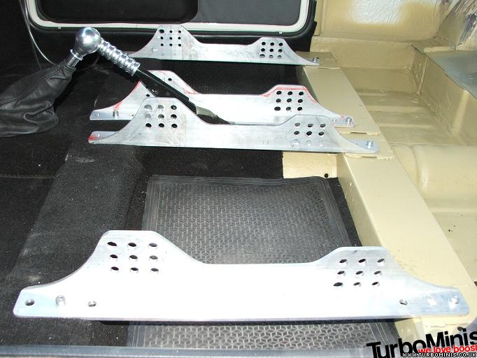

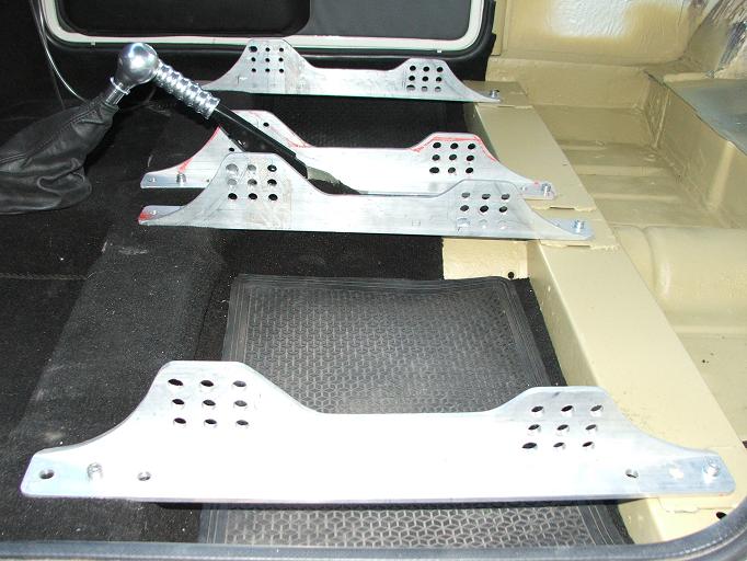

I made custom brackets for the seats. These were made from 6mm 50x100m aluminium angle. I dont need that many holes, but as I was unsure of a confortable position, it made it easy to find it. I will re make them with only a few holes for slight adjustment :)
I find that the seat is WAY to high in the car if you fit the brackets on the cross member(s).
I just bolted mine to the floor, obviously with some Proper FIA brackets.
On 19th Jan, 2010 wil_h said:
m8 to meet FIA-regulations.

M8 12.9s mate, if they are good enough to hold the seat to the brackets they are good enough to hold the brackets to the floor:)
With those brackets I made, the seat at iots lowest adjustment, sits down inbetween the cross members, and the front lip of the seat is almost touching the cross member, no pint going lower than that *wink*
Whats with all the un nescisary negative comments today *oh well*
They're not negative, they're helpful. If you want to sit like an old granny go ahead *wink*

I prefer to have the seat high, but if you do track days etc you don't want your crash helmet hitting the roof especially if something happens.
