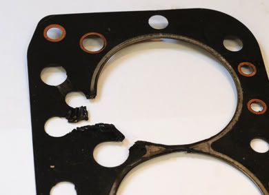

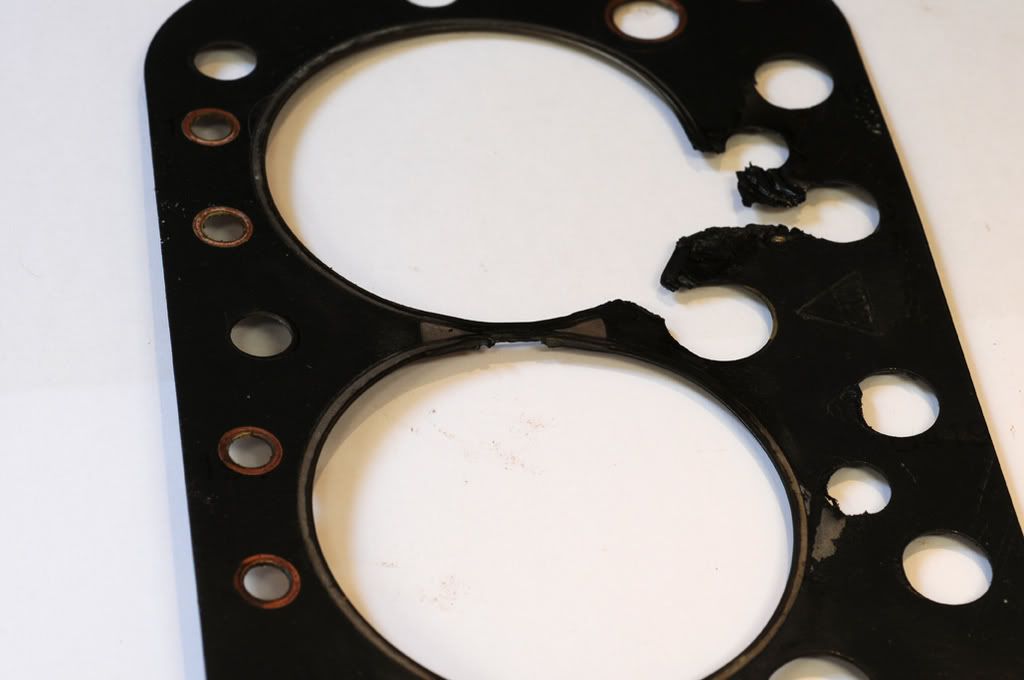

Ok lads I had a head gasket fail on one of my race engines I would very much appreciate you opinion as to why this gasket failed the spec of the engine is N/A 1380cc running 13.8:1 static compression ratio with 310 deg cam the engine is a 5 port with Mega jolt and runing top spec race fule 110 octane. the engine came straight from dyno and completed 15 mins of race time befour complete failure in a spectacular fashion,

I would say thats detonation

id say pre-ignition they way its blasted right thro the gasket, had a similar mode of failure when i shot for some very silly boost, cylinder temperatures rose massively but the pistons remained undamaged. usually wiht detonation there is signs of errotion on teh pistons jstu above teh 1st ring. assumign this is a race engien with strong pistons and a sloppy fit in the bore, pre-ignition is unlikely to melt them or make them expand enough to sieze in teh bore, next weakest link is the gasket.
what im getting at is somehting started the burn reall early so there was alot of presure in the cylinder for a long time, leading to masive heat and pressure buildup blowing it out, glowing sparkplugs, or simply to high a dynamic CR.

Thanks lads We pulled the pistons and striped the head no signs of any det apart from the Gasket My taught is I may go for a Bi Metal gasket with FSR rings It looks like the motor is runing just fine we have had this on the rolling road at full load for over 1 min at 7000 rpm with no signs of det we are only runing 21 deg total advance and that is 5 deg back from full power which was reched at 26 deg when we droped the ignition back to 21 we lost a small amount of power but back to 21 and we where on the money at 130hp from this 1380. the only posable reason we have found for this failure is that the Bk450 seems to over hand the 73.5mm bore by a small amount has any else noticed this on the builds or had I an falty gasket,

....the only posable reason we have found for this failure is that the Bk450 seems to over hand the 73.5mm bore by a small amount has any else noticed this on the builds or had I an falty gasket,...
I'm building 1360 (73.0mm) and the BK450 is VERY close to the bores uncompressed and that is with offset bores that I specified the offset specifically to match the gasket.
Photos here
http://www.turbominis.co.uk/forums/index.php?p=vt&tid=234047
There will be manufacturing tolerances on these gaskets too.

there are indeed manufacturing tolerances, I checked the distance between 2-3 on 4 or 5 of these (all new) and it varied with 0.8 mm!
Use an AF460 instead *wink*

detonation caused by..... too high a compression and too much advance mixture incorrect .............
heater take off would help ! ...... but the above applies firstley!!!!
