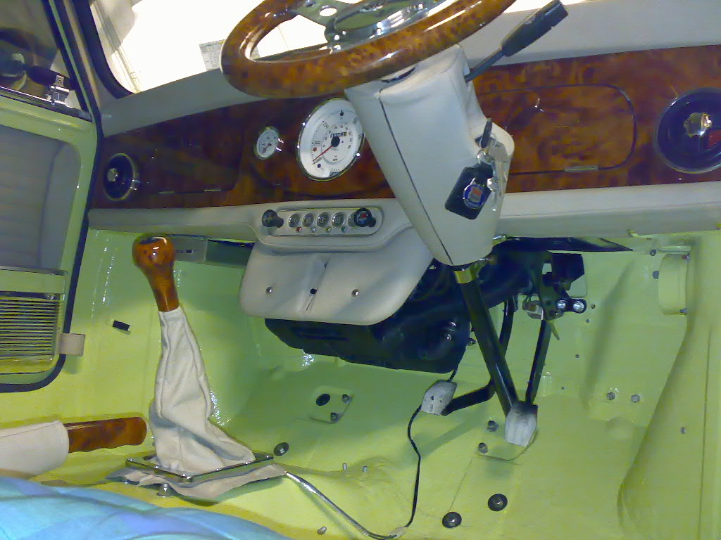

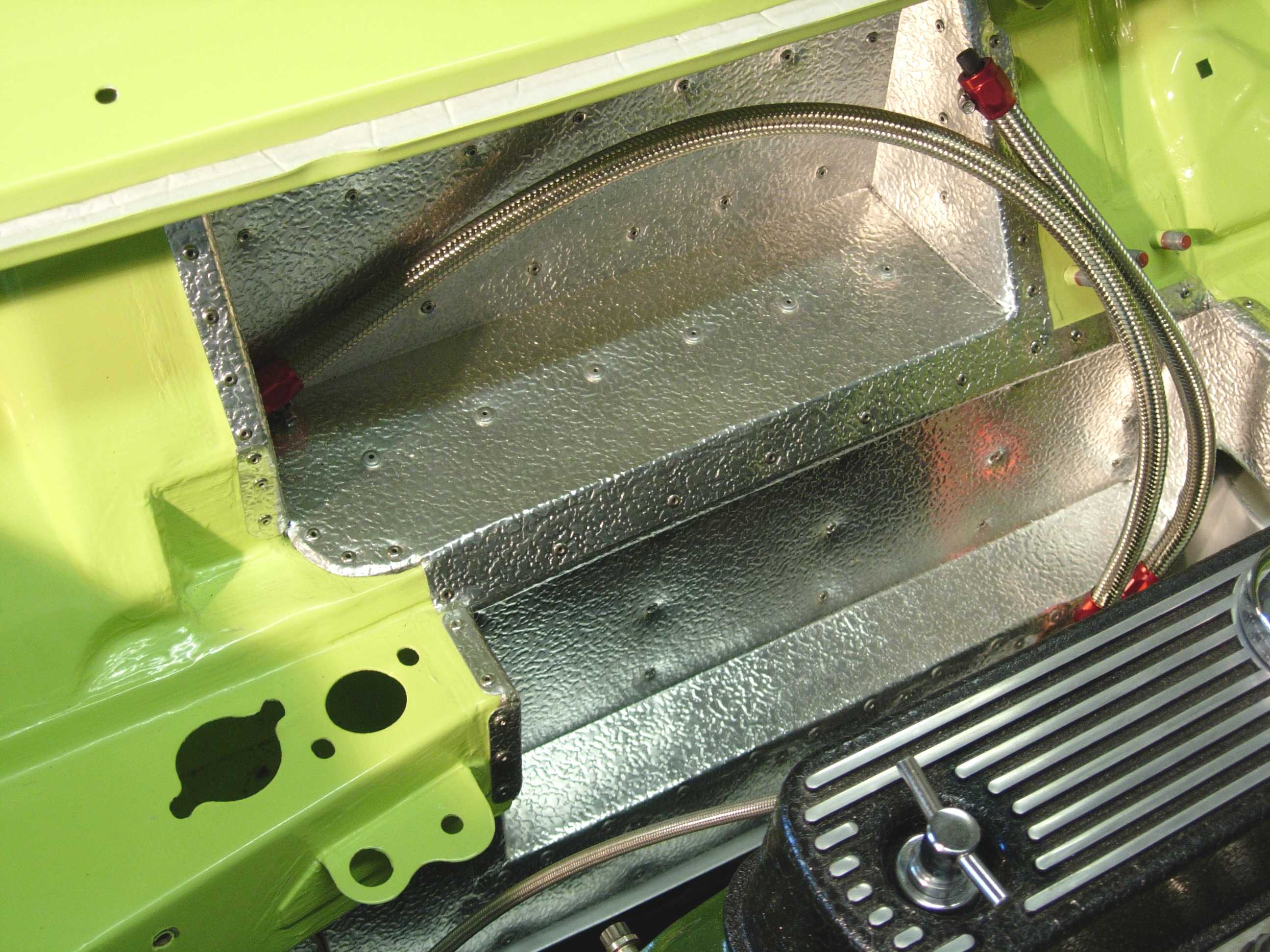

If they're still of use, I've attached an engine bay shot and an interior shot of the heater to show you my set up mid build (about Dec 05).
The engine bay boxes are i) a lengthened Avonbar Turbo box (lengthened by approx 2 & 1/2 ins so that the T3 actuator has more clearance) and ii) a DIT Weber air box to give me more room around the plenum.
The eng bay shot shows the boxes (which are welded in by the way) then lagged over the top with self adhesive 1/4 in thk gas turbine heat blanket then topped off with a piop rivetted rippled ali sheet bought from B&Q.
The interior shot shows a Mk 1 heater fitted on heater brackets cut from the original footwell area and repositioned on the back of the new Avonbar Turbo Box.
If you use the Mk 1 heater with its vertical slider, it wont stick out into the interior.
It is possible to fit the centre binnacle dash but in the limited space left, its unlikely you could fit a CD etc.
