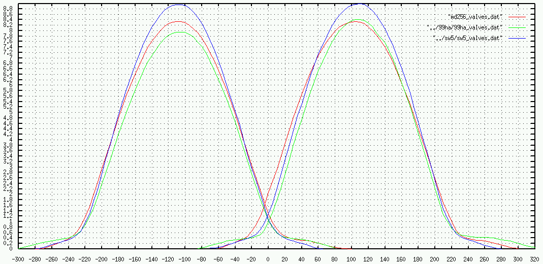

Paul: your approximations (from the thread you pointed) look very different from the real profiles I measured.
The take-off area is usually very grinder dependent and very different from basic Sin/Cos shapes. Just by looking at this zone one can say if cams are well designed. Of course the rest is important as well, but radical asymmetric-ramp square-shaped cams are rare (Schrick does them for Porsche)

There is not enough overlap (it's still useful on turbo engines, I think the turbine acts like a vacuum pump), and most important the intake phase is too short. There are more lift, but it's not well tunned to rev above 6000RPM (short intake). On track this makes difference. For pure street car it's certainly not important.
9mm lift is like on SW5. Swiftune sell SW5 with a special set of springs, I have it on my 998, they are harder than std springs (I measured). I think 8mm lift is better because you can keep std springs so have less losses.
69/25 exhaust looks huge. "69" may be better to get a high efficiency street engine (even if I'm not convinced Miller cycle is worth of effort on so poorly designed heads), but in this case I don't see interested in having "25" closing retard, this is where resident gases may come back into the cylinder from exhaust.
MD266 has a good point: higher exhaust than intake lift. Unfortunately intake is not well located (I think) for a turbo application.
The best would be a mix of MD266 and 731.

alpa
520 Posts
Member #: 2093
Grenoble, France
I'm attaching the profiles because my Internet provider is putting me out.
I bought a used 731, I'll measure profiles.
Edited by alpa on 5th Jan, 2009.
