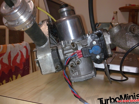

On 15th Jan, 2009 philc said:
tps all day mate. eurocarb sell them you may get them off ebay £65 around
There are a few pictures in my build thread and I've got a few more on either photobucket or putfile but the servers at work block all photo hosting websites incase we want to look a nauty pictures.
Here's a few pics, note I initially used an old scarp HIF 38 for mock up only to discover that the HIF 44 & HIF 38 casting have loads of subtle differences.
EDIT: Before anyone comments that you should you MAP with Forced induction the carb pictured below is for my clubby which will be running an Omex 500 which has both TPS & MAP inputs amongst others and the MJ in the picture was being modified for another TM member.
