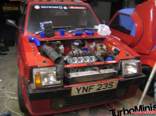

Well after a few weeks pottering away I'm getting closer to having the turbo 998 in.
Little fiddly things to do really, sort the oil retun, fit the fuelp pump (wiring and hoses etc.), finish fitting the IC, make the exhaust return blah, blah..........

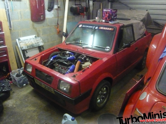

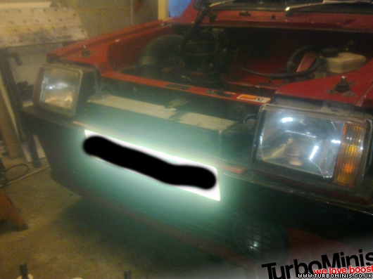

This is where the IC fits.
plate covered up as it was a massive reflection, should use a propper camera rather than my phone.

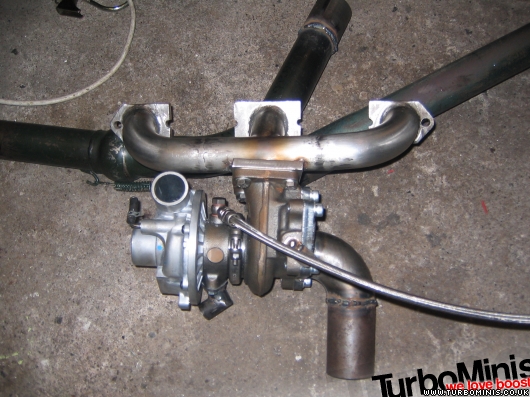

That a homebrew manifold Wil?

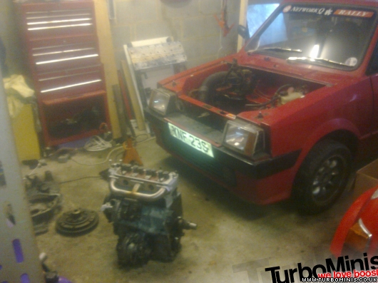

what sort of power are you looking for in this?
I didn't realise that engine was going in this! :) What kind of power are you expecting with the new setup?

Manifold is an MBH (Matty Home Brew) with an IHI RHF4 on it.
I'm looking for 110 to 120 bhp.
It's a Sabre Sprint http://www.turbominis.co.uk/forums/index.php?p=vt&tid=330422
Well progress is a bit slow, things keep holding me up, but if all now goes to plan should be started before the weekend.

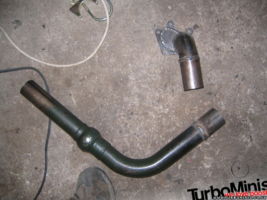

The manifold is a Matty special for the IHI, and I made the downpipe.

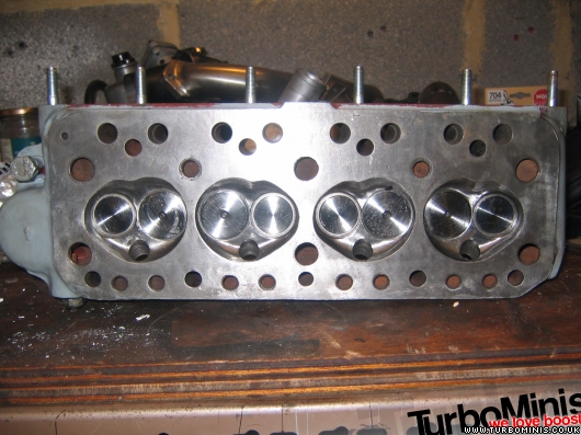

Head is Benross special.

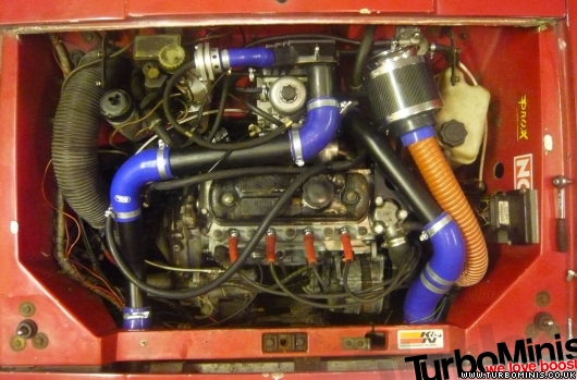

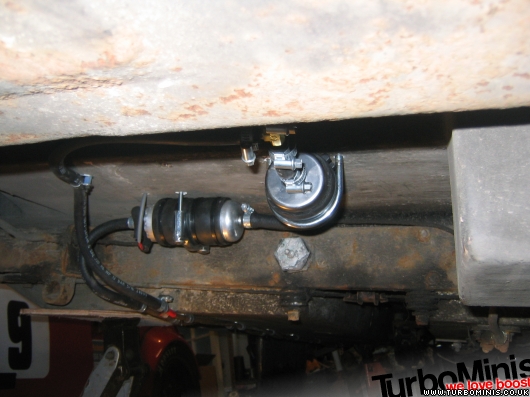

Is the fuel pump held on with a main bearing cap?

Pump is held on with the other end of the exhaust clam that's holding the filter on.
Ahh! that makes a lot more sense than using a main bearing cap.
Well it's finished and runs, just a few snagging issues such as a water leak, and the RTS clutch needs work. Then I'll get the wide band on and go for a drive.

Thats a nice compact turbocharger *happy*
It's not made any boost yet!!
