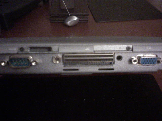

what set ups are you using with your megajolts cable and computer wise

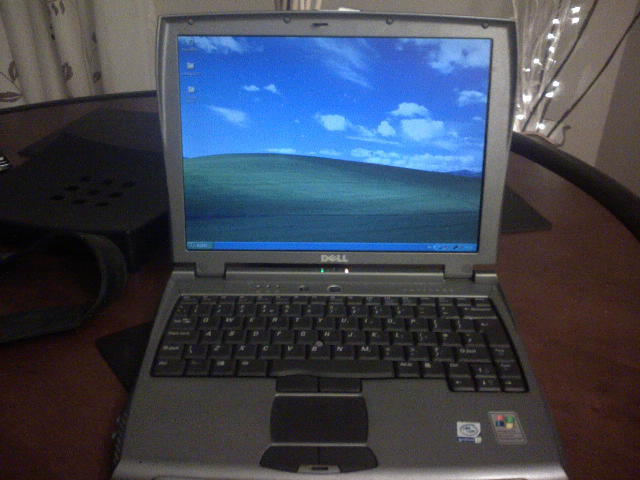

i am trying to get a laptop similar to this as it already has the port ready so i wont have to have the whole hit and mis with usb convertors
(am i right in thinking the photo shows the port on the left is fine for the jolt cable)
The port on the left is 9 pin serial so should work for the MJ.
