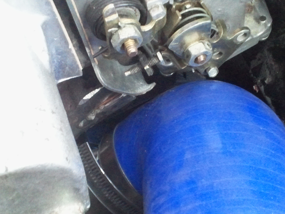

yes genuine samco, note the 'adjustment' on the aubment plate no matter how much you fettle something gets missed lol
Looks alright to me Bertt!

thatll be fine, however, if you get some thin stainless/aluminuim (cat heat shield of a scrap car *wink*) and fold it over and tuck a bit under that jubilee clip you will have a heat shield, just incase :)
Denis O'Brien.
yeah see what you mean, and i will do that

That will be fine mines been running that close for about 6 years with the same hose no bother :)
