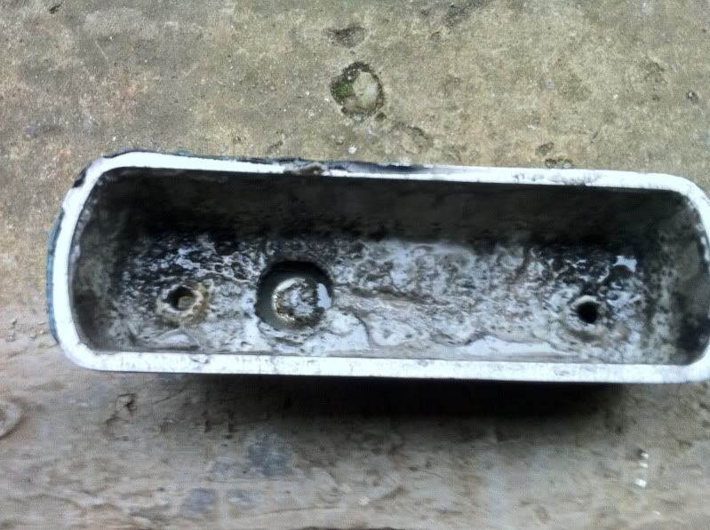

guess by the amount of cream oil that the head gasket has gone, thing is the car isnt driving like it has a blown head gasket

attachment didnt work but here's the picture
not sure but depnding on how often you use the car, it could be due to condensation as well; I'd do a compression test. Are you using water?
What oil are you using?
as rob says, you need to be using water tbh
what breather system do you have?
if the car is not using water this is a classic DUCKHAMS Q oil problem,
this oil is not suited to the A series engine
also as the guys say above

not losing water, car only does about 12 miles 5-6 days a week, i'm using the halfords classic car oil probably not the best, as for breathers have one on the timing case and one on the clutch cover
That Halfords classic stuff is shit.
It will be a combination of that and no using the car very often.

any suggestions for better oil to use theoneeyedlizard as will be doing an oil change on it this week
If this is a turbocharged engine, steer clear of halfords. It's not really up to the job. I use it in my n/a 1275 and its fine though.
If i recall correctly, most people recommend millers, but it isn't cheap. Someone will probably confirm this hopefully lol.
Millers CTV or if budgets are tight we use Comma Sonic in the upside down skip.
I use the Halfords semi-synthetic 15w40, been using it for years, I do 10k a year in my turbo 998, never had a problem. Halfords oil is fine as long as you buy the decent stuff.
I use the CTV in racer, but it's just too pricy for a daily.

I used Valvoline VR1 20/50 in the meccy. Never run it long enough to give an honest opinion though.

i use comma classic but it some times does the same
Done now needs redoing lol
doesn't matter what oil you put in it, 60miles a week is still the problem.

As Sprocket says but that Halfords stuff always gave me mayo in the rocker cover. Even when i was doing 60 miles a day.
1275 EFi Turbo
if you ar just using the car for short trips this is compounding the problem, with the oil.
up the thermostat to a 88c one for winter and flush the engine and change the filter and us a better oil like the chaps above says

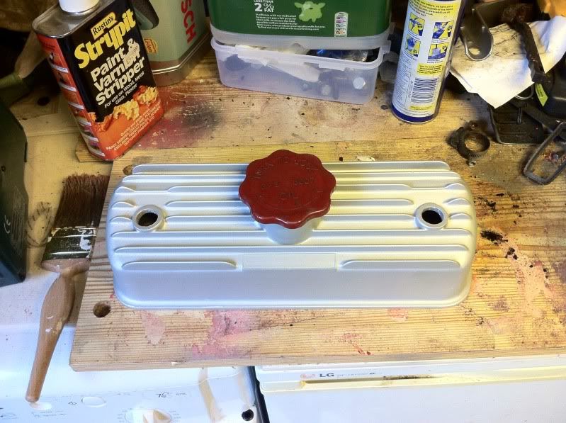

cheers for the feedback guys, will let you know how it goes as the engines in bits at the moment (took the turbo out to sort engine steady and oil feed pipe, not a job i ever want to do again!!) just refurbished a rocker cover i got off ebay to replace the old one, i think its come up pretty well
yes it has .....10 out of 10
is that just stripped or painted aswell?
