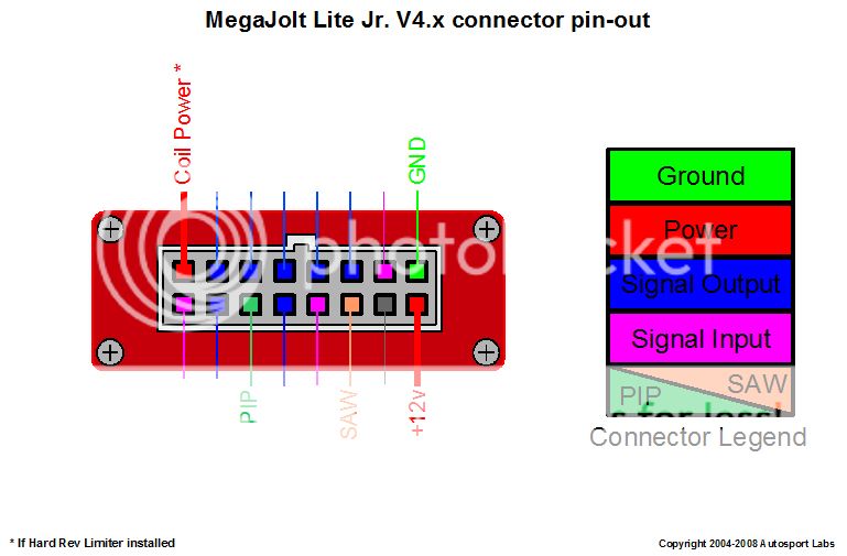

So today i made a start on wiring in the megajolt. All went well except for some confusion with how to wire in the hard cut rev limiter.
What i know is that with the hard cut limiter, the coil takes it's power from the ecu. It has two wire's that go to the edis module and the third is coil power.
Now do you connect the coil power to the 'coil power' on the molex plug or to the 'rev limit' point on the molex plug? Or is it a case of pairing the coil power and rev limit together and then connecting the two to the remaining wire on the coil?

have a search dude i had trouble its all in that thread.
save you some time as im feeling nice :)
http://www.turbominis.co.uk/forums/index.php?p=vt&tid=460039
coil + to coil
rev limit plug is if it is external so not needed and coil gets is power now from the MJ

I was of the understanding that, just connect the four wires in the box and it'll work?

Edit: Sorry the way i've read your post is that you take power to the coil from the rev limit out put on the molex. Rather than the coil power out put?

have a read of what i say again mate, as thats not what i said.

I have hard cut rev limiter
I wired the coil the to the "Coil Power"
I used those connections on my plug, only difference was I used user output 1 after editing this diagram.
