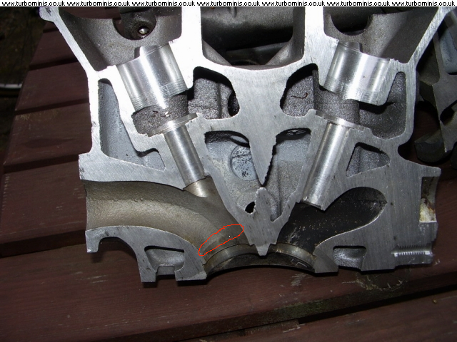

Ive noticed in the inlet ports there are some rigdes in the inside bend of the port. I can't imagine it is there by accident, so is it wise to remove them?
It looks like it would push the air towards the centre of the chamber more, but at the same time I imagine this would cause a low preassure spot on the outer part of the valve and maybe restricting the flow a little? *oh well*

The ridges you talk of, might have a functional purpose, I wouldn't remove them before probing a virgin head on the flow bench to see what's going on in that area

what grooves?
can you identify them on the pics here?
http://www.turbominis.co.uk/forums/index.php?p=vt&tid=184839
You can see on the top pic, on the inlet port it goes from cast finish to smooth and there is a ridge just before the valve.
It doesn;t look much on there, but it is quite a ridge when you look down the port.

A bit crude bit is it this section matty?
yep thats the one, cheers Dan.
I would just make it smoother at the top and leave it, i did a light porting on my 8v k nothing major just cleaning up and smoothing the bumps on the start of the inlet tract
ah now I see what you mean. In my opinion, that needs some work, but the flow bench will tell you exactly whats going on in that area, and what needs doing. It might be doing nothing at the moment if there is flow seperation before it on that short side turn.
Its just the machine finishing of the valve throat and nothing intentional

is just where the boring out for the valve seat meats the casting, clean it up,and knife edge the divider,

yeap as Carl and Colin say, give it a gentle smooth, theres opertunity to remove some of the guide boss in the exhausts, but the biggest gains are probably in the seat geometry, but you need to do that with machinery...
