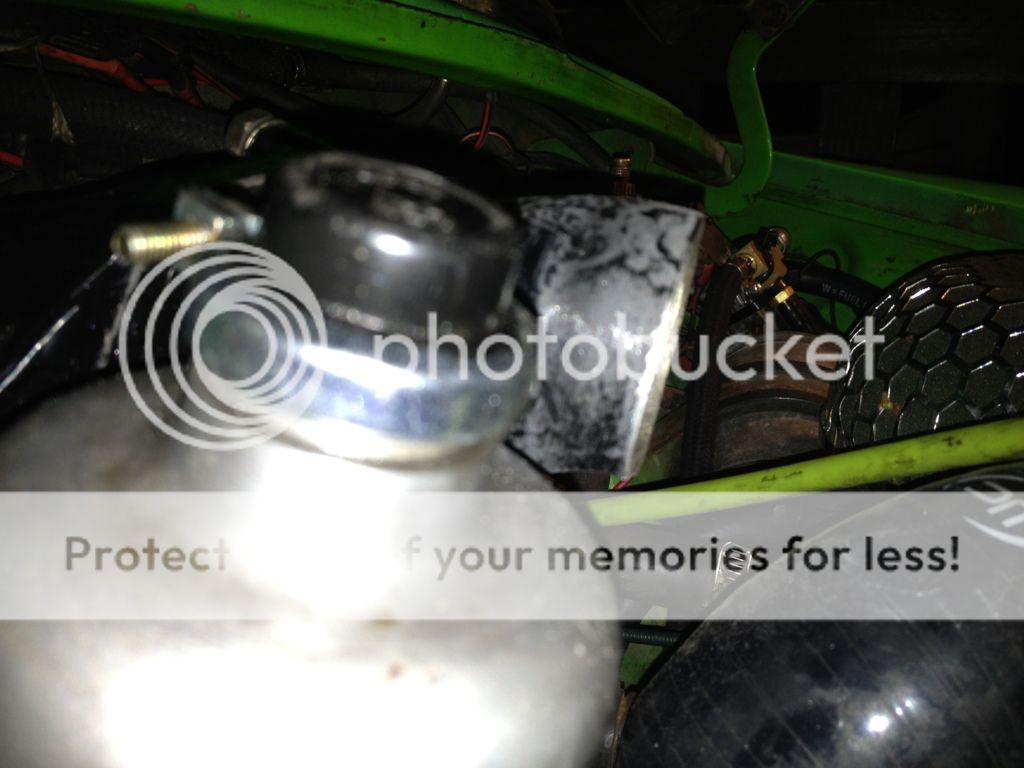

Think the problem lies in the plenum trumpet i have, ill upload a piccy, its cut right back and im only really managing to clamp on the taperd part hence why it gets worse and worse as i think its sliding off the trumpet, thus leaking more and more, if i wiggle it like mad it eventually pops off no matter how tight i do up the jubilee or mikalor.

Mines the same and its fine at 25psi

Thing is tho when i re clamp it it runs nice for a bit then slowly comes back, repeat the process the same happens.

Ideally, you need someone to run a bead of weld around to make a retaining lip, but if you put three self tappers in around the edge and then clamp the hose behind their heads I would be very surprised if it came off again.
