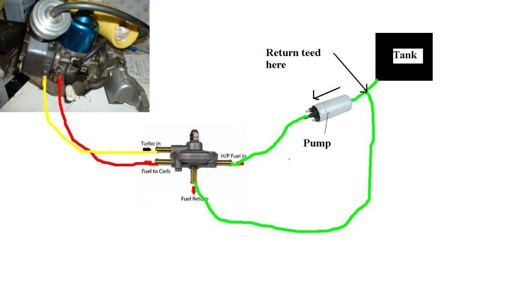

I'm pretty sure they are not the wrong way around as I have taken it off and held and blocked the feed to see if it was correct

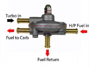

With the adjustment nut at the top there are two pipes out of the regulator directly above each other, bottom is fuel to the carb, top is the boost signal from the plenum On 18th Oct, 2013 apbellamy said:

With the adjustment nut at the top there are two pipes out of the regulator directly above each other, bottom is fuel to the carb, top is the boost signal from the plenum Yeah that's how it's set up although fuel is coming through thr return is this correct ? |

On 14th Mar, 2013 oli79 said:
What he said^^^^ About time I used paint for good instead of evil, connected like this? ![]() Yea that's how I've plumbed it in thanks for the diagram though |
