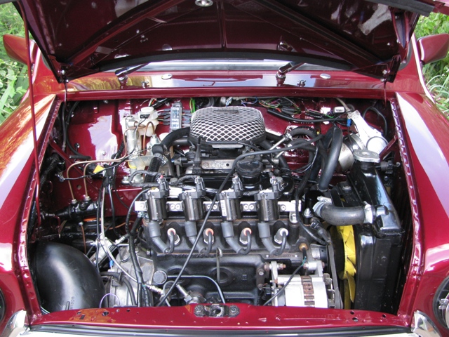

Finally got the engine running on the restored Mini 30. Fitted a Mpi manifold to get it on the road.
Running MS3X in fully sequential mode. Hall sensors on crank and cam and LS coils. Twin widebands to monitor AFRs on inner and outer cylinders.
The engine has been built for turbo use but decided best start NA.

Looks really good, is there a build thread for the engine? will be interesting to see the results as well
There is a build thread "budget 998" should find it.
I just realised that the OP suggests that we were having problems getting it running. That was not the case. It was just a matter of getting the motivation to make some progress.
Yesterday we managed to get oil pressure... easy enough if the new loom had not had a disconnected link for an inhibit switch hidden behind the heater :(
This morning we saw synch on the ECU after a slight mod to the hall sensor input.
Checked the fuel pump for operation, fuses in the coils, check the accuracy of the spark then fuses in the injectors and tried to fire it up.
Didn't fire straight up but kicked back a bit. After reducing the cranking advance a tad, off it went :)

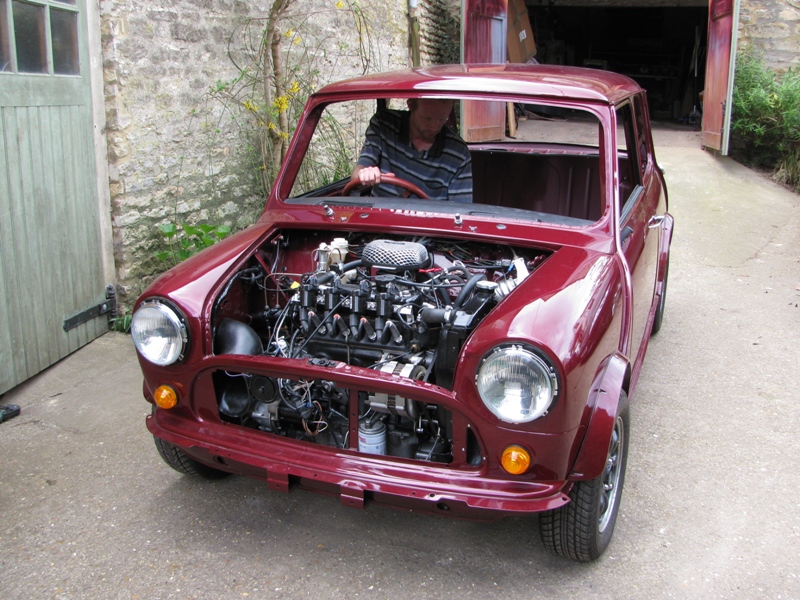

We sorted out the TPS problem.... broken connection.
The car has been mechanically complete for a while now. Axel drove it in and out the garage at the weekend.
We waited until the weather improved before fitting the headlining and now the interior is going in.
Should be going for an MOT in a few weeks :)
It will be good to have a running mini again. It may provide the motivation to finish the other two.
