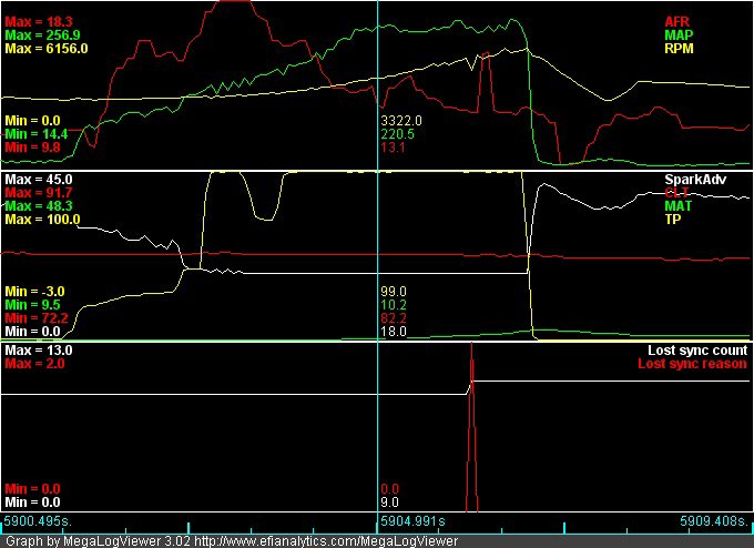

does it look anything like this in the data logs?
if it does mine turned out to me vibration in the alternator belt and it was slapping the vr sensor
