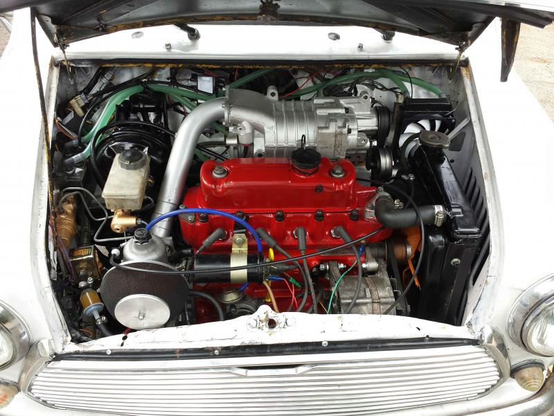

Hello all,
I have recently spent a great deal of time, effort and money on a new engine and supercharger kit from Vmaxscart. Engine is originally a 1275 from a Metro. Car is LHD. Spec is as follows:
A+ Block bored to 1293
Head skimmed, rebuilt with fresh parts
Vmaxscart EVO140 kit with water cooled manifold
ARP studs and bolts
HIF44 with Vmaxscart supplied needle
Standard Metro electronic distributor
Omega +20 forged pistons 18CC
Standard connecting rods
Swiftune SW5 camshaft
Swiftune duplex timing kit
New turbo oil pump
No decompression plate (not required according to Stuart)
Maniflow manifold
RC40 exhaust
Guessworks rebuilt gearbox
X-pin differential
2.76:1 FD
Standard helical gearset
Economy primary and input drop gears (0.9333:1)
Minispares 2 core radiator
88 degree thermostat
Facet fast road solid state pump (SS502, 4-5.5 PSI)
Valvoline VR1 racing 20W50 oil
Car is intended to be as modern and quite as possible mainly for highways, thus using these gear ratios and camshaft etc. This is also why it is supercharged, soundproof has electric windows etc. Meant to be a daily car with extra puff.
As it stands I have a couple of issues with the car:
1. It overheats when idle and under load. I believe this is due to the old 8 lb rad cap it has that I will be replacing soon with a 15 lb type. Also it hasn't been tuned on a rolling road yet so obviously timing and fueling are out.
2. Supercharger pully and belt contact the clutch master cylinder under light or more acceleration. This I will be solving by fitting an engine steady that attaches to the water pump bolts instead of the thermostat housing (had to be removed due to the supercharger).
Also I will be fitting a Filter King fuel pressure regulator for the Facet pump (I understand current pump pressure is excessive) as well as a mechanical oil temp gauge that reads from the sump plug to see if oil temp is causing overheating.
I'm considering fitting a Cinquecento front mounted radiator. Not because of the cooling issues, but because it would cancel the mechanical fan lowering noise levels even further. Obviously this would aid cooling as well.
I have read on the forums that forced induction requires different ignition properties than on naturally aspirated engines and that fuel injection improves pretty much every aspect of the engine.
Right now the engine feels weak when comparing to its performance before the project, Maybe 80 HP. It also feels "cammy" in low RPM and idles erratically, which is completely against the point of the camshaft I have chosen and the purpose of the car. I have checked the cam timing and it's spot on.
I know this is due to ignition and fueling, which is what I'm trying to solve.
Unfortunately where I live (Israel) there are 2 rolling roads and both I believe know nothing about carburetors and distributors, so going fuel injection seems like a logical step forward.
