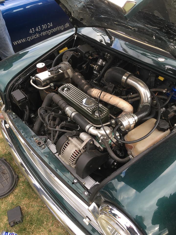

Hi, here are a few videos of my MPI Turbo ( GT1752), DTA S40 PRO ecu, 2.76 FD a bit high :)

nice car. looks like the tallll final drive is killing the revs though. I had this in my 1275 turbo, 13 inch rims, 2.9 final drive. Good head, Sw5, it just wouldn't rev past 5k without the need for gear change

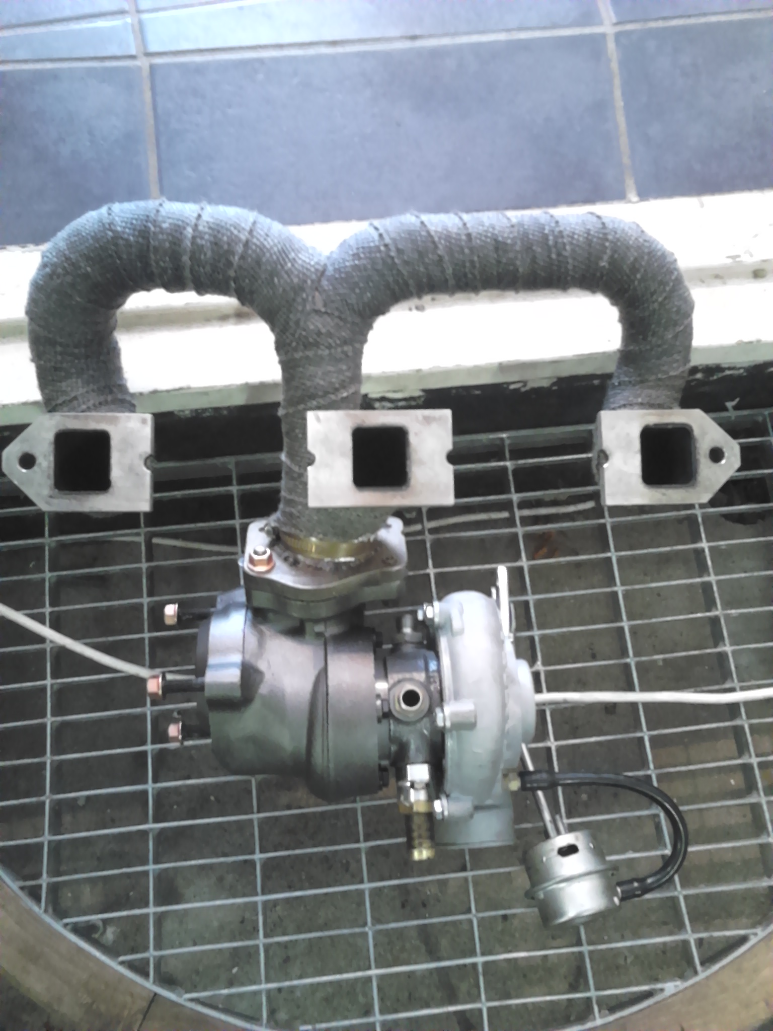

Interesting exhaust manifold.

Yes it`s a different style manifold, but it was the easiest way to make room for the MPI inlet manifold :)..

What ECU and injectors are you using? Are you recording any AFR readings?
Edit: sorry missed this bit "DTA S40 PRO ecu"
Do you vary the injector timing with rpm and map?

SCB manifold!

Hi, at 10 PSi 120 bhp on 5000 rpm and 176nm at 4000 rpm :)..

1293, Omega 10cc pistons, full ported head (stock valves though), PH2 cam, duplex timing gear, center main strap, MED oil pump, cometic head gasket, ARP head studs, 1.5 old-school rockers, fully rebuilt gearbox with x-pin diff 3.1fd, MED heavy duty clutch cover, etc etc....

Would be really interested to see how you've plumbed in an intercooler, I'm struggling for room!

Don`t have an intercooler on yet :( - that`s why were running at 10-12 psi.
The car came from the rollers on Tuesday last week, and Thursday morning were went to IMM 875 km away - first drive this season and it ran perfectly :)

Very nice. What injectors are you using? the standard ones? are you measuring the AFR and where?

The injectors are 840ml OEM Siemens Injectors (quite big - but i had them), AFR are taken in the bottom of the downpipe right before the flex piece.

Do you have any anti charge robbing strategy or you are just injecting the regular way?

Hi, sorry for the late response,
i don`t really know, what my friend has done at the rollers, i suspect that it injects the regular way, but i will have to check.
I`ll be back with this.
