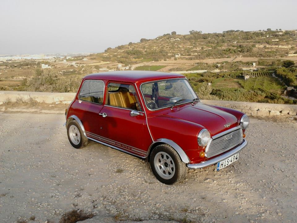

By the way, this is my Mini in its current state *wink*
