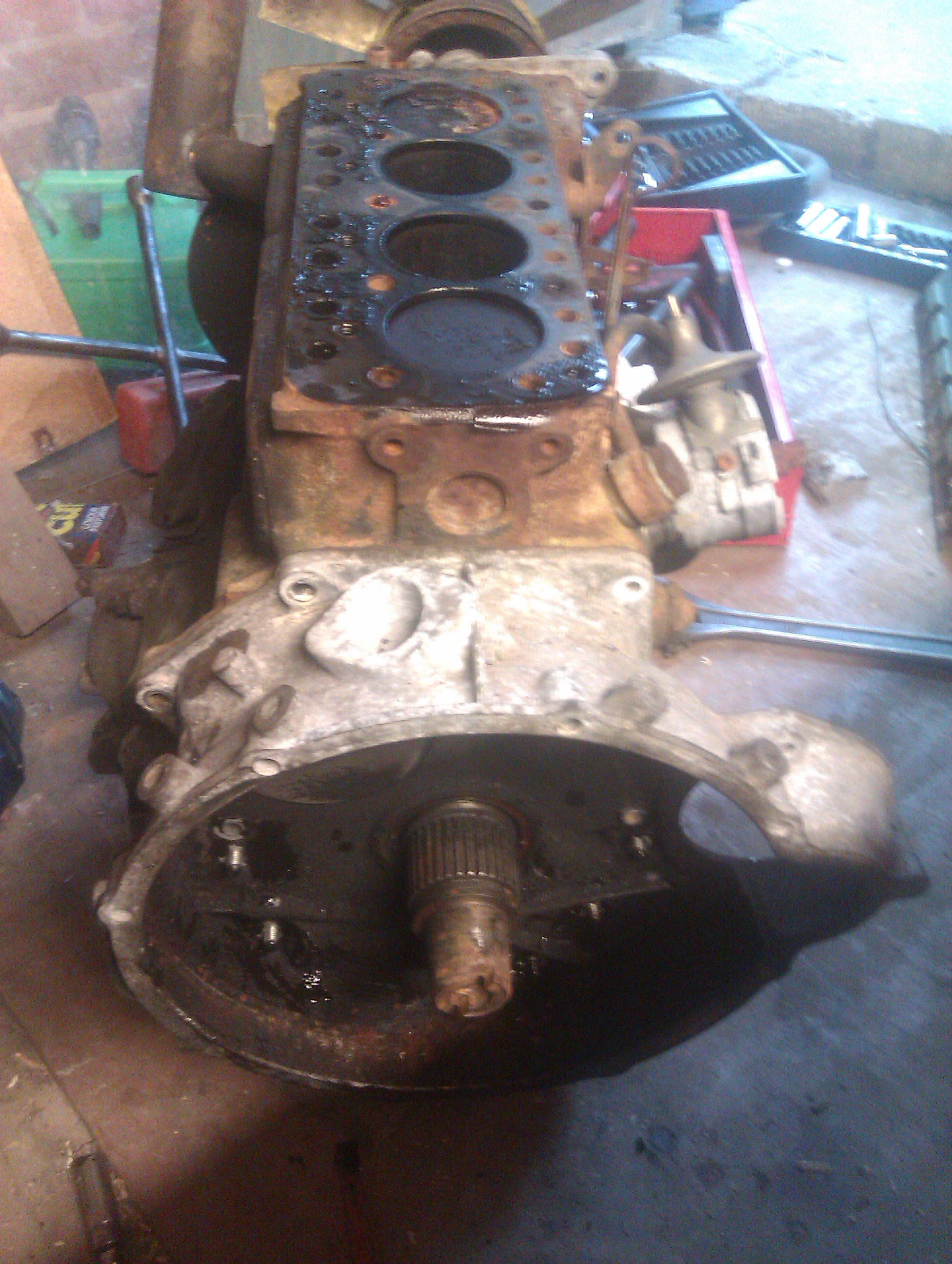

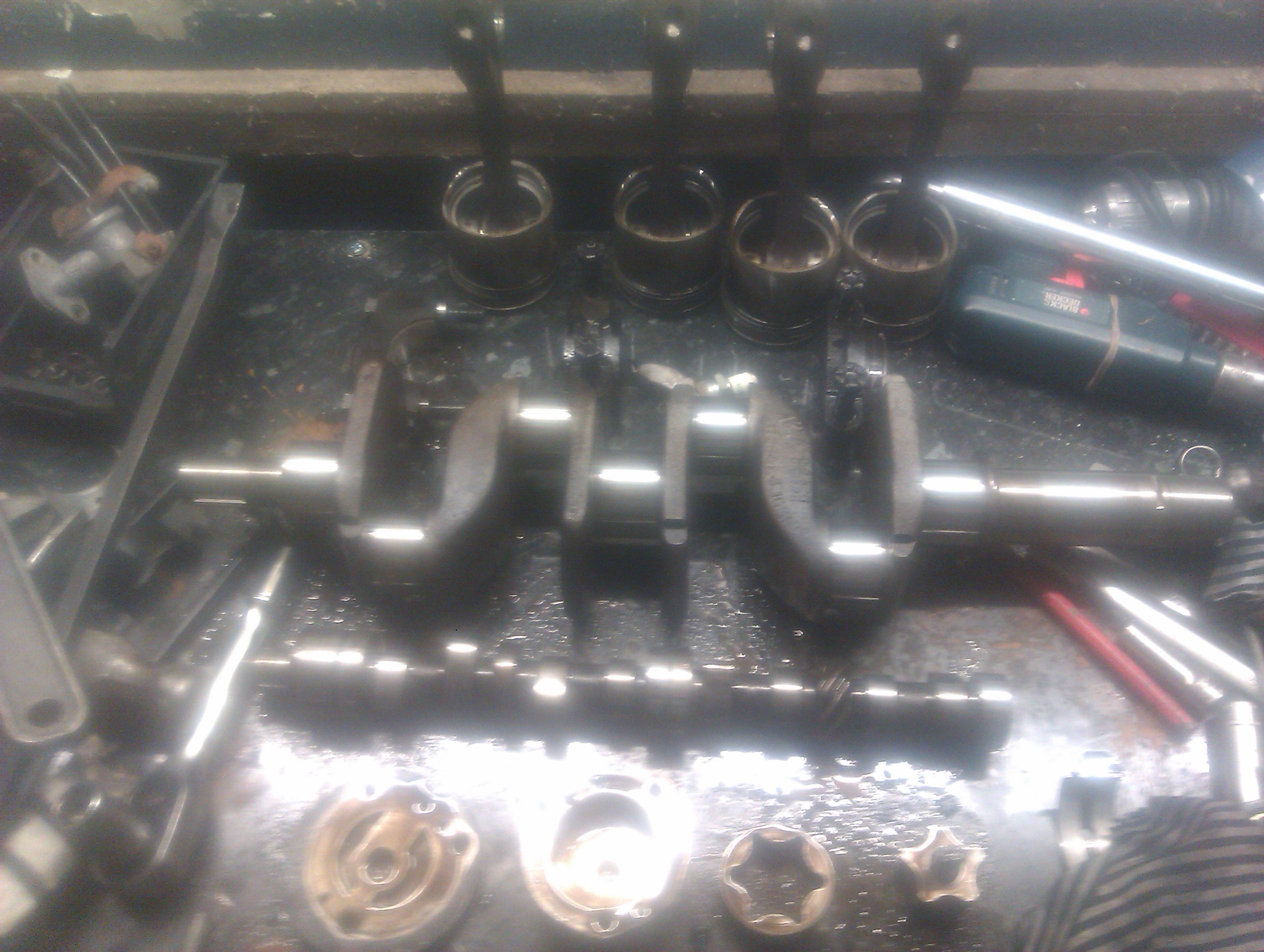

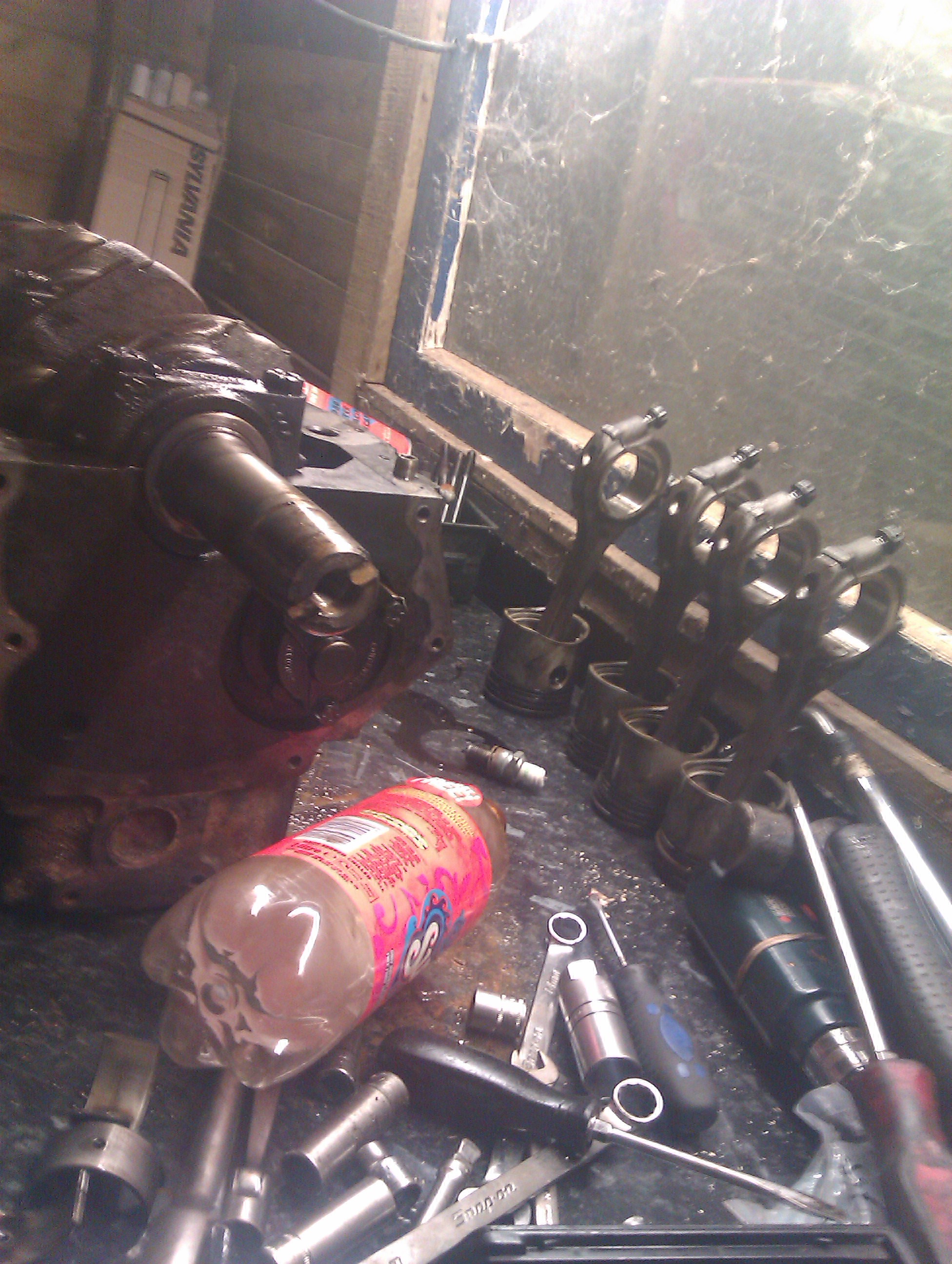

Right then some progress or should i say a start has been made! I stripped the engine down tonight afterwork. Was loads of funn and only took a few hours. the block Is being sent for machining on Saturday :)
I also went minispares last saturday and bought new cam bearings, a duplex adjustable vernier timing gears and chain which look sexy lol, cam triangle plate thing and a few other bits and bobs.
The one thing i can't decide is what colour to paint the engine other than the usual red. I was thinking blue, or purple, or even 998 yellow *tongue*
