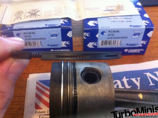

Now you have me thinking...
Diameter and thickness look correct, as per dims on box,
I picked these up about 5 years ago before leaving the uk,
Only thing is that the oil ring is a different design ?? any ideas, or may be just an improvement over the years?
I'm taking the block into the machine shop to get some work done for fitting squirters, so can get them to measure up, I guess the other thing would be to use one of the rings positioned at different points down the bore and measure the ring gap? I can at least do this at the top and middle to see if there is lip / step
Edited by Brocky on 4th Nov, 2012.
the oil ring is the problem. Apparently they are 'deeper' than the groove in the piston, therefore will not compress up enough to fit in the bore.
Like I said, fit them to the piston and confirm one way or the other.

Cleaned up the piston and took off the rings,
Average depth of oil ring groove looks to be 3.35mm - 3.50mm
Average width of new oil ring section looks to be 3.6mm - 3.7mm
I guess this is what you where talking about, must had missed that thread originally and just assumed that replacement rings would be exactly that....bit pissed that I didn't pick up on it sooner, but will be giving Total seal a call today, so not a total loss.
The more I think about it the more I am thinking deglaze bores and new rings, since they are avalible here, but will get the bores measured up for sure.
Good job you said really as I wouldnt have though to check, and would have popped on the ring clamp and tapped away....

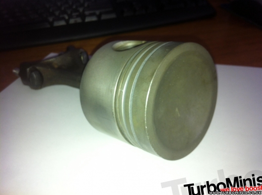

Pistons have cleaned up remarkably well,
They rotate very freely on the pin but there is no rock from up and down or side to side, and there is zero sign of any det, well at least on no. 1, no.3 still has 0.5mm of carbon on it lol, but suspect will be good under neath,
Note the mark on the edge of the crown is a stain which will sand off easily
