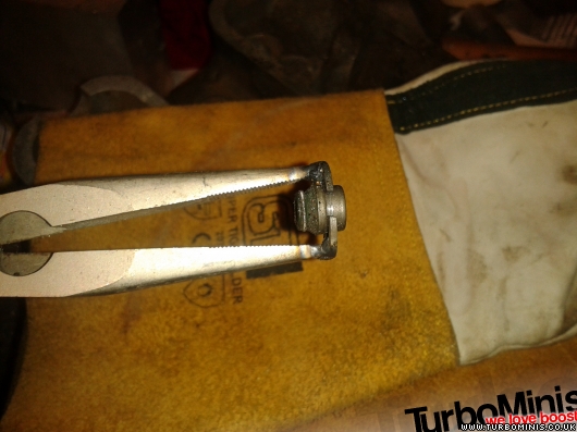

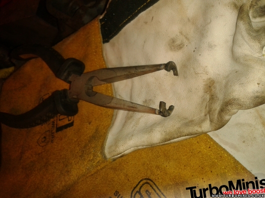

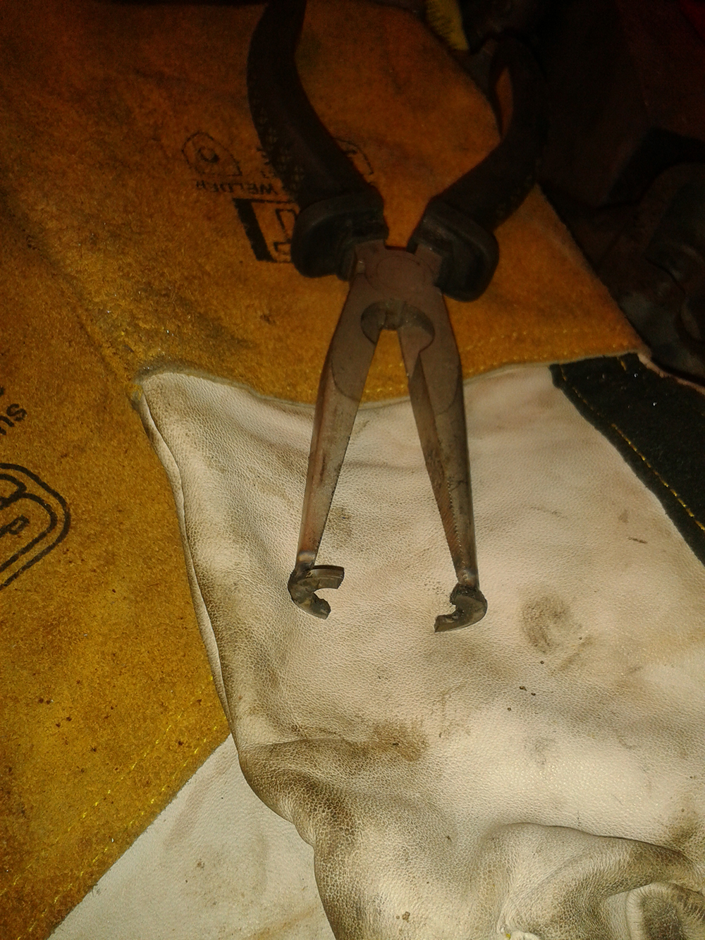

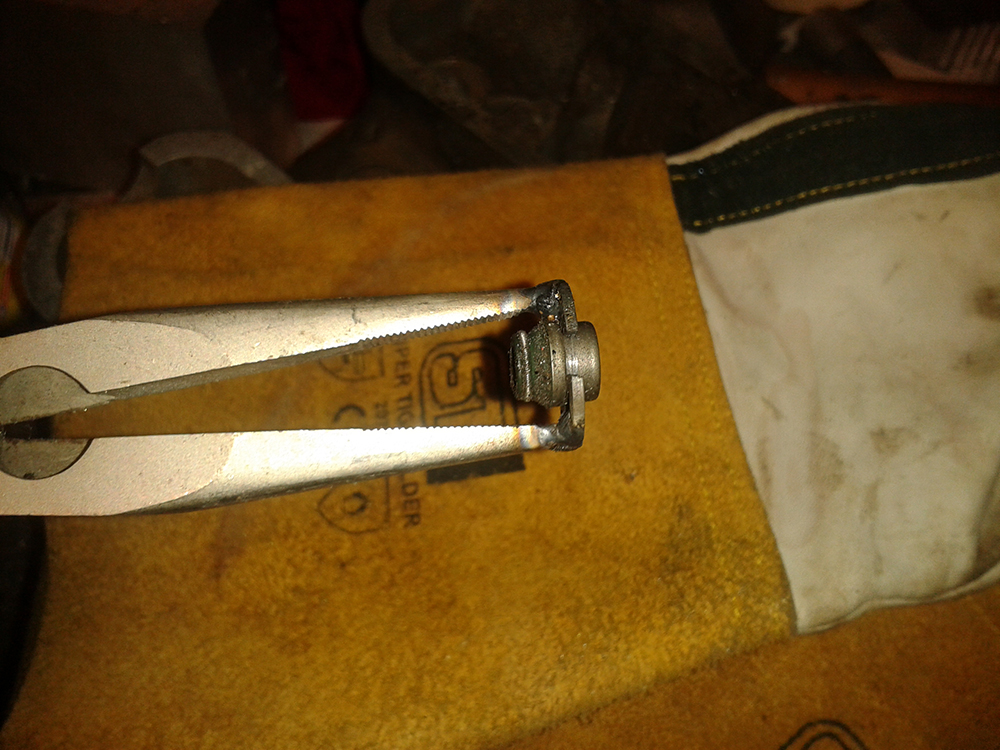

Ive been keeping myself busy rebuild my short engine, and modifying my cylinder head.
I made these this evening as I can't keep forking out £50 on guide seals everytime I take my head apart...they do the job nicely! *happy*

Handy looking tool that will save some cash

pretty good tool there.
