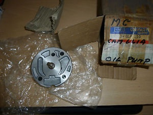

I'm not sure I have photos of the front of the evolution pump, but back on page 5 are photo's of the back. The ports certainly look a fair bit different to the swift tune pump.

Well, to drag this back up, i was surfing ebay and came across an add for an old-stock turbo pump. Not convinced however the cast looks a little like the powerflow pump with some variations. The ports look close to our previous findings too
