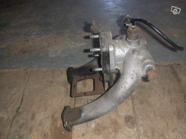

Does this devellopement gives a new understanding of that :
Edited by Advantage on 17th Feb, 2011.
Rusty by nature
It does indeed. Particularly as they used it in a heavy car that needed more low down torque.
Not sure you could use it in a Mini without the dashpot through the bonnet.
Maestro/Montego manifold?
Could be interesting to try this out with it all sticking out the bonnet! *smiley*
yep
How far up would it stick? Should be easy enough to lift the bonnet up a bit on the hinges
carb goes over the top of the engine so pretty high i would imagine
