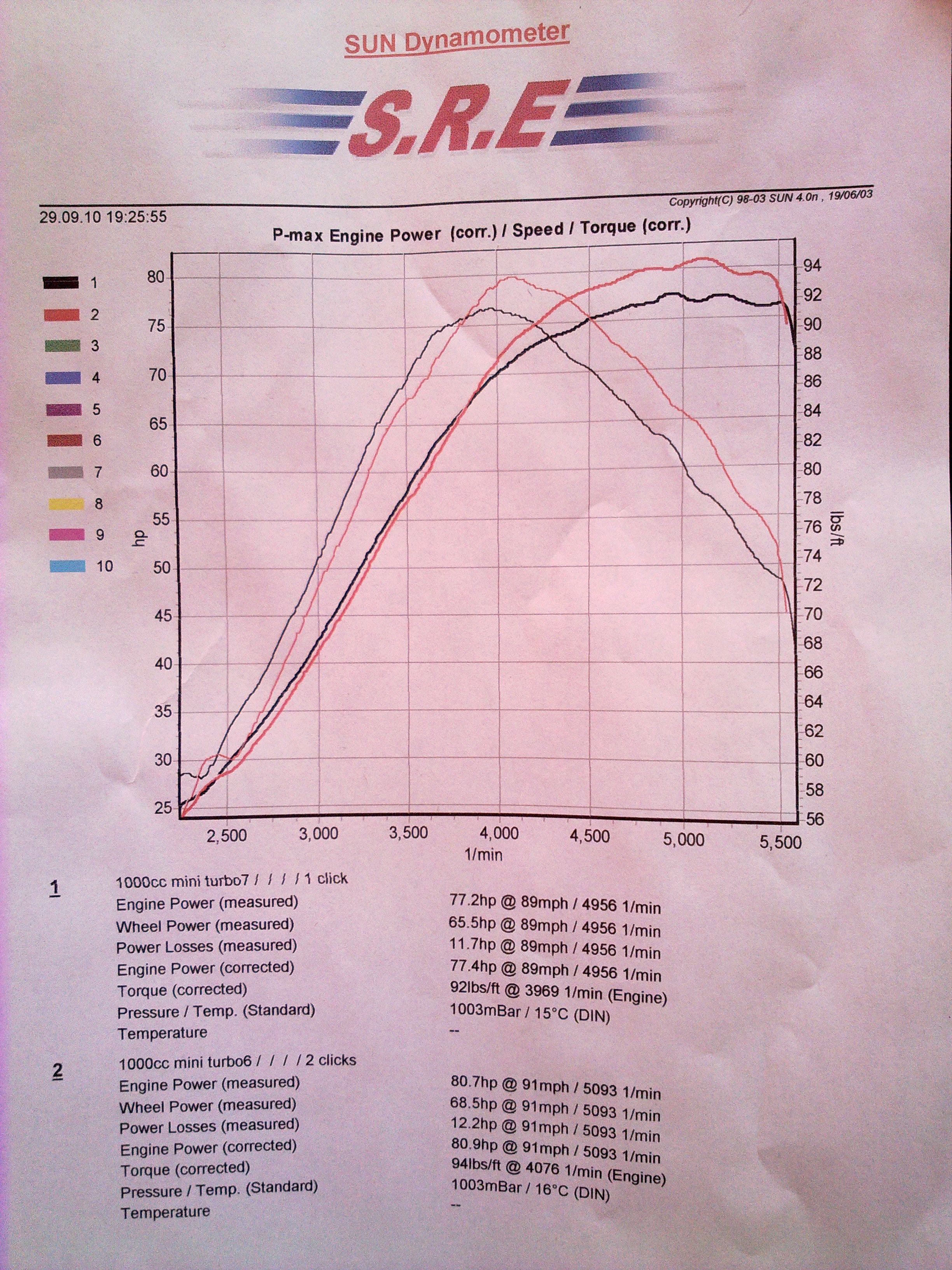

Went to Slark Race Engineering in Amesbury yesterday to get set up on the rollers.
Firstly I'd like to say I'd recommend the guy (Neil). Friendly chap, very helpful and spent the whole day with me trying sort a niggling problem and fantastic price considering all his efforts. (I was there from 10am to 8pm!)
Before I left for the rollers I'd had some issues with the fuel shooting out the carb. Solved this by using a larger return pipe (had tried it with standard size) and unblocking the float vent to allow trapped air to escape.
However, once I'd stopped it shooting out the jet, it still dribbled out when I blanked of the float vent. (FYI I've converted a N/A maestro or montego carb) so left the pipe open to air and ran the car N/A because it just wouldn't come on boost. Anything close to atmospheric and it would be starved of fuel. I figured it was the needle being very far from required.
Got to Slark and we tried running with boost, nothing. Changed to a very very rich needle, nothing. Anyway, to cut a long story short and after all the head scratching.
Turns out the drilling from the plenum to the carb which pressurises the float chamber when above atmospheric was blanked off in my carb! Drilled it out and absolutely fine. Ran boost like it was born to.
Below is my print out. Happy with the results. I was aiming for 80 to 90 bhp. So just got my target.
