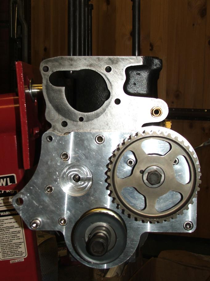

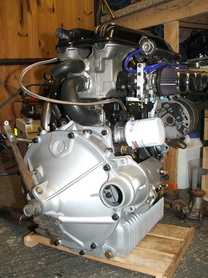

Yesterday I got the oil pump, jackshaft, front plate and timing pullies fitted.
And today -

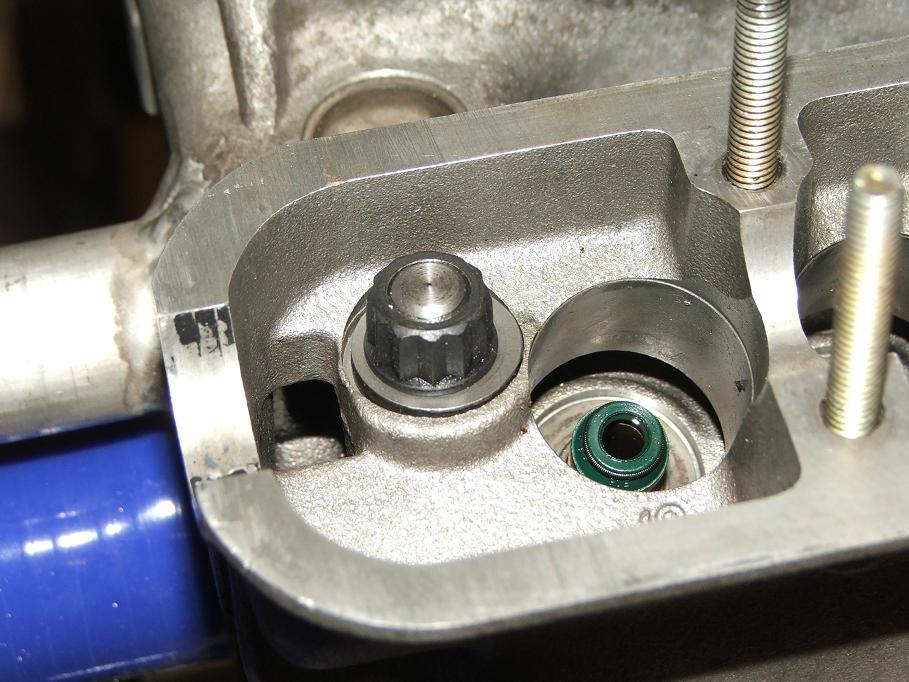

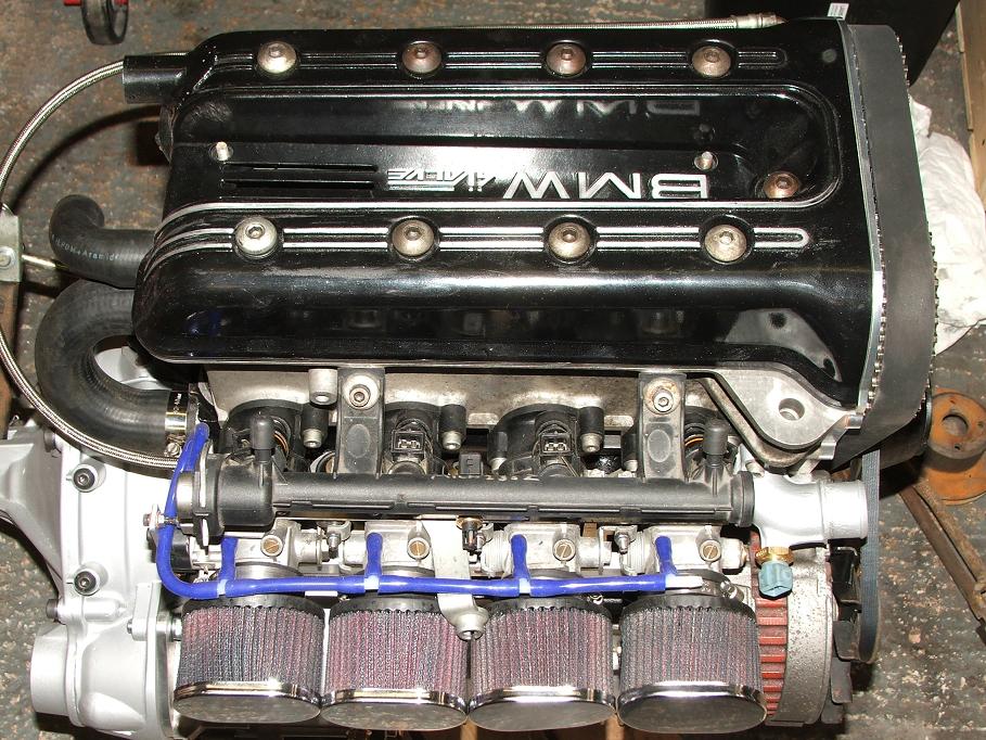

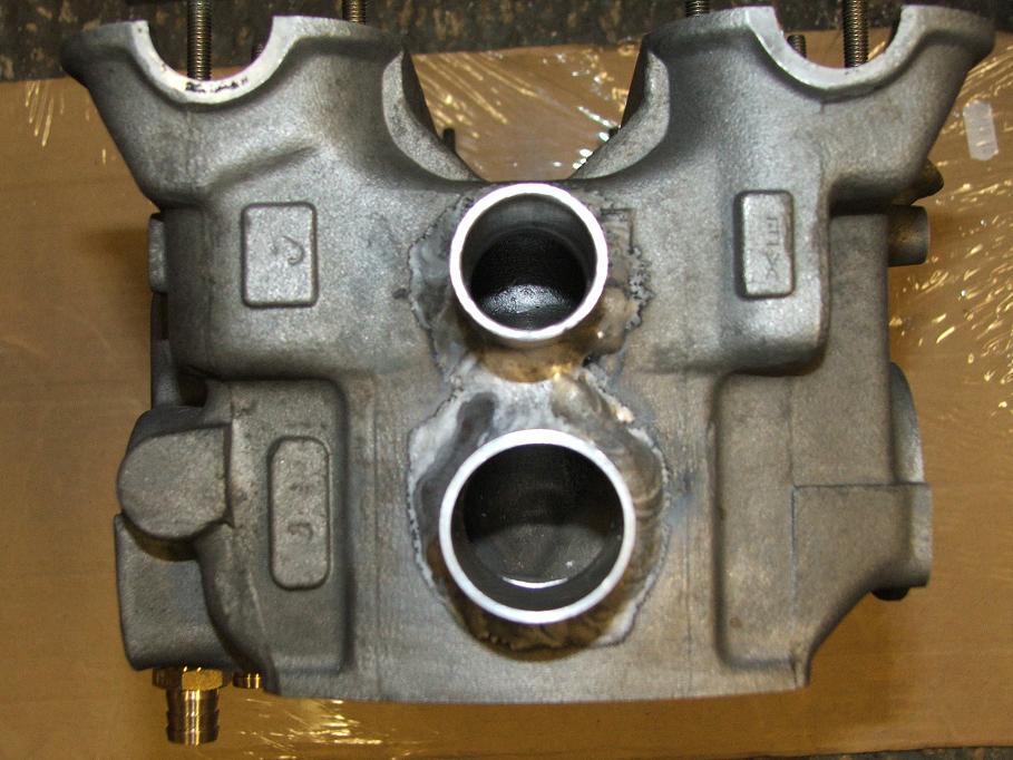

Yay, I am back in posesion of the head *happy*
Been busy tonight with other stuff but I couldnt resist placing the head on the block just to see how all my hoses line up *happy*
Everything is coming together exactly how I had planned it so far, well it should , I didnt spend three years doing nothing *tongue*

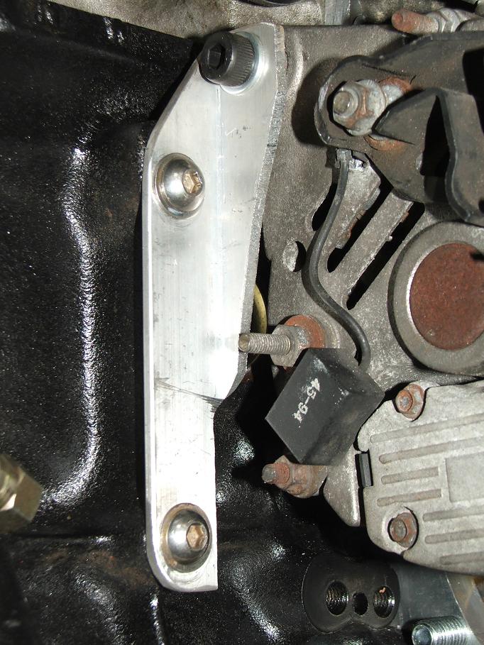

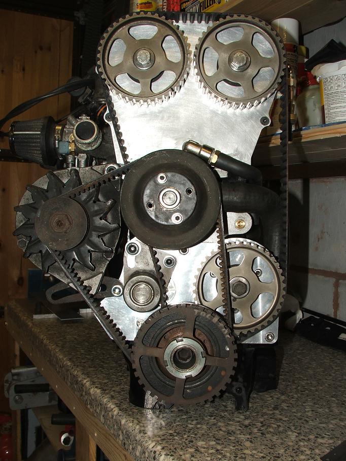

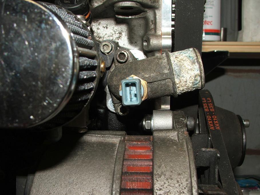

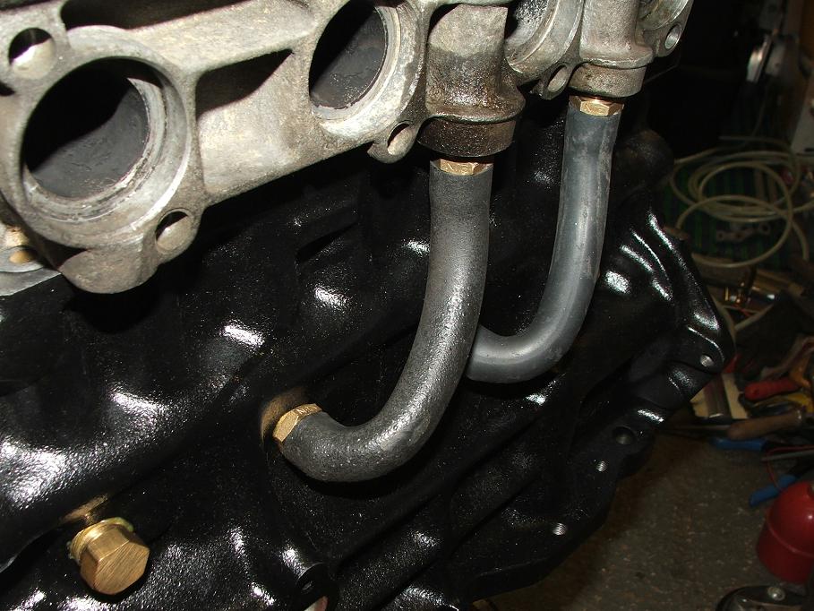

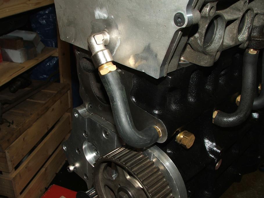

The MPi poses new problems when it comes to mounting an alternator. I made a bracket up, drilled and tapped the normaly redundant bosses on the block. I had to modify the bracket slightly so that the alternator wouldnt foul it. I need to get a slightly shorter belt for a 998 to bring the alternator as close to the engine as it will ever get, it touches the block with slight adjustment.

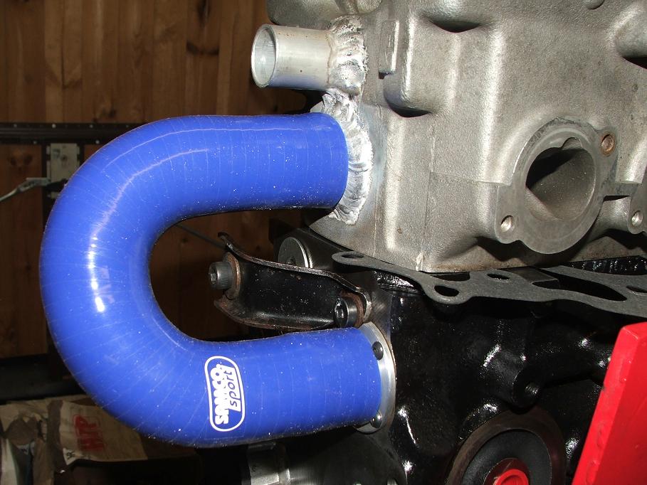

I made up an adapter to re orientate the coolant outlet. Drilled and tapped the outlet to take a standard CLT sensor.

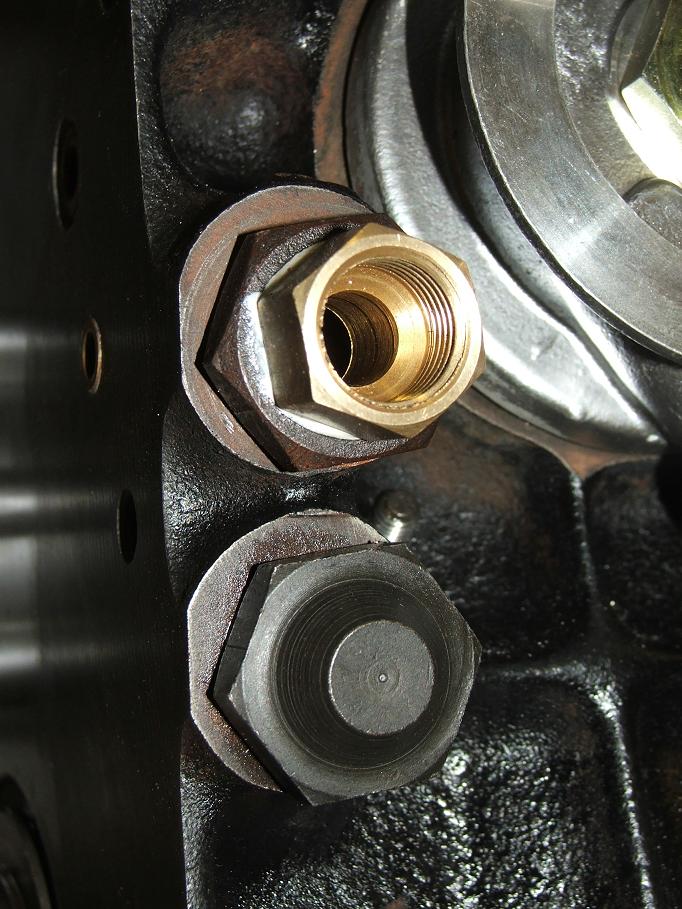

Modified an old oil relief back nut to accept a mechanical oil gauge. This nut is the same thread as the oil temp sensor fitted on MPi blocks - Bonus :)

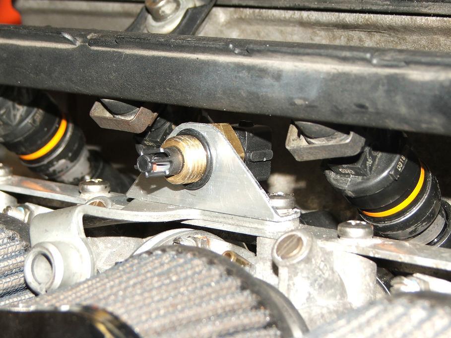

Made up a simple bracket to take the MAT sensor, mounted ontop of the TB's

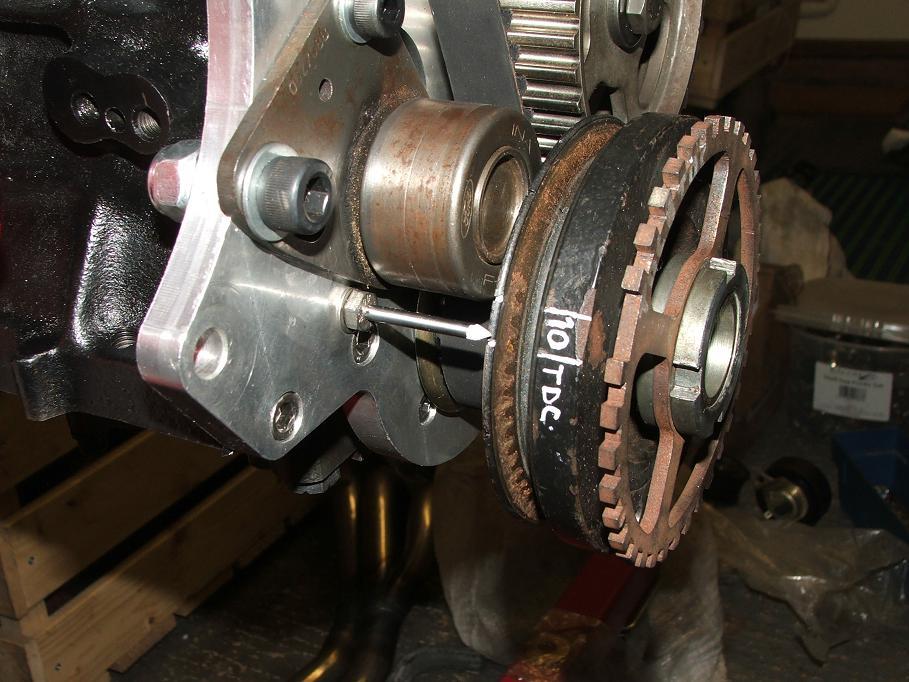

I made up a TDC pointer and marked up the pulley. The pointer is removable to make it easier to service stuff in the car *wink*

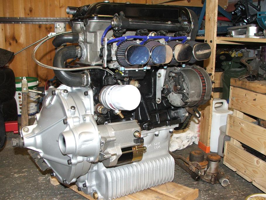

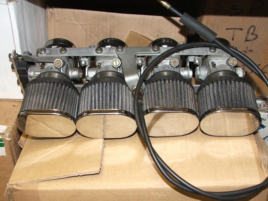

Looking good sprocket youl be there in no time those filter look a bit better than filter socks.
love that straight cut scream!!!

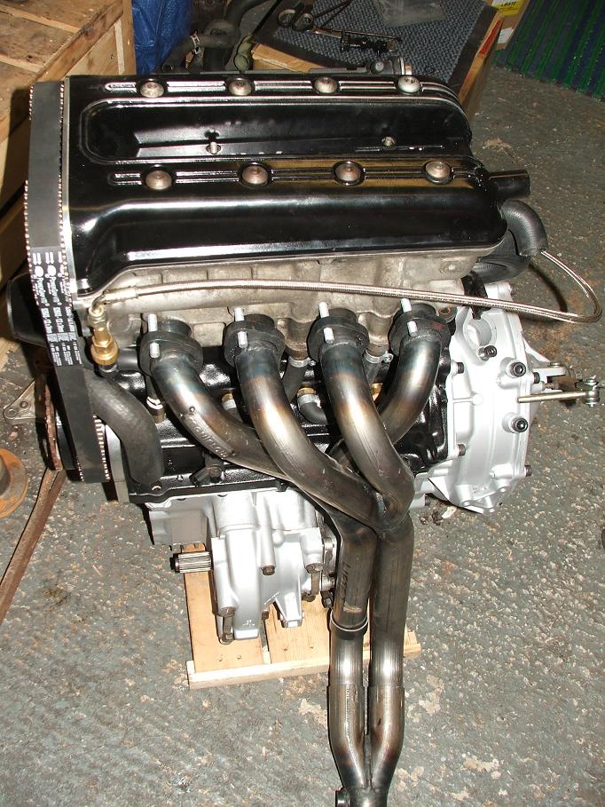

this is one hell of an install mate. keep it up.
when do you expect it to be running? Combe? *tongue*
Loads of stuff to do still, but looking at next week end to get this in the car, allowing the following week to plumb it in and wire it up *happy*

There are two un used bosses on the MPi block, not quite in the right place for an A+ alternator bracket. However, if you drill and tap them then fabricate a bracket, the problem of mounting an alternator goes away. Im not sure the MPi alternator would work in this manor, and the belt tentioner would have to be binned.

its amazing it looks like its a standard engine strait from the factory! good work :)

Needs a flywheel *tongue*
