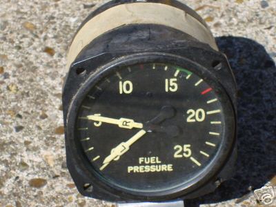

Back on topic, As no one seems certain as to the relationship between Boost pressure and Exhaust back pressure I thought of a simple way to find out.
I have just aquired the guage in the attached picture. It is a 0-25 psi dual needle jobbie.
If the inputs are boost and egbp it will be a doddle to see quickly and easily the relationship between the two.
The guage may be a little over damped but I cant be sure until it is tried.
I don't have a turbo motor running at present so I am offering a loan of the guage to anyone who would care to try it. All I want in return is some decent feedback of the results.
Anyone up for it in a reaonable time scale
Dave
cool gauge!
local milatary breakers?
danboy
715 Posts
Member #: 1381
it's a fuel pressure guage from a twin engined Dakota.
Dave
Edited by danboy on 29th Dec, 2007.
