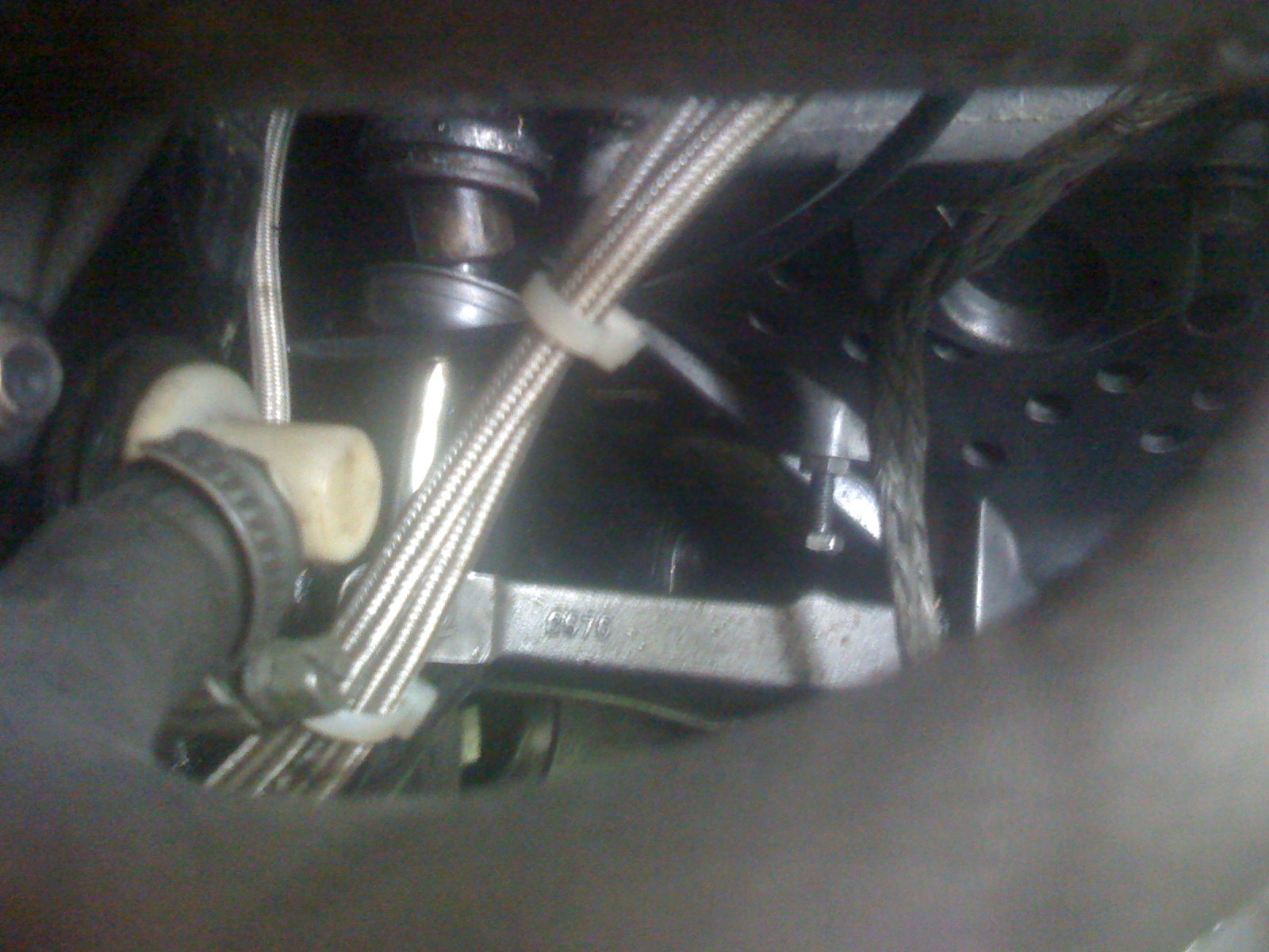

It seems that something in the clutch has collapsed, allowing the arm to throw so far out that the piston in the slave popped out, pissing all of the fluid onto the floor.

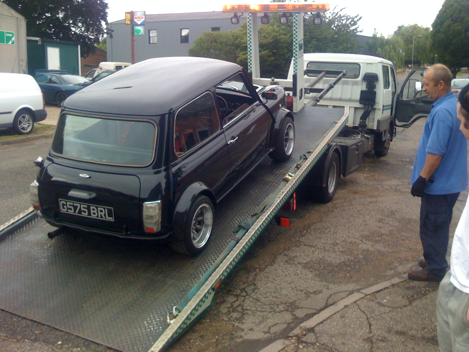

Luckily I opted for the recovery service as part of my insurance package, so I gave them a call and the nice lady at the other end of the phone said that a recovery lorry would be there within an hour.

Recovery lorry turns up, loads up my car, but as we are just ready to pull away the NS right type decides to let all of it's air out.

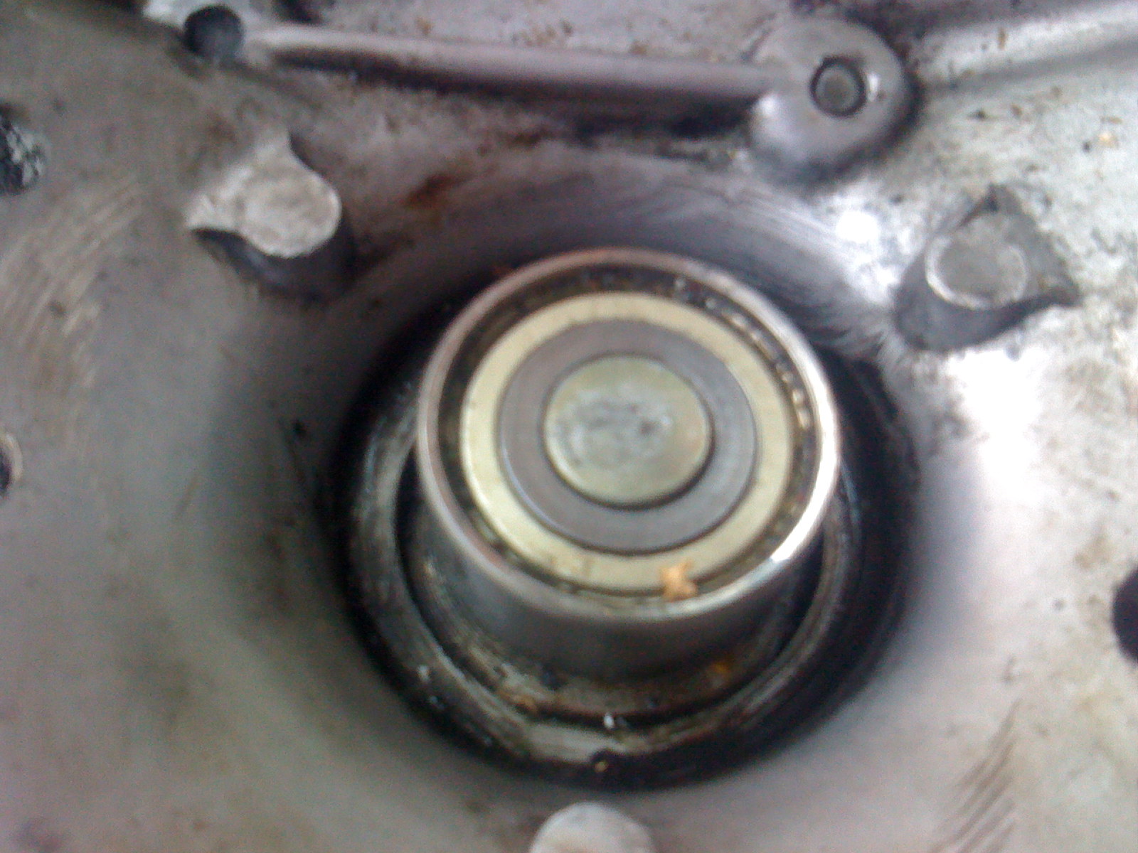

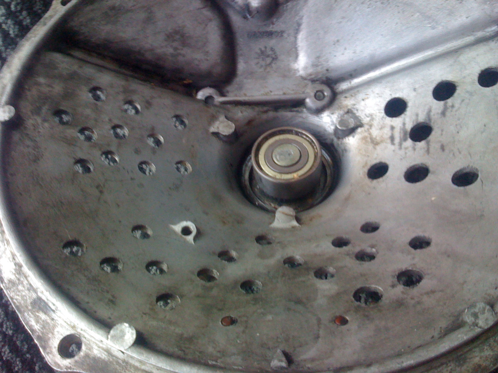

Right, the wok is off, the release bearing looks ok (to my untrained eyeballs).
Could it just need re-adjusting, or do you think that something has shat itself?

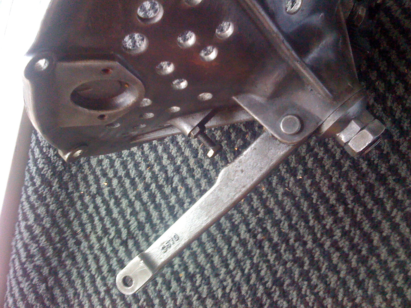

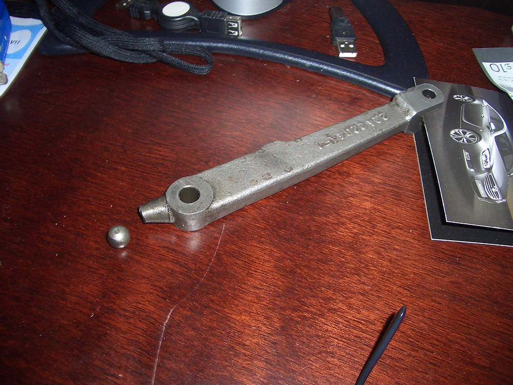

take the arm off the wok and check the ends not snapped or the bit where the ball off the arms sit isnt cracked/worn/broke.
Just spoke to Joe (mini13) and he suggested (as Carl did above) that the arm might be at fault.
And...
You are both correct.
Any one got a spare pre-verto arm?

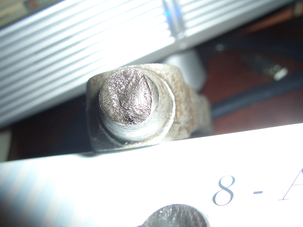

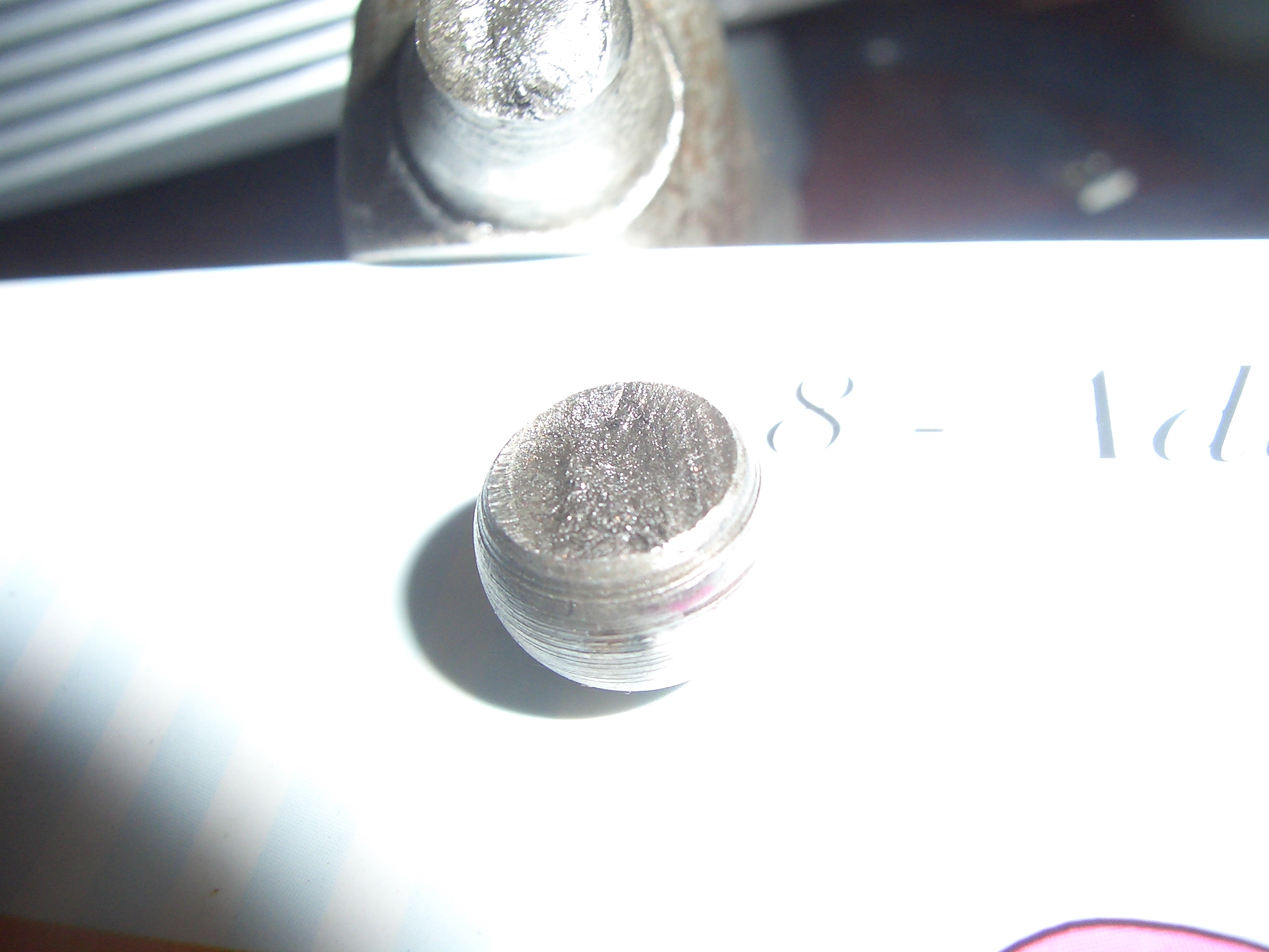

how about showing us a macro close up of the break, so we can figure out why it broke,.

not really that old only as old as the engine gary so couple of years and couple of thosand miles, tops, and it was a new one, should be a receipt in the stuff i gave you mate
I thought that was the case, but apparently the new ones are made of cheese.

The arm looks very roughly machined, looks like could it have cracked across one of the grooves?

It looks like the chinese have done aniother bad job of the heat treatment, [nothing new there] it is clearly hardened through ,making it brittle,
the origional rover BL ones would bend along the length of the ball end, but not snap.
