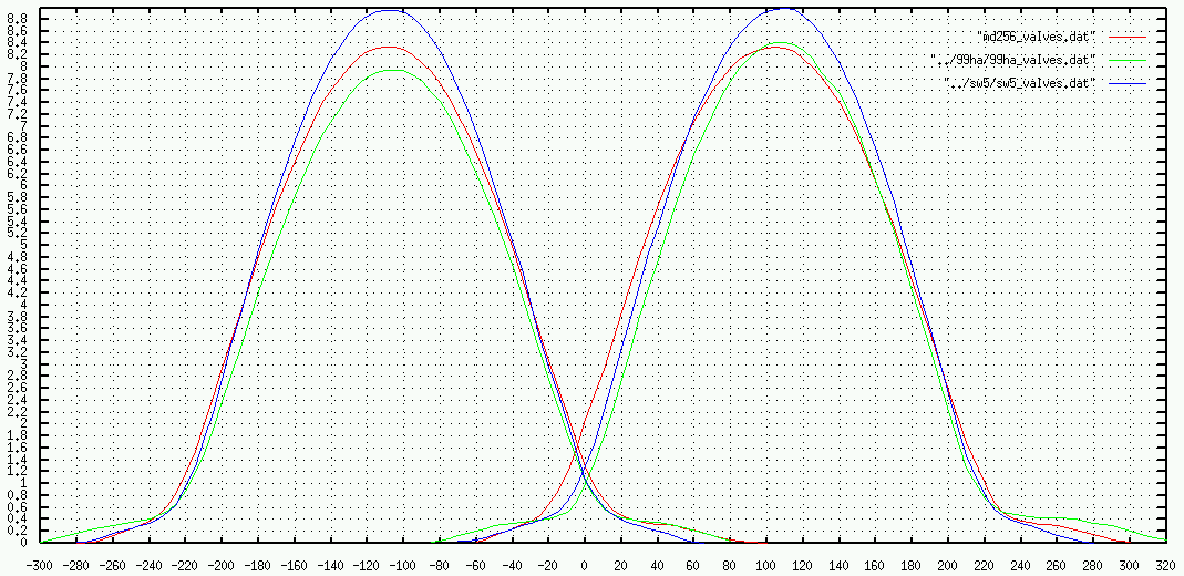

Paul: your approximations (from the thread you pointed) look very different from the real profiles I measured.
The take-off area is usually very grinder dependent and very different from basic Sin/Cos shapes. Just by looking at this zone one can say if cams are well designed. Of course the rest is important as well, but radical asymmetric-ramp square-shaped cams are rare (Schrick does them for Porsche)

alpa
520 Posts
Member #: 2093
Grenoble, France
I'm attaching the profiles because my Internet provider is putting me out.
