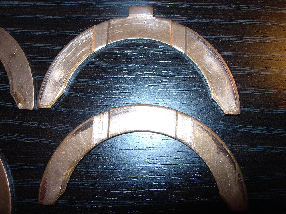

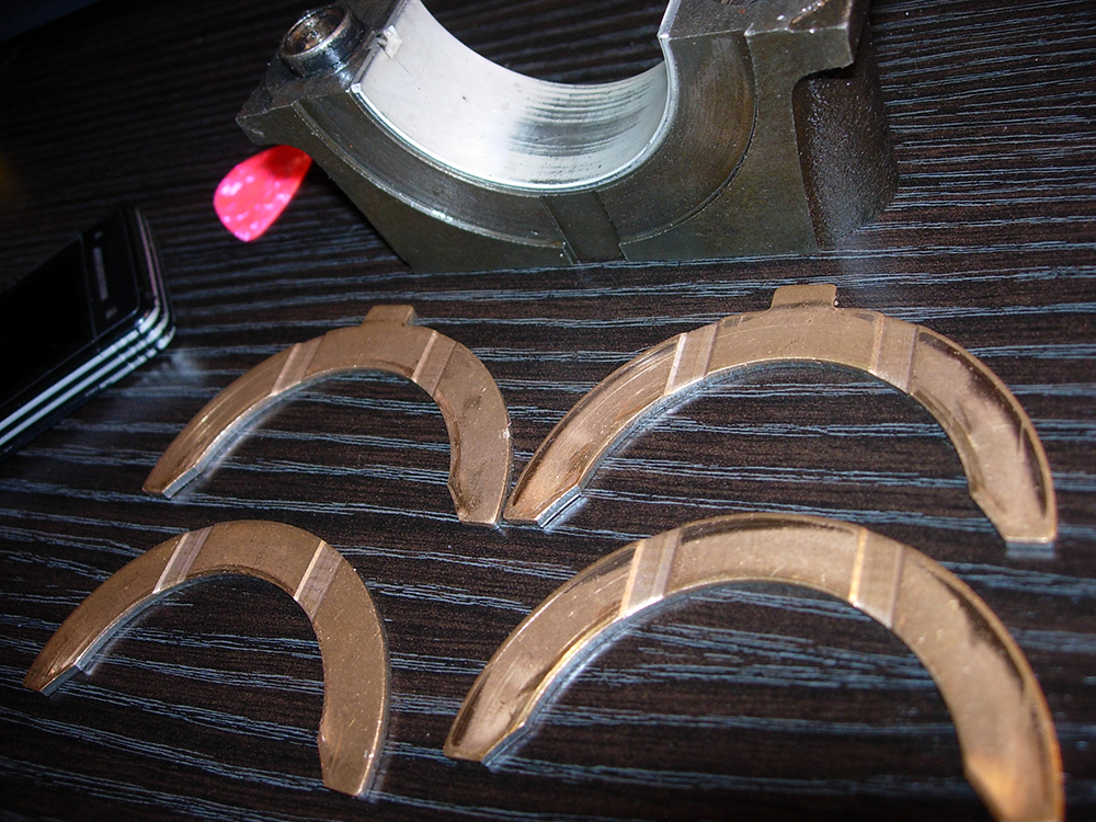

Whipped the thrusts out and checked them over. Here's the condish they're in:
As you can see, the thrusts do look a little worn in parts, the rights in particular (both from the flwheel side!). They're STD sized thrusts (2.2mm thick).

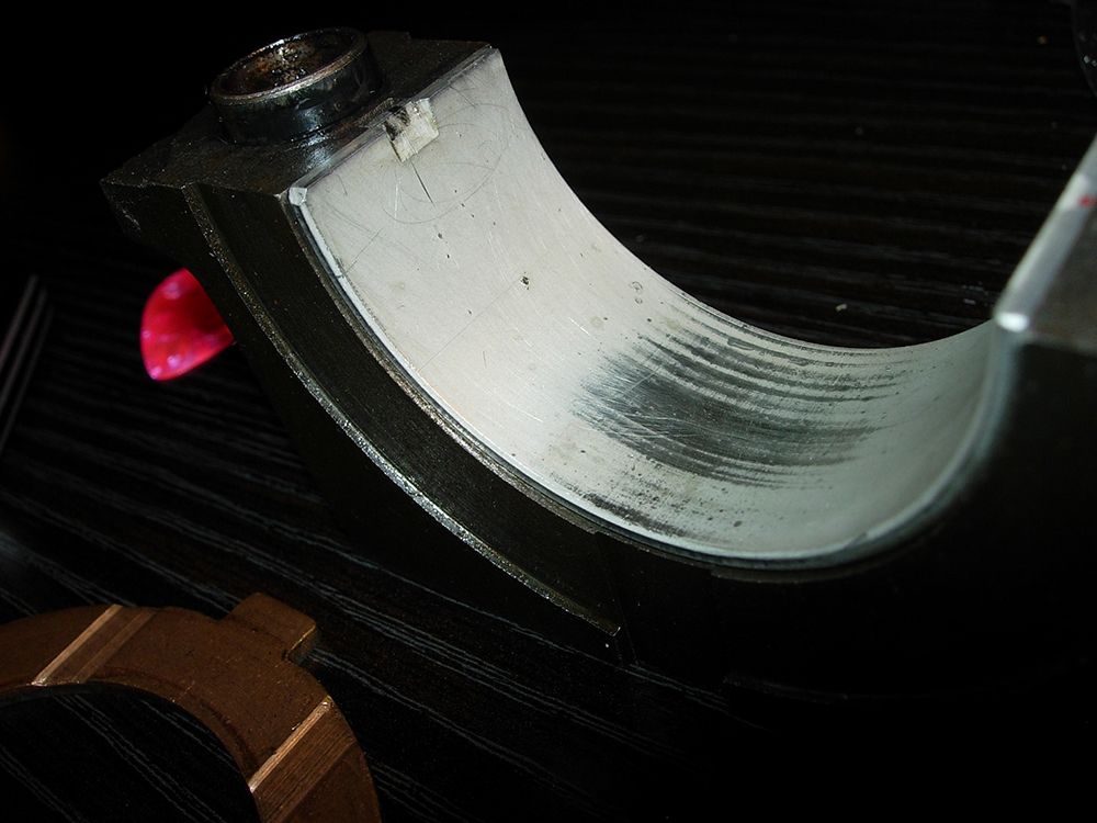

You can also see that the centre main bearing has worn at the bottom, is this a problem? What would cause this??
Do the thrusts and main bearing look re-useable?

6966 Posts
nothing that unusual about the thrusts,or the bearing for that matter, they look perfectly reusable to me,
carl
if you put them back i would swap them side to side, so the ones that are unmarked are where the marked ones are now *wink*
As per Carl, seen a lot worse running fine....

well, TBH hinking about it i think the endfloat is probably fine as the thrusts are only marked on the clutch side, if it was too tight there would be some marking the otherside too...

That lloks good, but CHECK carefully the endfloat even if you reuse the thrusts. This is because you wear off the "high spots" effectivly increasing the endfloat the first three minutes.
This is why 2nd hand thrusts are great.
