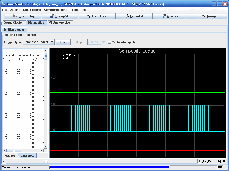

You can have a look at the composite logger. Select the diagnostics tab in TunerStudio and you will have a graph of what MS is seeing from your two tach inputs.
You can capture the screen and post it here.
Jean

Jean, Heres a screen dump of the composite logger

There's definitely a problem because there is no cam trigger in this log. There should be a green graph above the blue with pulses when the cam signal occurs. Have look at this:http: //www.msextra.com/doc/ms2extra/MS2-Extra_tooth_logger.html.
So you either have a bad sensor/input or there is a misconfiguration somewhere.

This is what it should look like:
