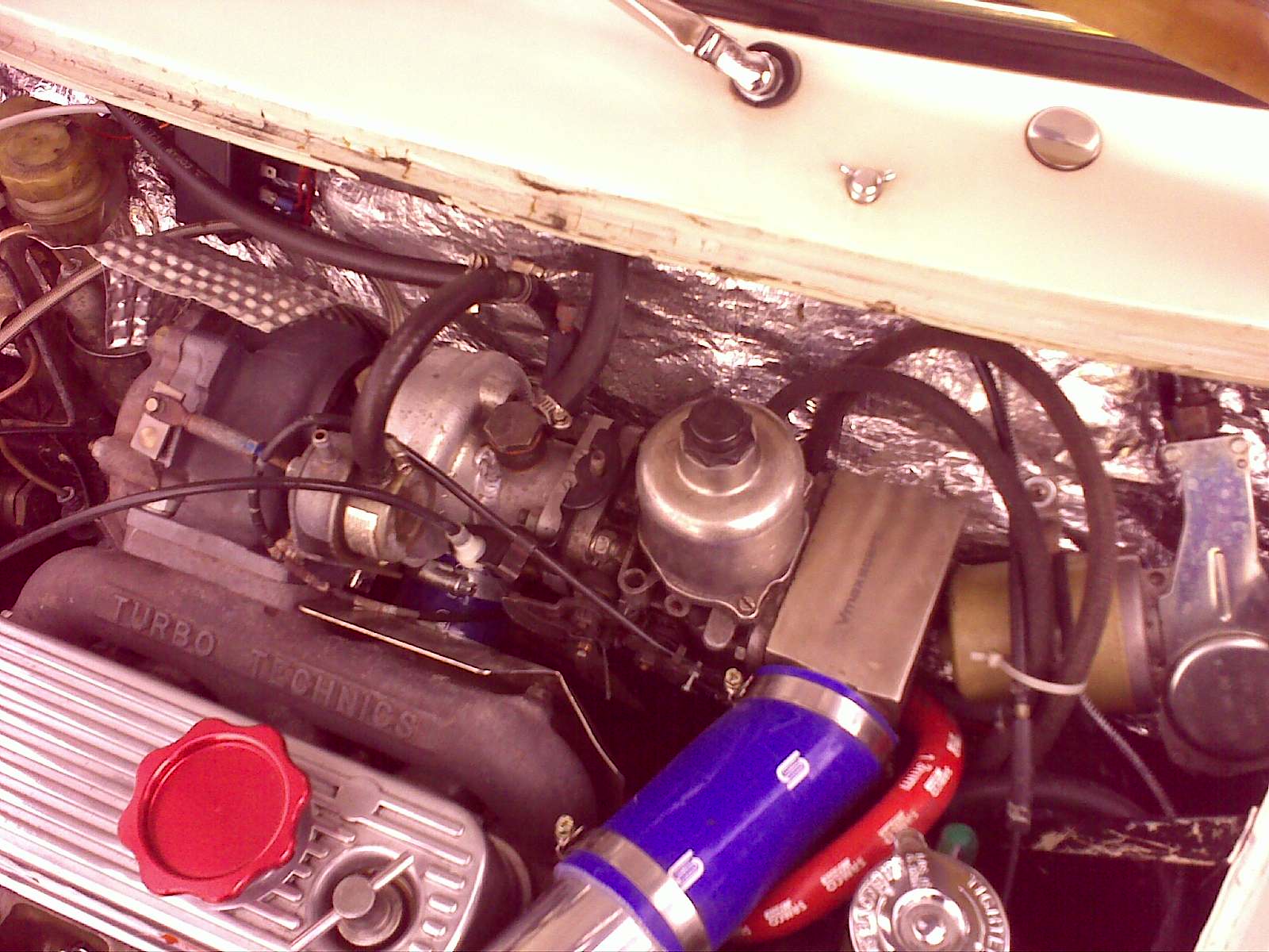

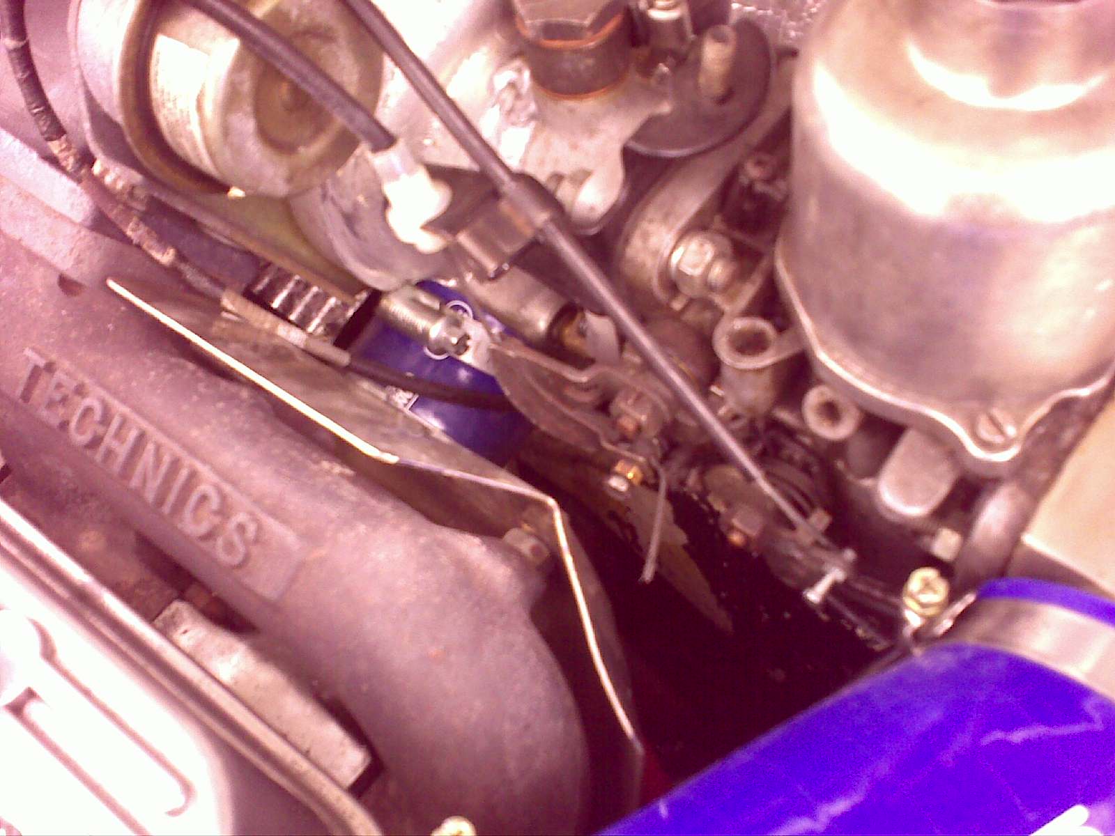

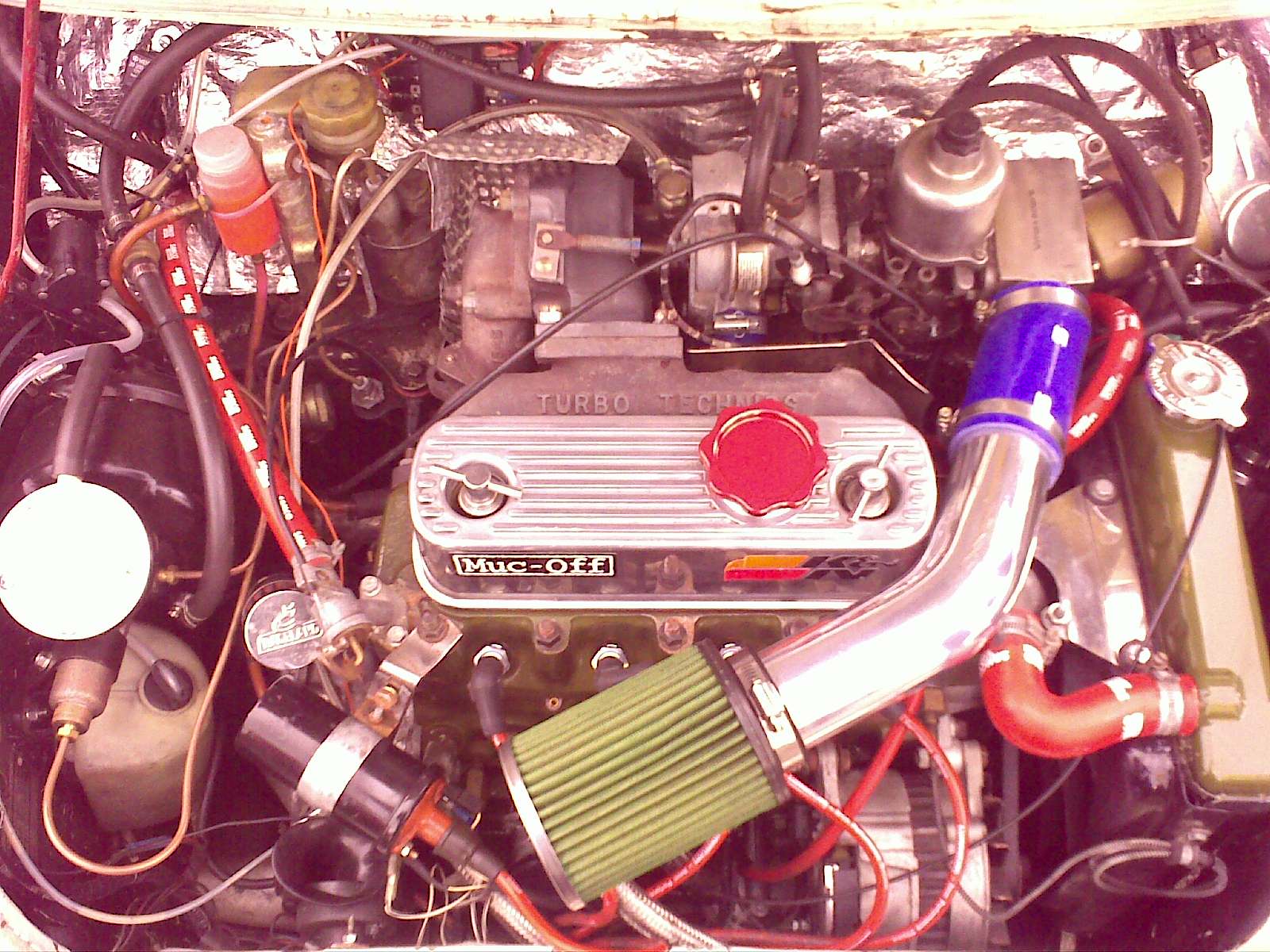

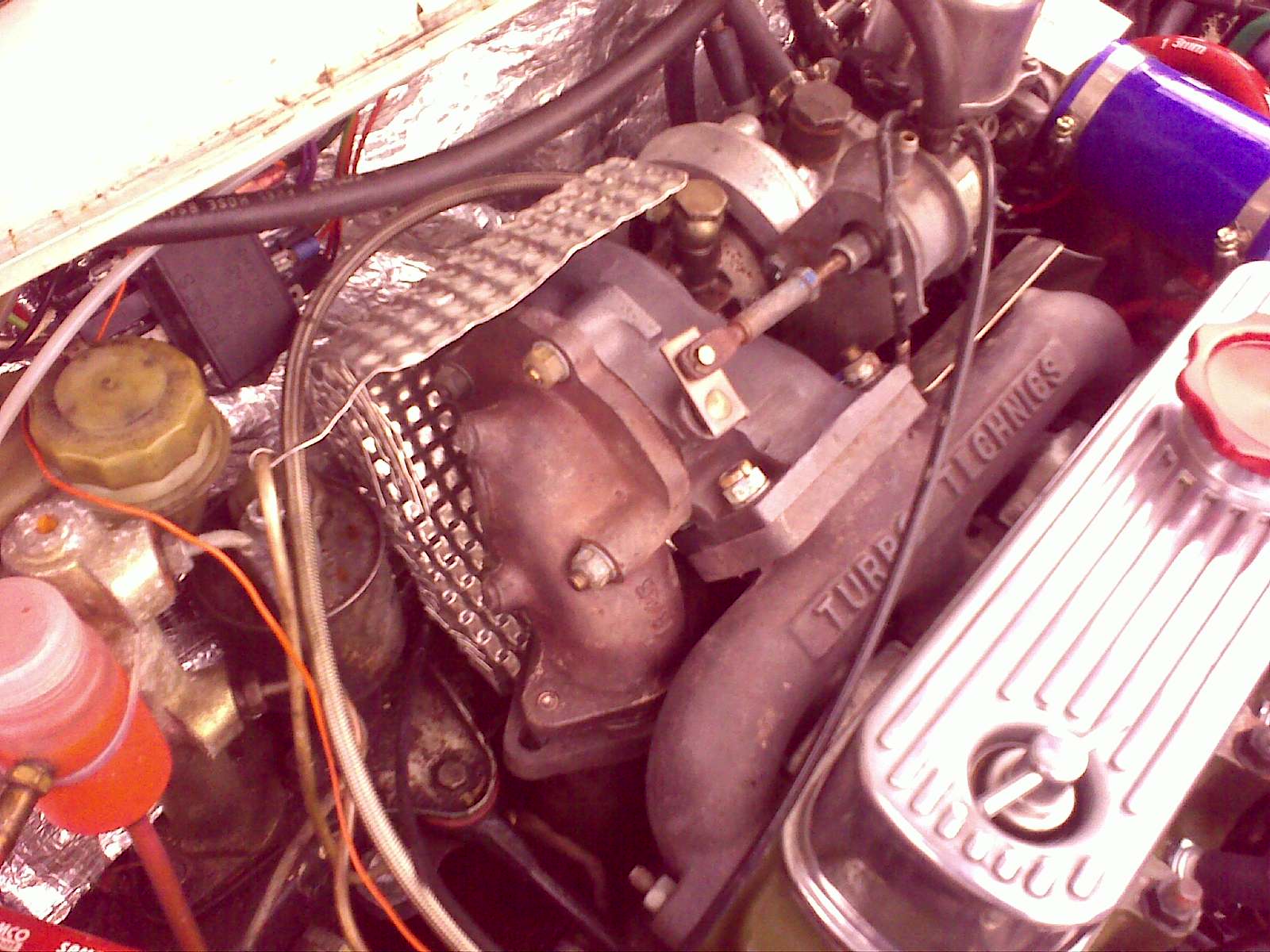

Yep.
Got speaking to the guy who had the Van with the Turbo Technics install at Brooklands.
Looks a great install but heat was a big issue with the bonnet. So much so he had to buy a fibreglass job and fit loadsa lagging.
He said it went like stink and was running about 8 psi although he did buy it already converted and didnt know alot about it.
I've addeds some pics of his van and some detailed shots showing the clearances etc. I recommended he became a TM member, can't remember his name though.
Would be a relatively straight forward job by the look of the parts involved. The previous owner had fitted a NA HIF44.
Personally speaking - looks like a bloody nice job and if you do decide to sell, it'd probably make quite a bit due to its potential rarity.

thanks for the replies, i agree the inlet manifold does look restrictive but after seeing the pics maybe it'll be worth fettlin as it looks great!
