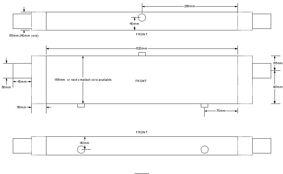

Following on from disscussions about the Chinese ICs I want to try a different IC. The dimentions of the one I have are as below.

Following on from disscussions about the Chinese ICs I want to try a different IC. The dimentions of the one I have are as below. I got Pace to quote me for a copy, but it was nearly £400 which is beyond my budget. So I'm on the lookout for an OEM cooler of similar dimentions. I want to retain the large IC look of the hillclimber, but can easily change it to suit as its GRP . I've searched ebay for a while and asked some sellers to give me dimentions, but not found anything yet. So any thoughts on what might be suitable. Plastic ended is fine. . Cheers ![]() I assume your quote was for a full intercooler unit, not just a core ? As they didnt even quite me that much for a core more than double that size. 9.85 @ 145mph

What about a pug 406 tdi ic they are massive and with the clubby front you should be able to fit a rad and the ic inplace?? They are about the size of the rad but not that thick. Drives

hey Wil that chinese mob will do custom stuff i'm not sure how good it would be.
18th Jan, 2011 at 09:58:21am
The problem is that the core I have at the moment is of chinese origin and is not an efficient design with a high pressure drop across it.

There are different types of intercooler core, bar n plate or tube & fin. Top 2 pictures are bar n plate, bottom picture is tube and fin. There are 2 ways these are constructed, glued (like the top picture) or vacuum brazed (bottom 2 pictures). Glue will acted as a thermo conductor which will take longer to release the heat, where as a vacuum brazed core will release the heater quicker due to the way the brazed holds the core together i.e. 100% connection between the tubes & fins, plus its much stronger, but sadly slightly more expensive!

Yes I agree, but all the higher quality ICs use the less restrictive designs. which makes me think that they have a better pressure-drop:thermal-efficiency ratio than the cheaper Chinese cores.

Again, you are generalising about design. Just because it looks different, doesnt mean one is better or worse. You need to take the entire package. Dense turbulators/fins will restrict, but they will also assist cooling. Sparse fins, will obviously flow better, but might cool fuck all. So you need to find a balance of a core large enough not to restrict, and a set of tubes/fins dense enough that it cools. Fastest 998 mini in the world? 13.05 1/4 mile 106mph

Wil_h, I'll see what price I can come up with the drawing you have hear, and report back.... Graham |
