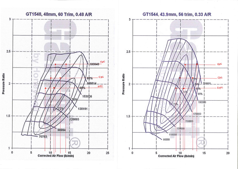

Any ideas how i would plot my 998 on the GT1544 map,
I tried the instructions by garrett but cant make sense of it.
Im probally gona go with a GT1544 anyway but i still wouldnt mind gettin a grasp on these maps,
http://www.turbobygarrett.com/turbobygarre...bo_tech103.html
http://www.turbobygarrett.com/turbobygarre...44_454083_2.htm
A job worth doing is a job worth over doing
Right here is my rough plotting on the 44 and 48 maps for a 998. The lower flow point is 5k rpm and the upper one 6k rpm.
I would say that to make the most of the 48 you need a higher revving engine, but even then it's nowhere near as efficient as the 44. and you'll be getting full boost on the 44 from 3k I reckon, but more like 4k on the 48.
From driving our (very low geared) 998 with a GT1752, it would make a dog of a road car.
