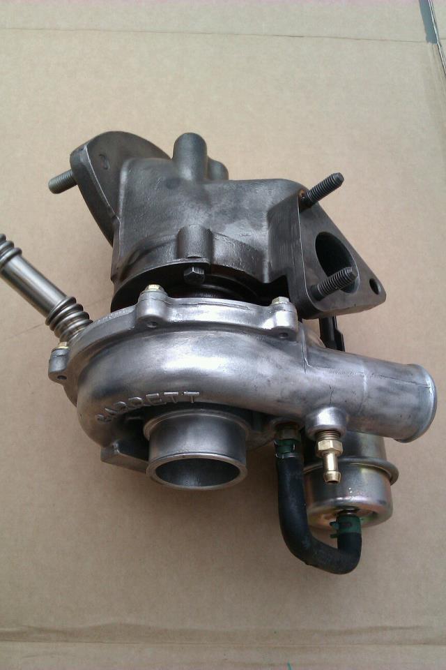

got this in the post this morning. i cant stop grinning and thinking about how i'm going to fit it!

Not to piss on your chips but is that big enough to flow enough to support decent power on a 1275?

i hope so tom tbh. it was brand new for £130 so im just going to go for it. how can i tell?

If it has the same compressor as the t2 then It's good for 160 bananas. Assuming the turbine has the flow.

dont mirage now use the 1548 as the T2 replacement? so would think it was somewhere near.
That 1549 is the standard fitment model off the rover 25/45 2.0td models.

It dosn't look brand new to me Stu

fairly certain ive got one sat in the shed

its new old stock carl. its got a bit of oil on the housing i need to wipe down. its off the rover 25 diesel yes. £130 on ebay.
I have one from an astra diesel that i plan to put on my 1275. From what i could find on the net it is good for about 120 horses. So i'm sure it will end up ok somewhere between 120 and 160 as wil says. Should be great for a daily.
