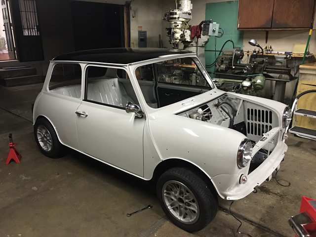

Here is the car as it basically sits now:

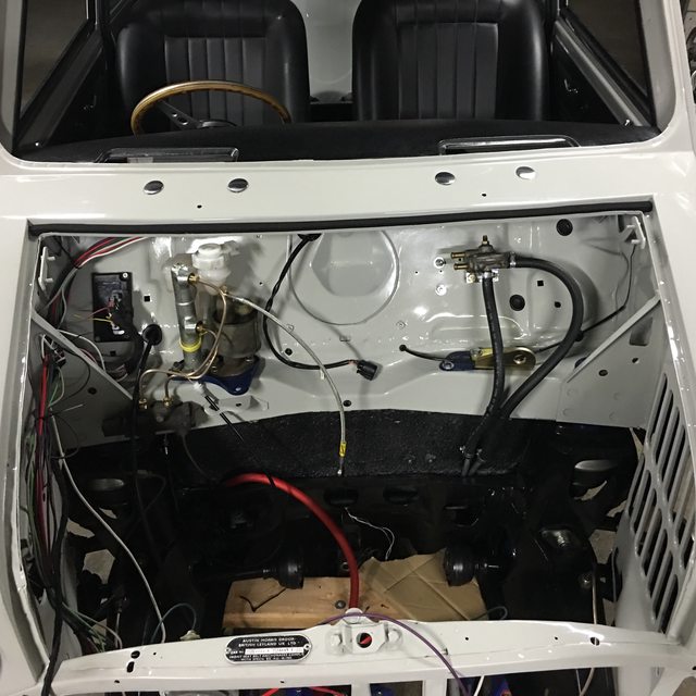

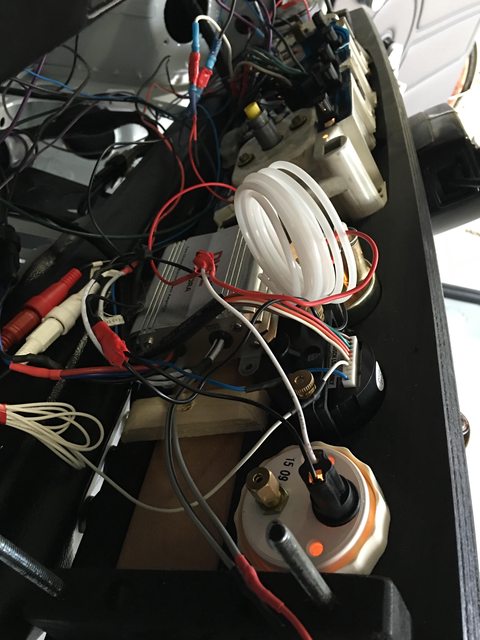

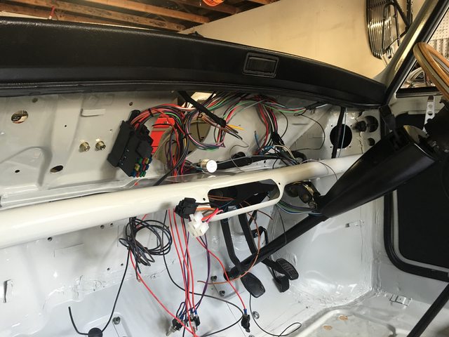

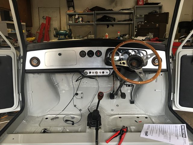

Spent the past weekend wiring up the car. I used an 8 circuit universal wiring harness which worked out pretty nice. I don't love the Rover wiring design, too many shared circuits and too few fuses! I found tracing things too hard. This setup worked pretty well but definitely designed around American cars and switches so I had to do some modifications.
Dash all in:
Still need some clean up back here:

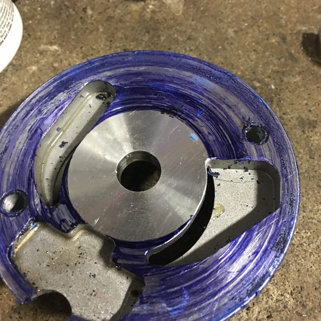

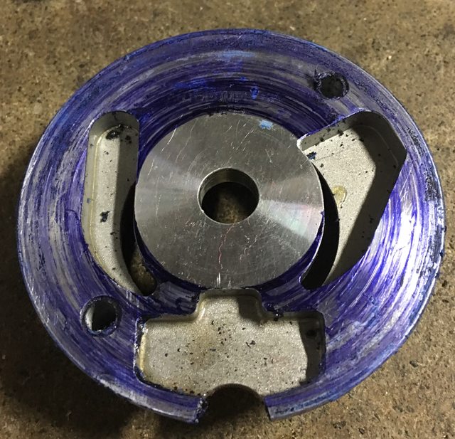

Well I took it all out today and it's definitely part of the bad pump lot. The sealing area looks even worse than some of the pictures I've seen. Maybe the chamfer is slightly bigger on a 998 block but I took the internals out of the pump housing and put it back in the block. You can pretty clearly see the chamfer of the cam bearing just looking through. Emailing Minispares, hopefully they can help out.

well that's certainly not going to work! Its a pain but at least you found out now and not once it is in the car.
Phil R made up a sandwich plate to make his pump work. Given your engineering ability, I'm sure you could do something too. its on the last page of this thread
http://www.turbominis.co.uk/forums/index.p...d=581351&fr=175
Edited by Rob Gavin on 18th Mar, 2016.
That is the worst that has been photo'd on here.
Maybe as you say the ports in the 998 block could be bigger making it worse.

Regarding the pump, I heard back from Minispares and it sounds like they are very close to releasing an updated pump with wider sealing surface so I should be able to just use that one.
The sandwich plate looks would have been my next best option. I was actually looking into getting it laser or water jet cut. I can't imagine there is a huge market for them but if I get a dxf drawn up for it, I'd be happy to share.
Replacement pump is the easiest option. I was just thinking, with your location and timescales, you would have been easier to sort the issue.
Interesting news from MS though. Clearly thry have realised the issue and addressed it

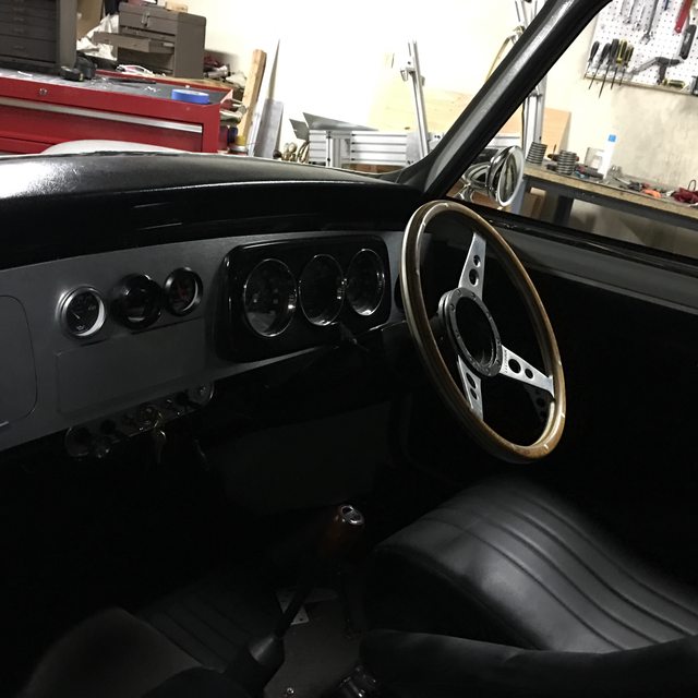

Fitted up my Cobra seats and held up the dash to mock it up. Really happy with the look!

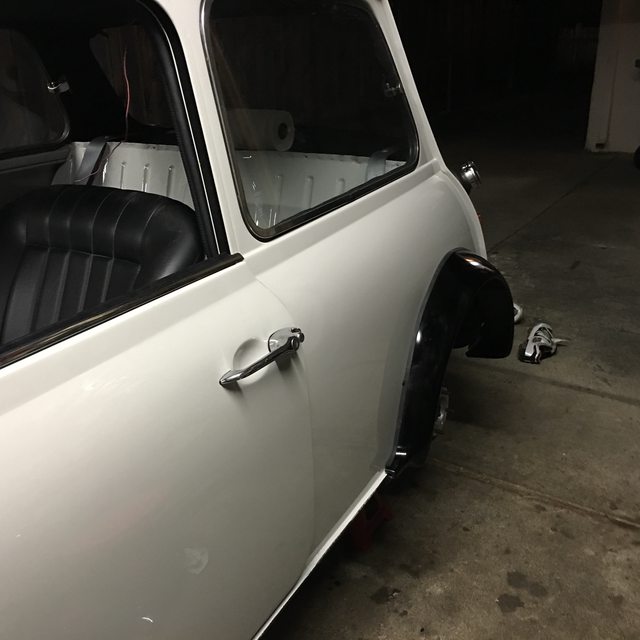

Got the rear arches fitted, still need to wet sand the clear but I'm happy with the fitment. I had to put some new holes in since the body shop bodged the mounting. Not super happy about that but once a couple holes peaked through and wth some rubber grommets it's hardly noticeable. Once I save up some cash I'll probably have it fixed.

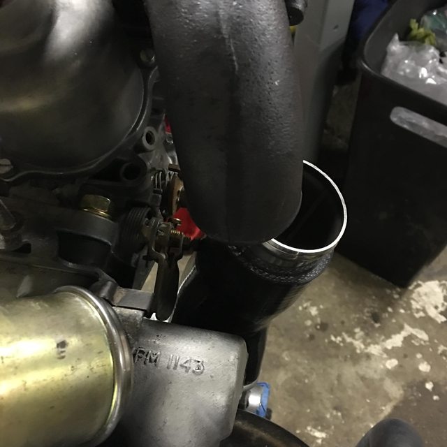

Now here is a challenge that I'd like some advice on. When I fit my intake tube to the plenum it fouls on the throttle cable bracket. Anyone had this problem? Found a solution?
Fantastic build. Best thing to do with the misaligned hoses is fit an intercooler.
Love the Cafe Racer, I keep hankering after such a thing, but I'm not really cool enough to ride one!
www.twin-turbo.co.uk
The throttle cable bracket should be on the other side of the carb

Good call on the bracket moving to the other side. I got thrown off because the cable stops are on this side of the carb. I imagine I can fashion up a similar bracket.

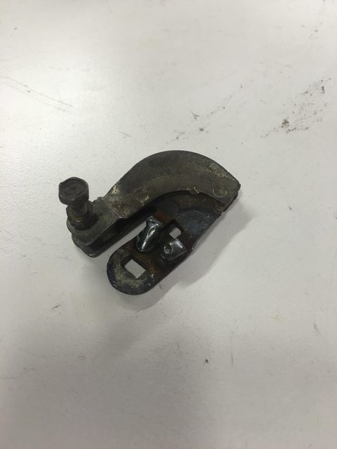

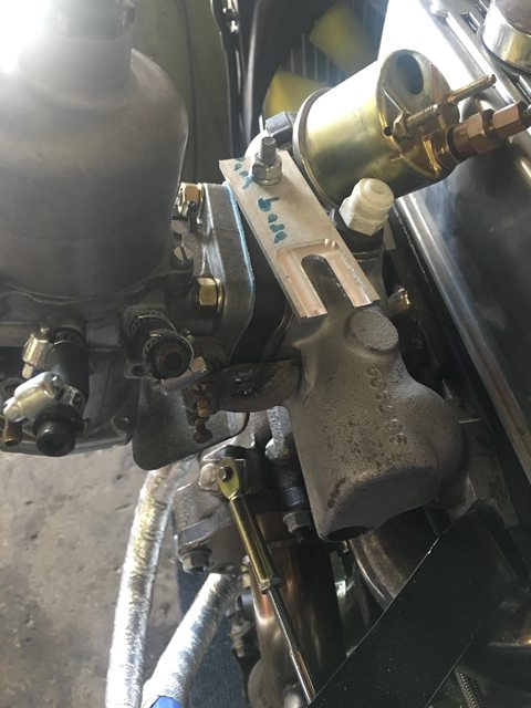

OK! Back at it and figured out the bracket setup. The one I had was definitely designed for the side I had it on so I tried to bend it for the offset on the other side. That ended up making it too long with a long for manifold interference so I cut it off and welded it back on shorter. Here is my crappy welding:
Next I needed to make a bracket for the cable hanger so I fabbed that up quick out of a piece of Aluminum hanging around. It ain't pretty but it works and I'm over pretty at this point. I just want to drive!

Are you using a na carb? I'm going to have to do a similar mod on the na lever i have to fit it on the other side too
loving the home made tools!
seahuston
168 Posts
Member #: 10666
California, USA
I guess it is a NA carb, that explains why the linkage is on the other side.
It's a pretty easy mod, I'd just start with cutting it and welding it, that will help with the spacing and the length. I'm sure I've made the pull ratio slightly less than ideal but that seems to be the trend of this car.
The cable hanger was really easy, I had to relieve it because of the thickness of my stock but if you had the right thickness it would be even easier.
