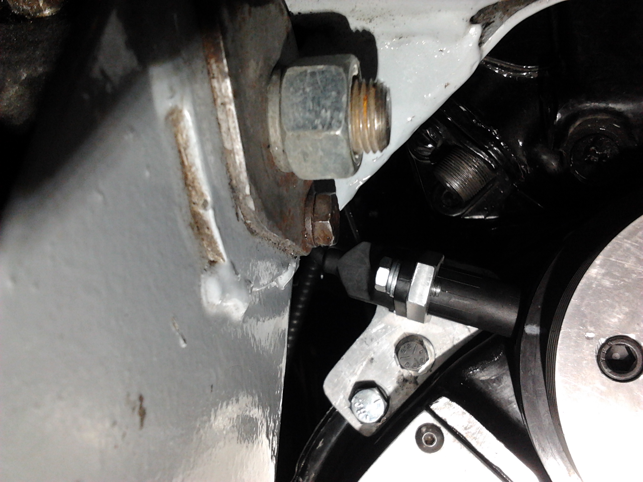

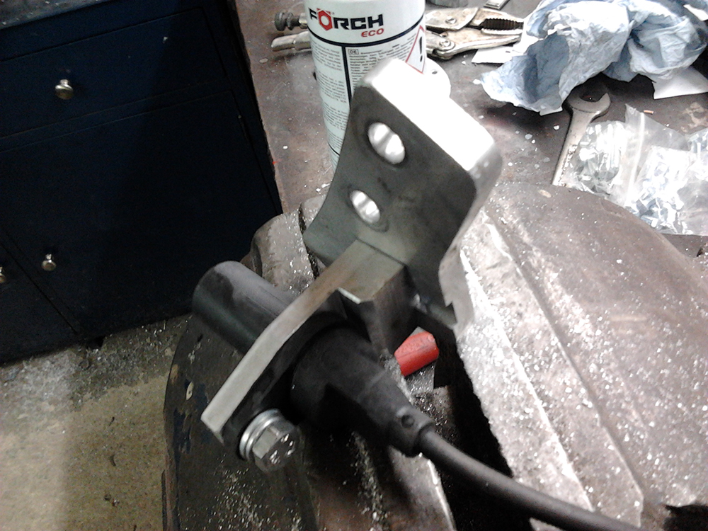

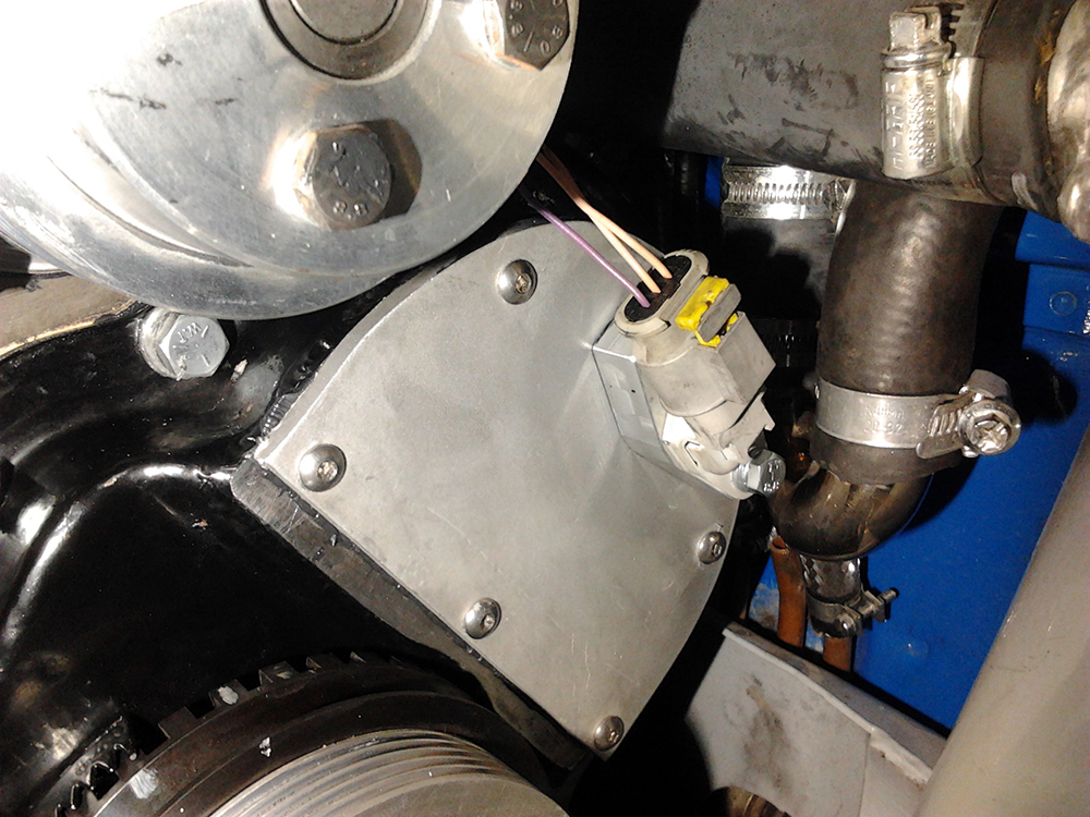

turbominik
76 Posts
Member #: 8976
This is the crank and cam sensor.

Interesting looking project. Did it work ok on the carb?
Interesting cam sensor.
Hall switch I presume from the three wires but what is it looking at on the sprocket ?
turbominik
76 Posts
Member #: 8976
Hi it worked well on carb but you now you always want to improve something
For cam sensor, yes its a hall type and its seeing a higher head of one of vernier cam sprocket locking bolt.
