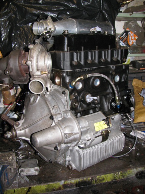

This reminds me that I need to do an update on the inlet manifold as it is all changed. Now billett CNC bosses and an alloy plenum with even longer runners.
http://www.turbominis.co.uk/forums/index.php?p=vt&tid=480014
After 18 months of just sitting on my bench, I thought that I better get this finished:
Everything optimised for peak torque at 6000rpm on 0.8 bar boost. Rev limit 8000rpm. Should net 120 lbft. Built for inevitable future boost increase and 170 lbft :)
Now where did I put that car to put it in?
