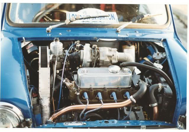

are you using that cam lobe sensor thingy?
I reckon there could well be a fair bit to bit trimmed off, i.e. bring it back to the shape of the rib that runs along it
Also the flange that bolts to the manifold on the GT appears thicker than the T2
Measure the diameter of the compressor housing at the widest part and ill measure mine tomorrow

gav , bearing in mind ,a lot of the port flow is densest at the top of the p orts ,look at the manifod from the side and try to see if it will be a bit restrictive upside down ,
http://www.turbominis.co.uk/forums/index.php?p=vt&tid=9000
when we did this one in 86 it wss with the metro cast manifold that has a straighter take off from the head so it was ok , hey you could allways do the same and flog the mirage kit ???
the inlet manifold may be a prob then though , although that ws with a t3 ,which is far bigger .
one of the reasons i designed it that way ws the big advantage of no hot air rising past the carb .
regards robert

Remember this:
And this:
Before they removed the photo, I remember this guy had three injectors mounted at intervals along the inlet tube and a remote mounted TB.
I think the idea was that whatever slug of air went into the engine, the fuel was well distributed by the spread of the injectors rather than fancy injection timing.

On 17th Jan, 2008 Bat said:
Paul .. I was thinking about it today, hope he's not got any copyright on it! *wink*
Where would you put the injectors on my setup?
Gavin :)
I suggest that you put your TB down the front of the engine like I have.
Then put three injectors downstream of the TB, spaced 120 degrees radially around the tube but spread out axially by 75-100mm.
If all injectors fire together, say four pulses per cycle, then you will get the best chance of even fuel distribution. IMHO.
