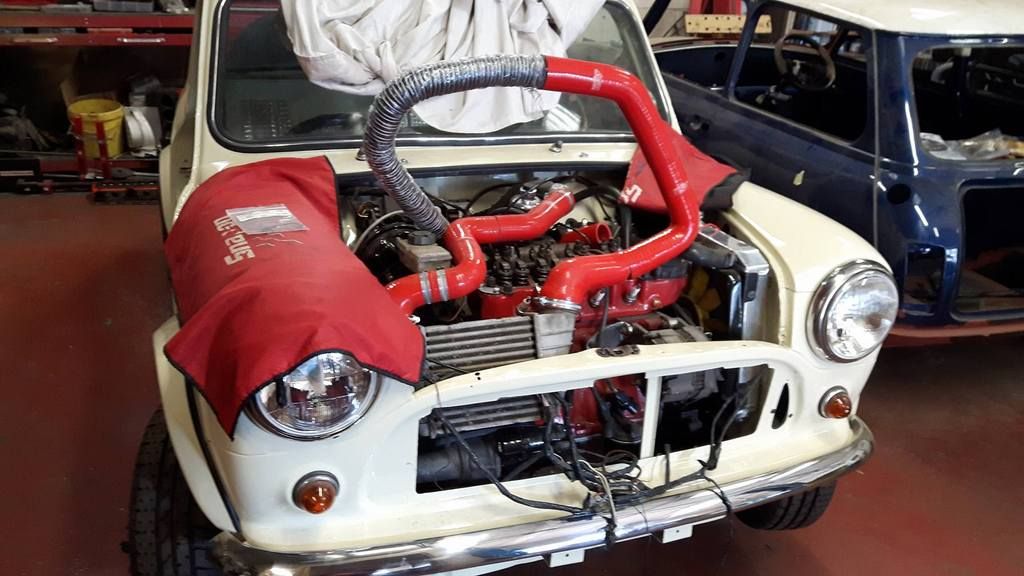

I finally decided to go for an Audi TT intercooler after seeing someone elses build pics online.
Hoses were only half done in this picture, but it looks like there should be room for the front mount intercooler, a standard alternator, and a 5x3" K&N filter between them.
I've used 45mm hoses for convenience (only a low boost build anyway).

Mines a tt i believe... im running a bar
Nothing gets past Dave lol
I tried tried the ttcooler but it didnt suit my engine bay. I'm now running a seat ibiza cooler. Plenty using the cosworth coolers too
