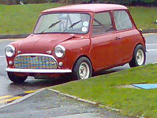

mines also lowered so yo ucan fit two fingers in the gap! good measurement!
With old cones, spax adjustables on 6 clicks on front and 4 clicks on back, and hilos ive got my green one now just how low i had my red one and it doesnt catch
not tried with passengers yet but that isnt a problem! if i do long journeys ill raise it a bit!

Feebs you must have very small fingers to get between that wheel and arch!

Maybe he meant the outher red car*wink*

feebs how the hell did you get away with that??? I'd have thought a shout blade of grass would result in tyre to arch contact!!!!!!!
Also to my eyes it looks terrible (each to their own...)

Feebs, that can't be right, that WOULD rub unless you drive like granny!. I suspect that the slope it is parked on is making it look lower and I assume that the other side is higher.

I have no idea then! no its not sat on bumpy ground it really was that low! 2 fingers fitted between the metal of the body and the tyre, maybe my plastic arches were mounted lower then they were supposed to be!
Is it matty on here with the white mini? His ride height is really low too

and yes it was a stiff ride and couldnt take passengers i had to raise it to! Also it does look daft because the front couldnt be as low as the rear or it would catch when turning
