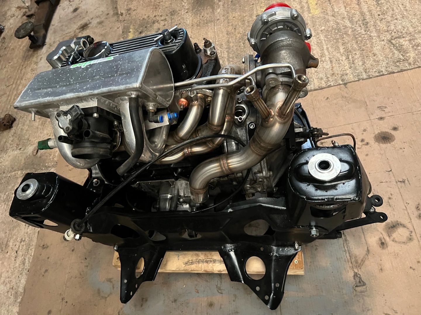

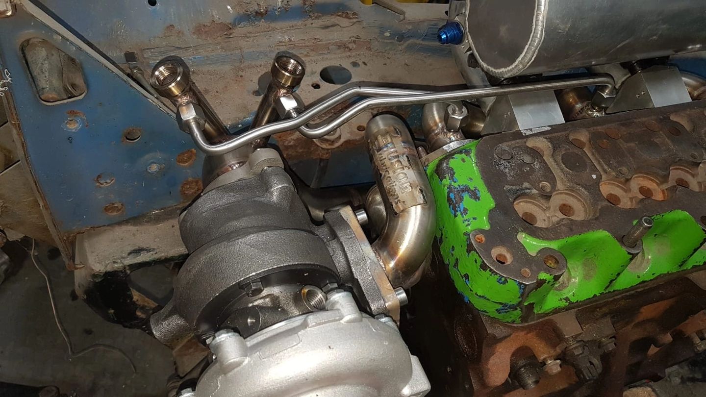

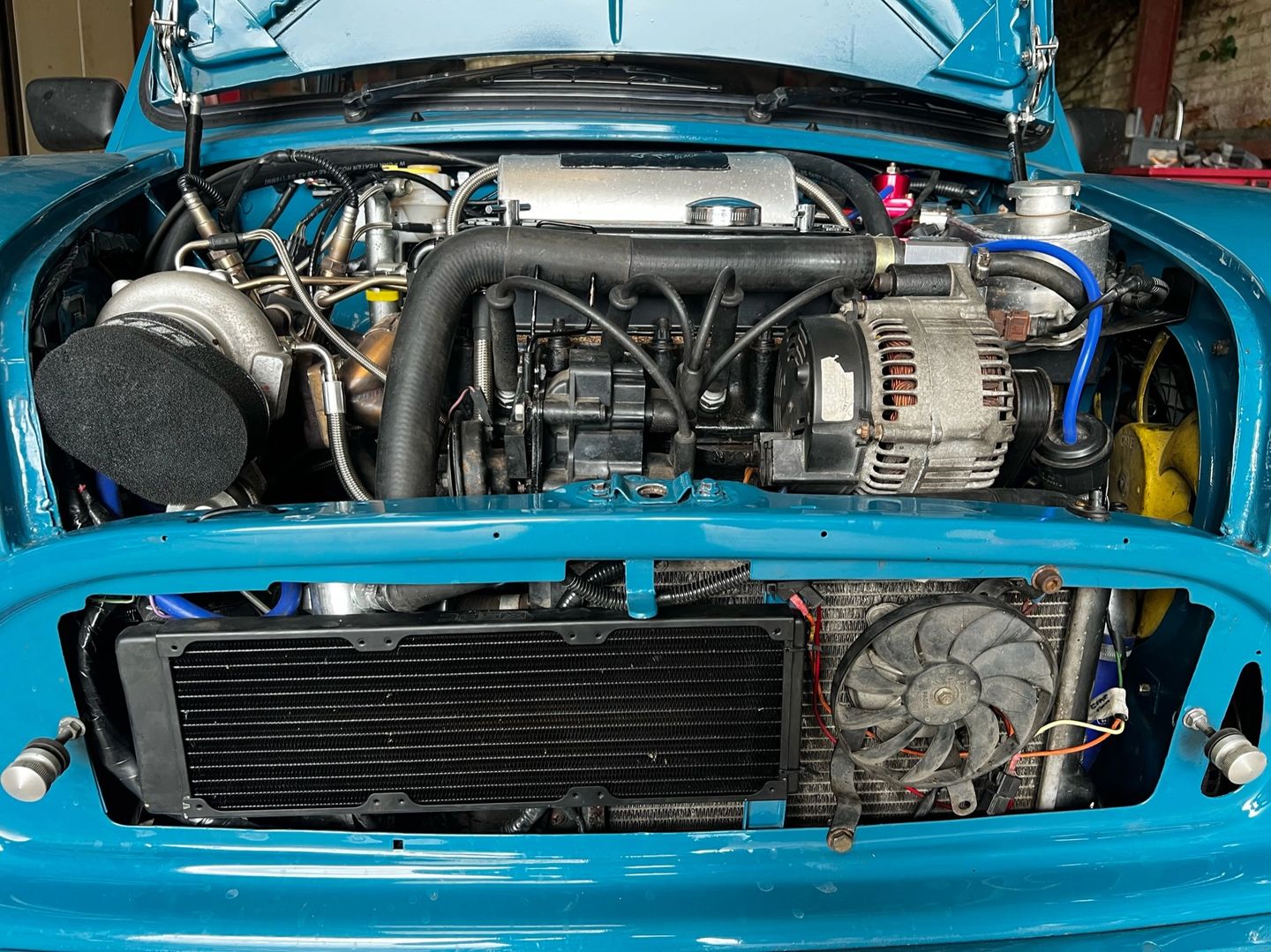

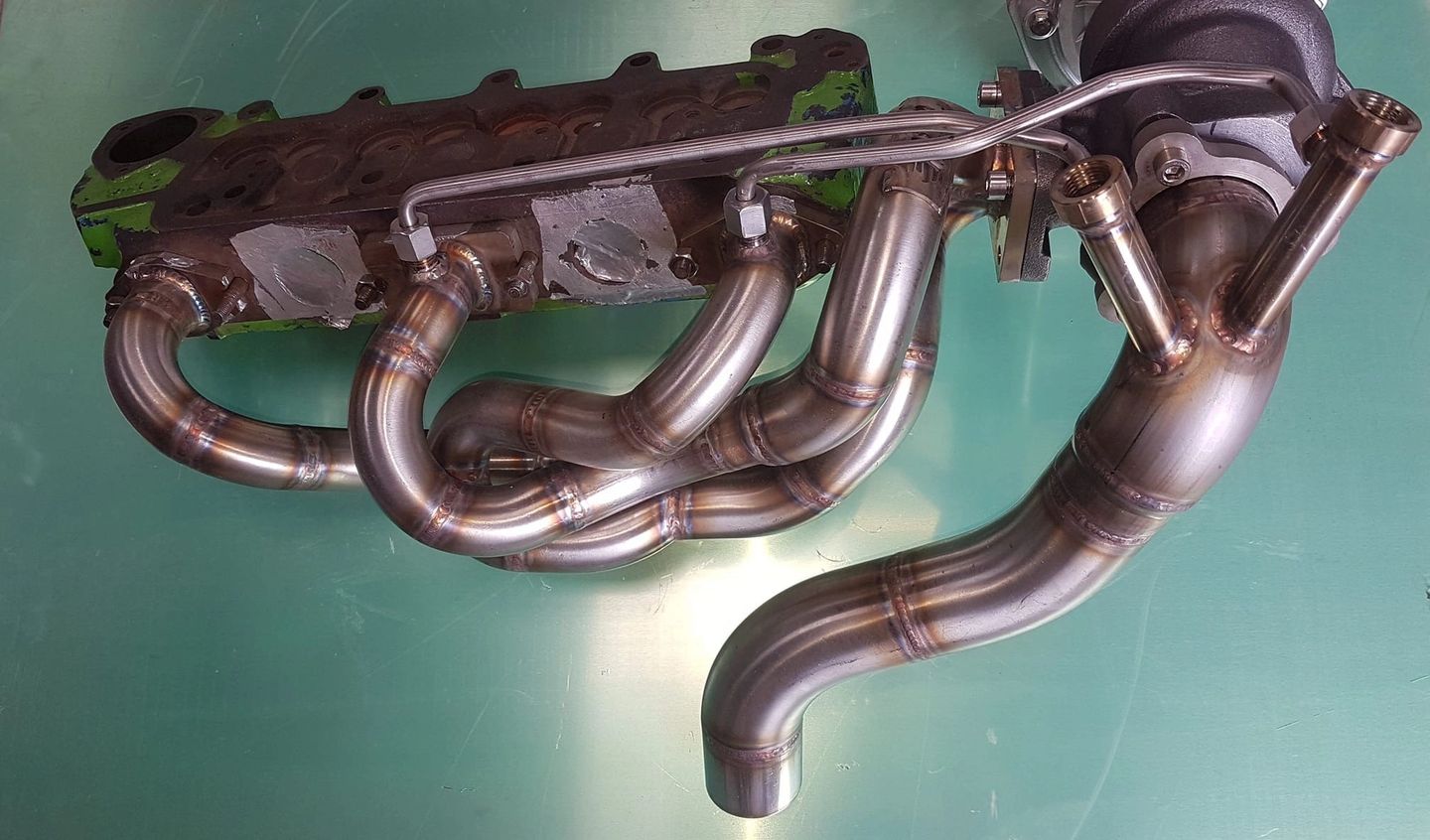

If you were to look back through the threads you would see this project has been in the pipeline for a while.
It’s finally on the road!

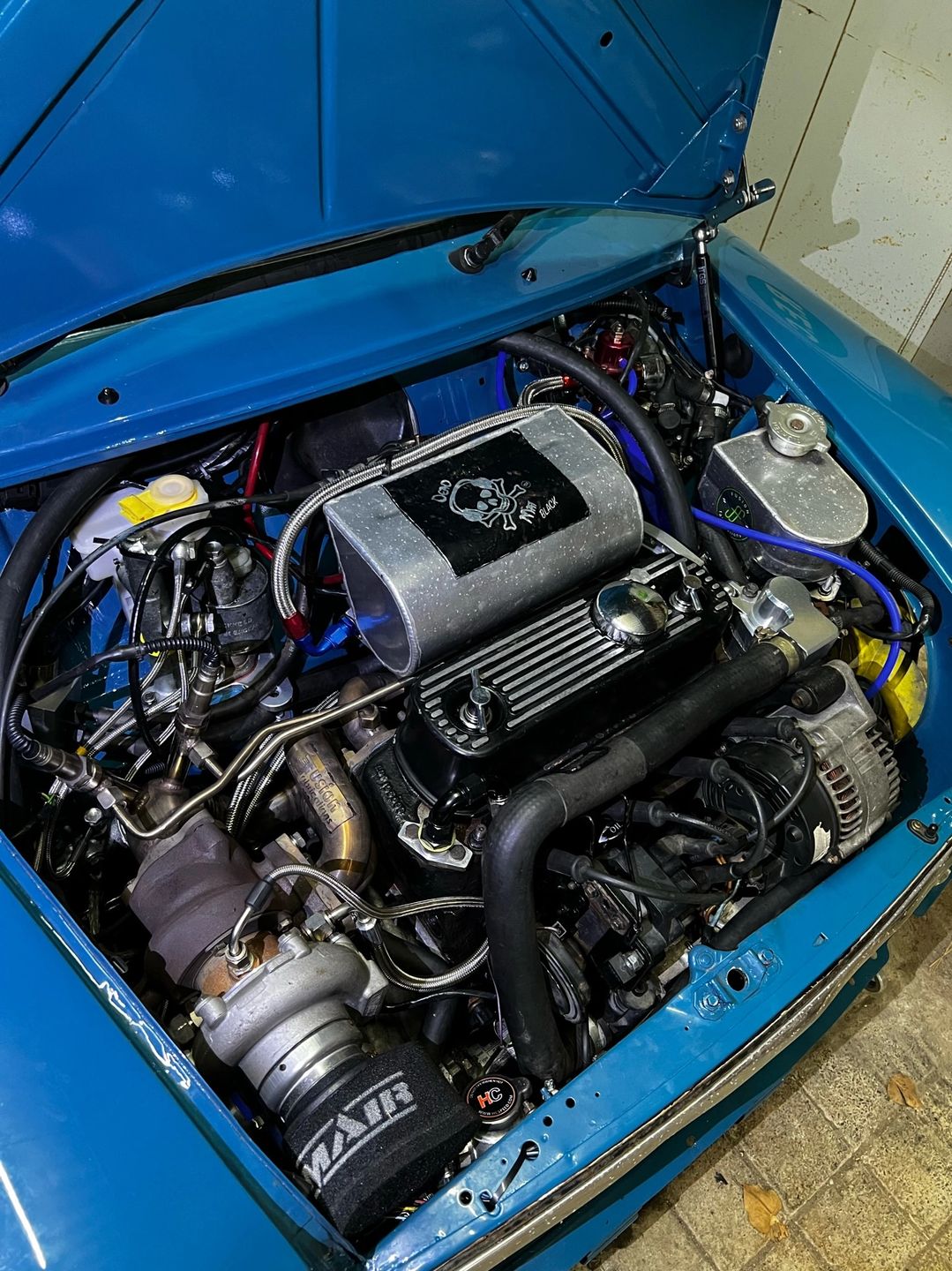

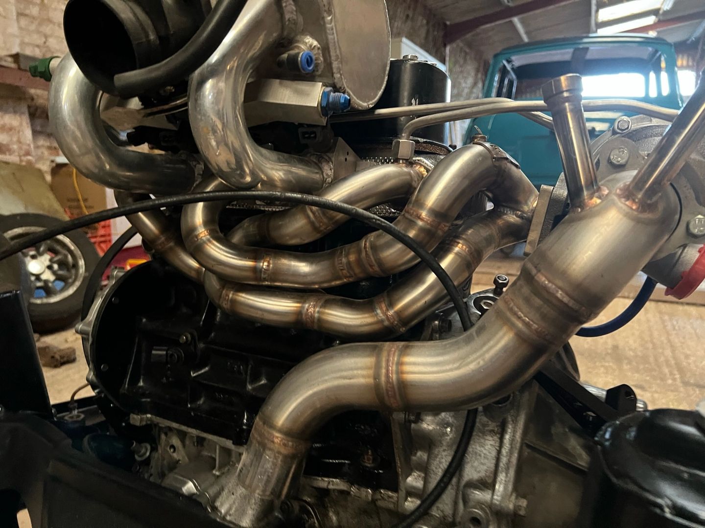

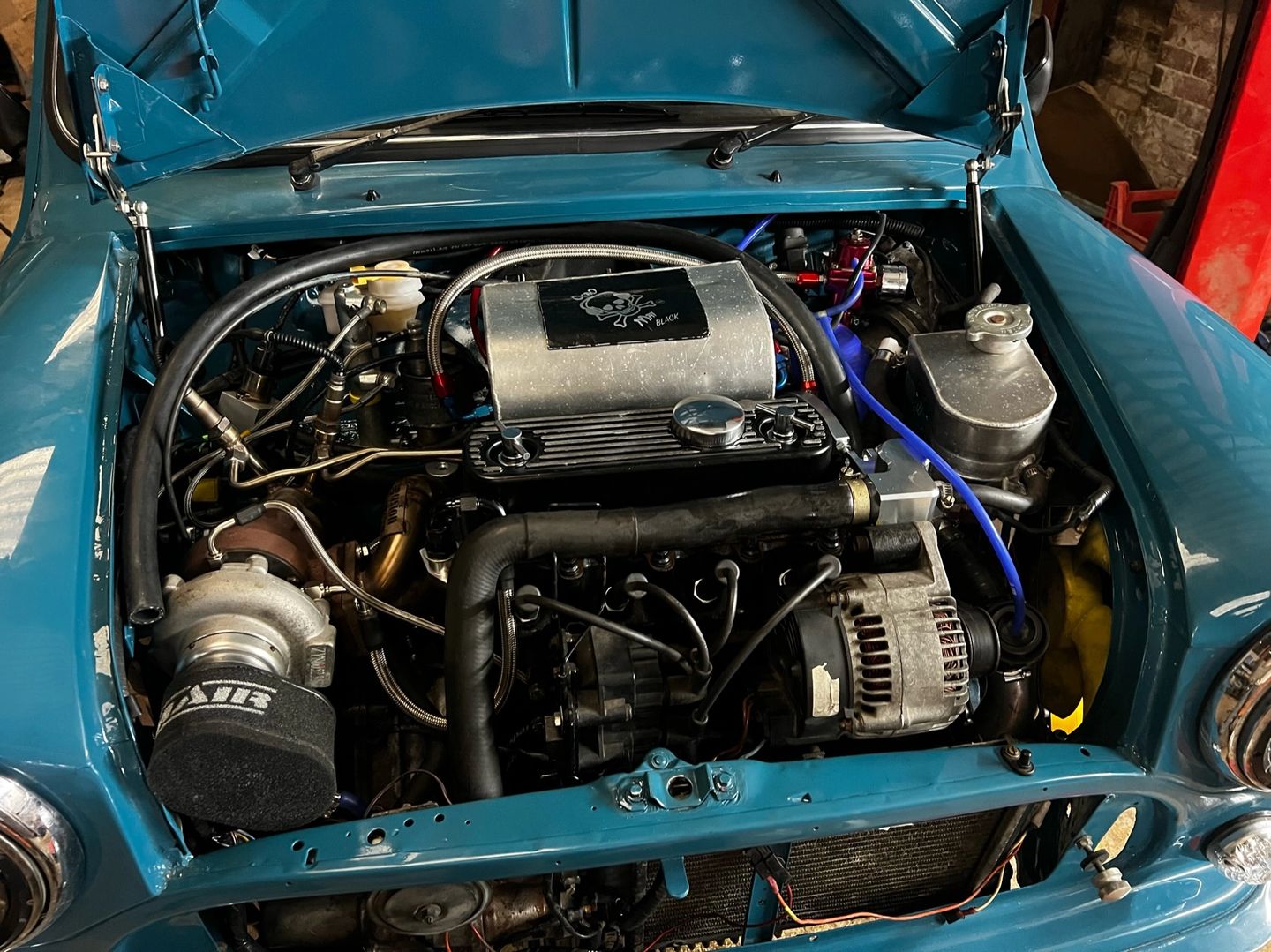

General summary of the build is as follows:
1275 MPi Engine
SW5 Cam
MS3X ECU
GT17 (Chinese eBay special)
Fusion fabs remote manifold
Custom intake manifold and injector bosses with tuned length runners (See PaulS post from way back when)

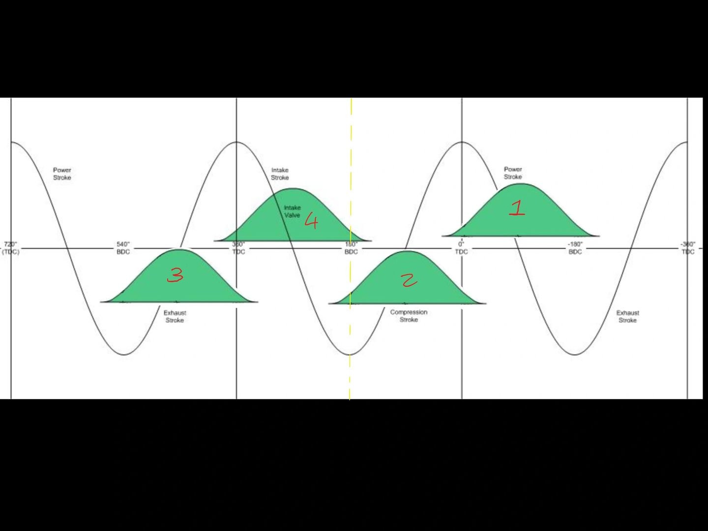

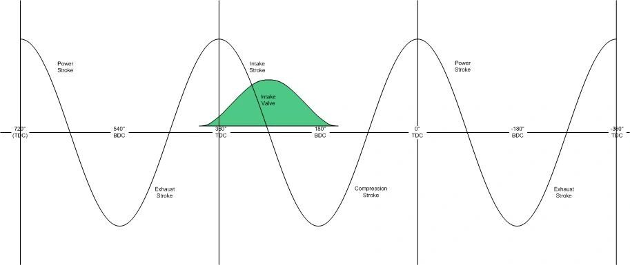

I believe this image is from someone on here. The question to confirm is where in the cycle should no.1 intake valve motion be located? Between roughly 30 BTDC and -200 BTDC? (thus making the green intake on the image suited to cylinder 4?)
and we end up with this?

I've been referencing those. But the starchak timing table is the bit that confuses me. Perhaps my cam is 360° out compared to Rover? When they use 560° I've dialled in ~100° to get the fuelling to work.

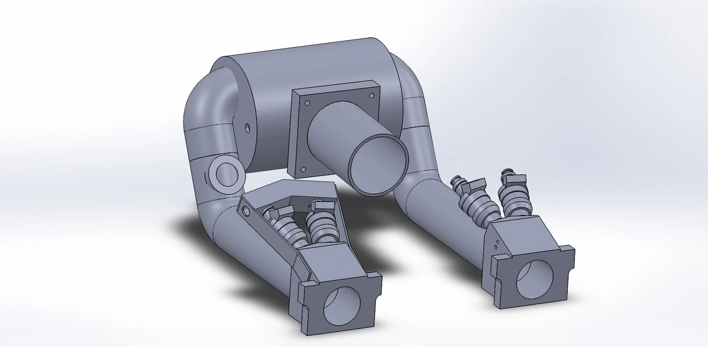

Revision A of the inlet to help show the injector bosses and angles on the injectors (which are the same for the final embodiment).

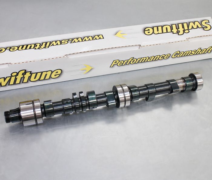

Looking at the SW5 cam photos the cam lobe is roughly aligned with no.2 intake valve full lift (which is 180 crank deg later than Graham's plot).
Which i think then aligns to my injector timing of ~60

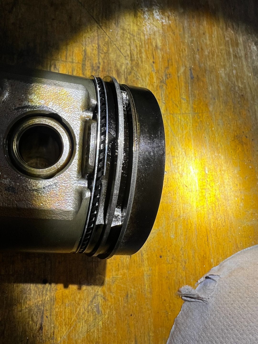

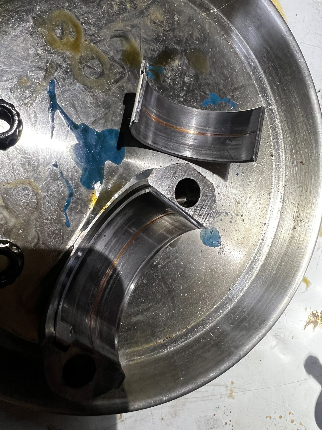

Short term however, I have a broken piston to contend with (owing to the lean misfire caused by the injection style). Also the engine was struggling with excess heat I think the old water pump and rad are not up to it. Circa 108C measured at time of issue.
I’ve broken off a small part of the ring land on no4. piston in 2 places.
Will add some photos later on.
I’m running (what I believe are) standard MPi pistons.
After the gearbox rebuild I had to do (lost primary motion gear). Funds are running low and I’d prefer to get 1 new piston like for like.
Assuming I get the tune right, are people reliably running standard pistons?
If not what’s the most affordable replacement? (from memory I’ve got no overbore).
Edited by dan187 on 20th Sep, 2023.
1275 EFi Turbo
dan187
774 Posts
Member #: 6724
Wootton Bassett

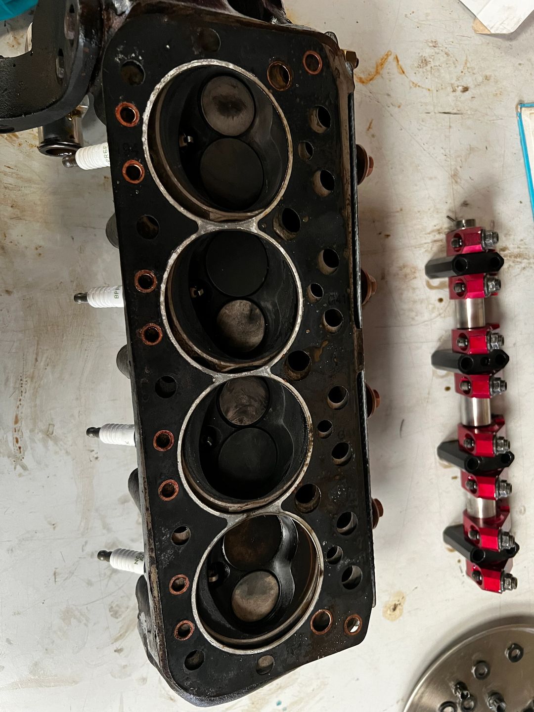

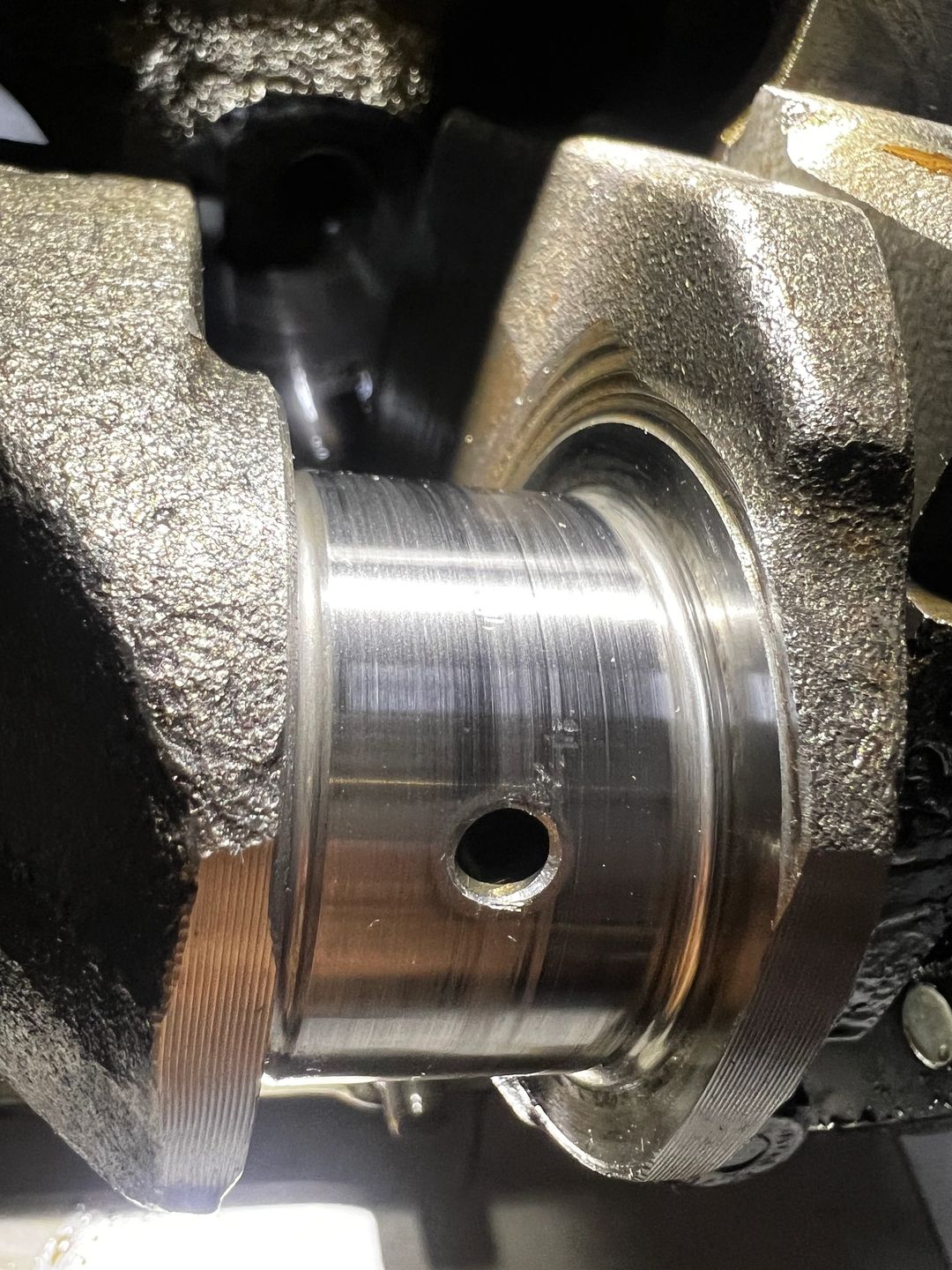

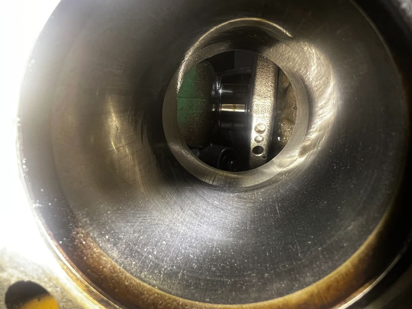

Bore looks clean
Two parts to ring land snapped off
Head and gasket clean
Bit of damage on big end. Might be due to the gearbox going 200 miles ago and a bit of that getting into the oil ways.
