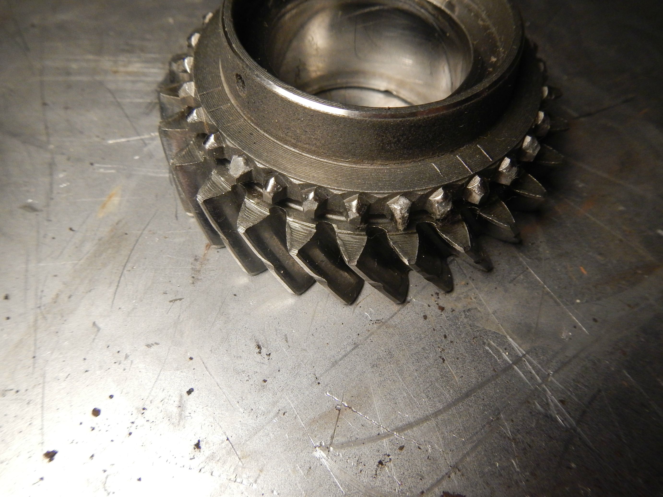

Long overdue photo update for you all:

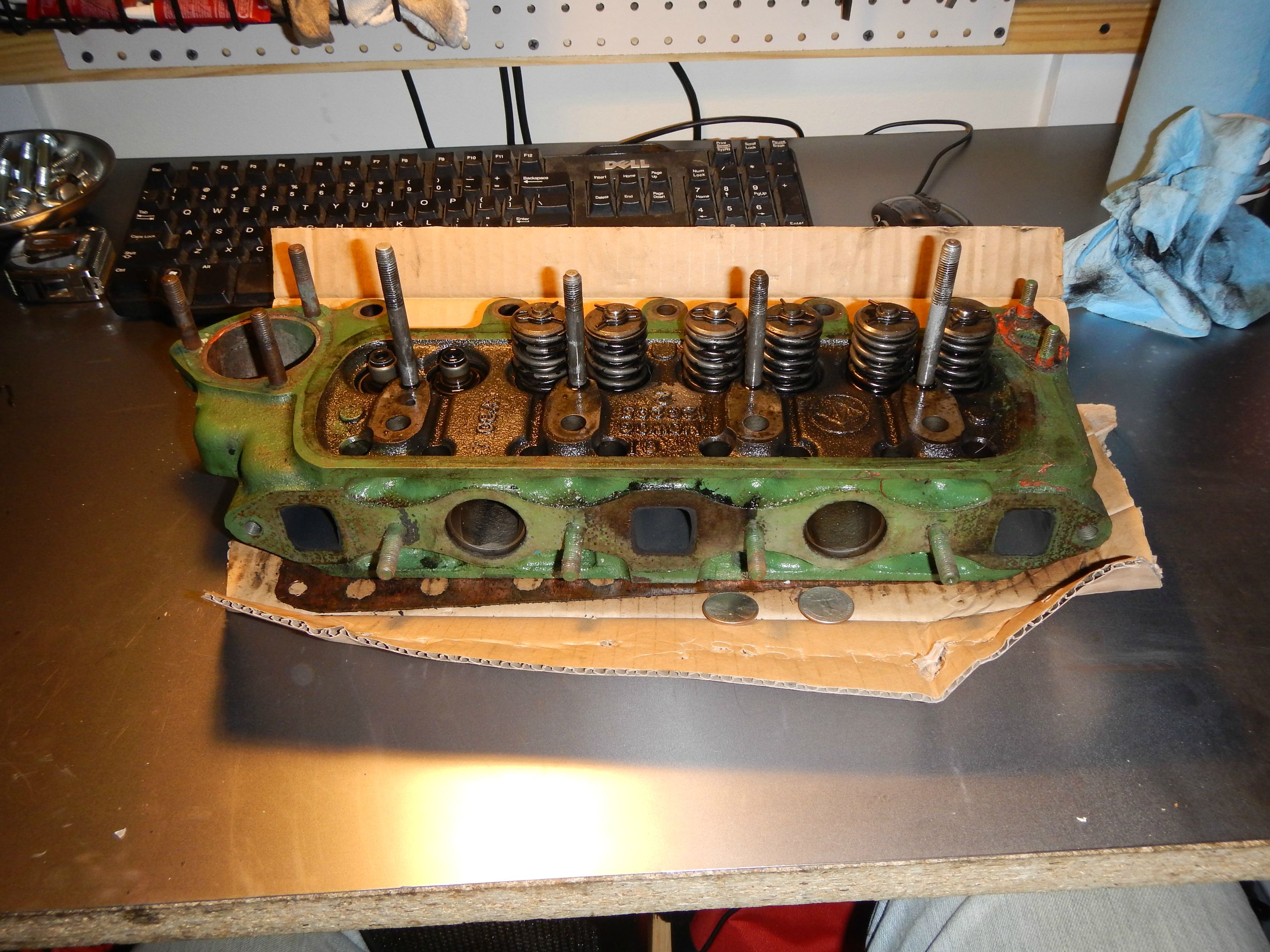

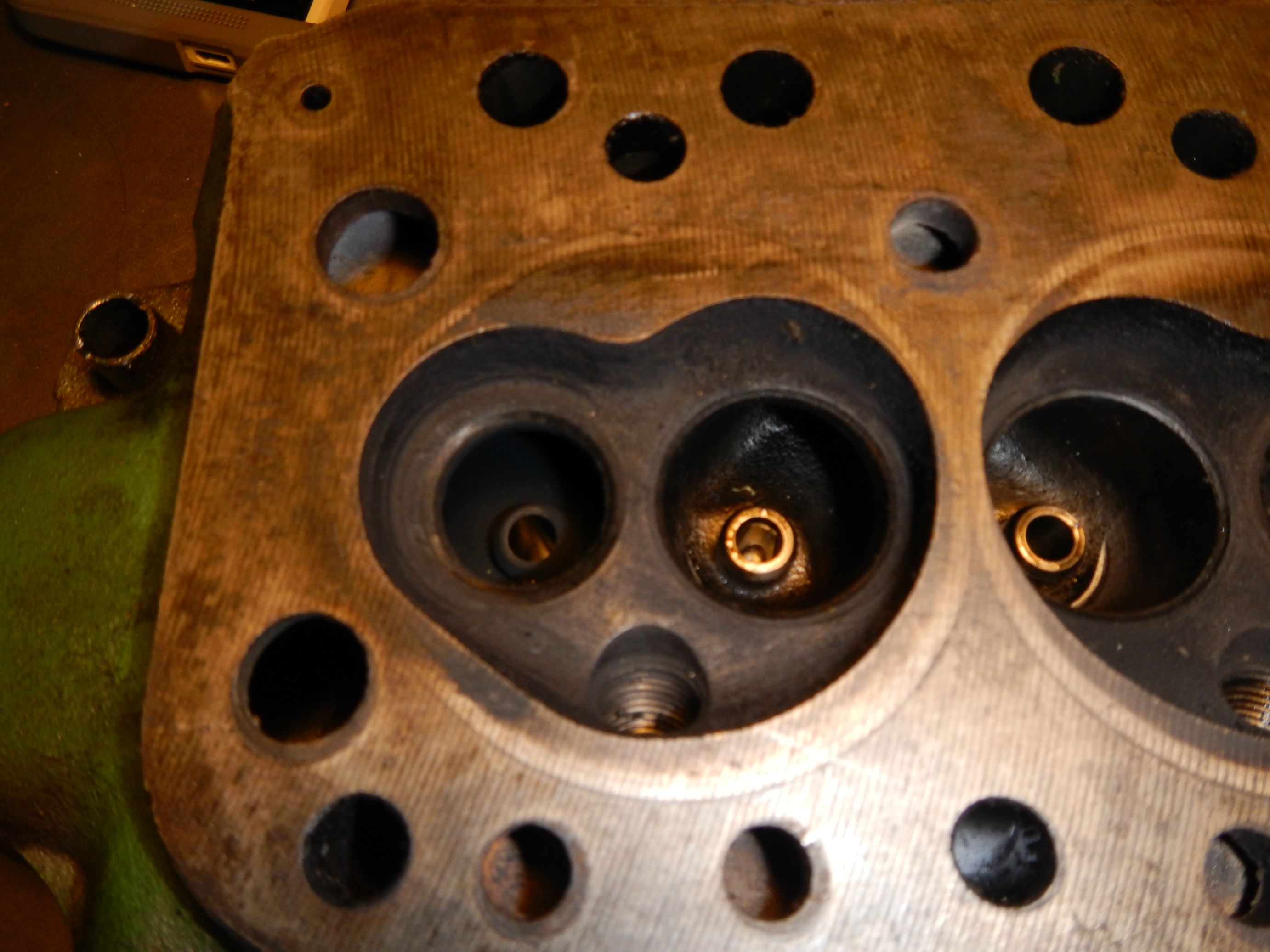

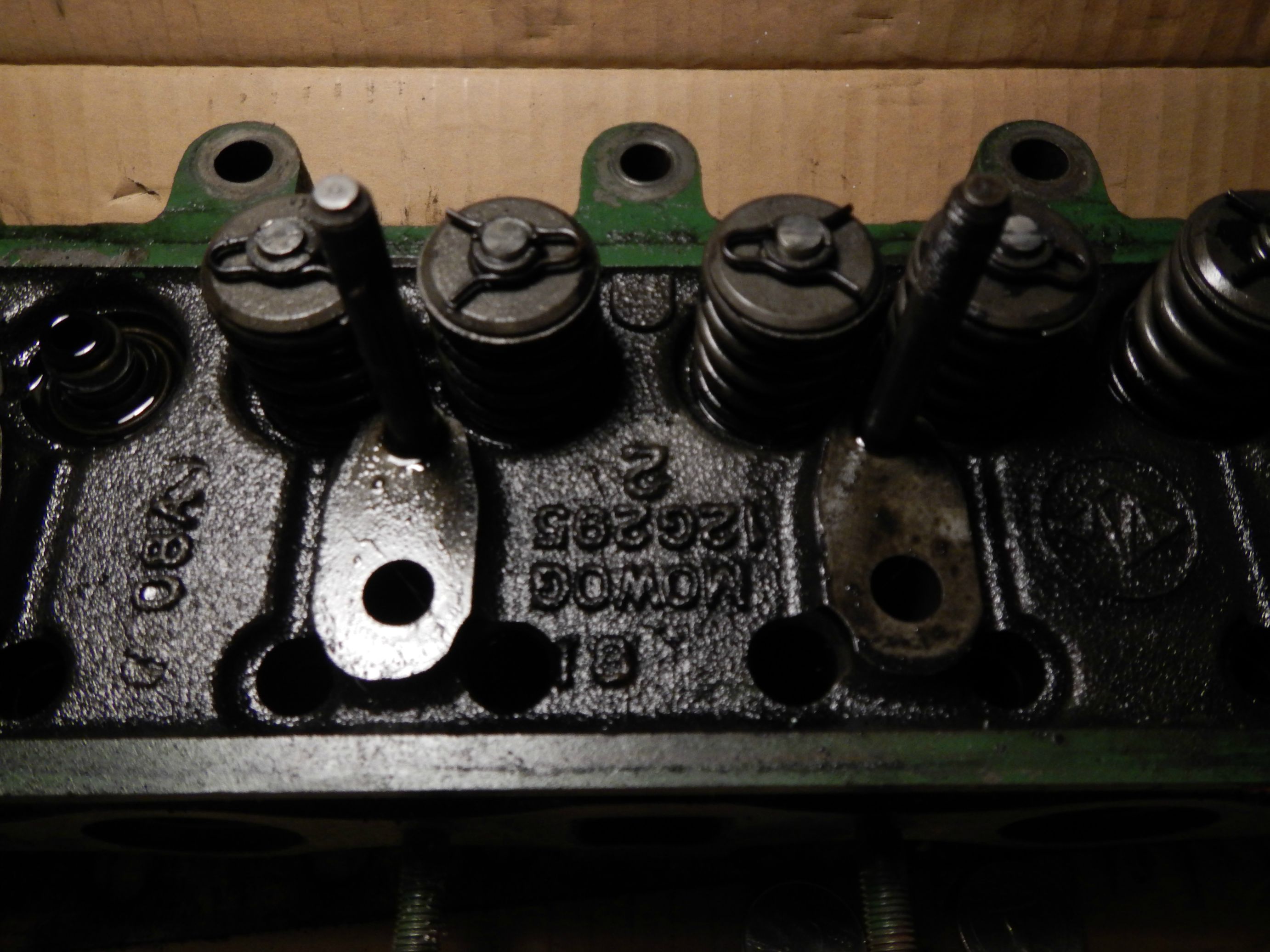

Head:

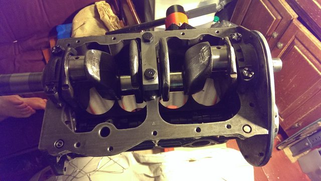

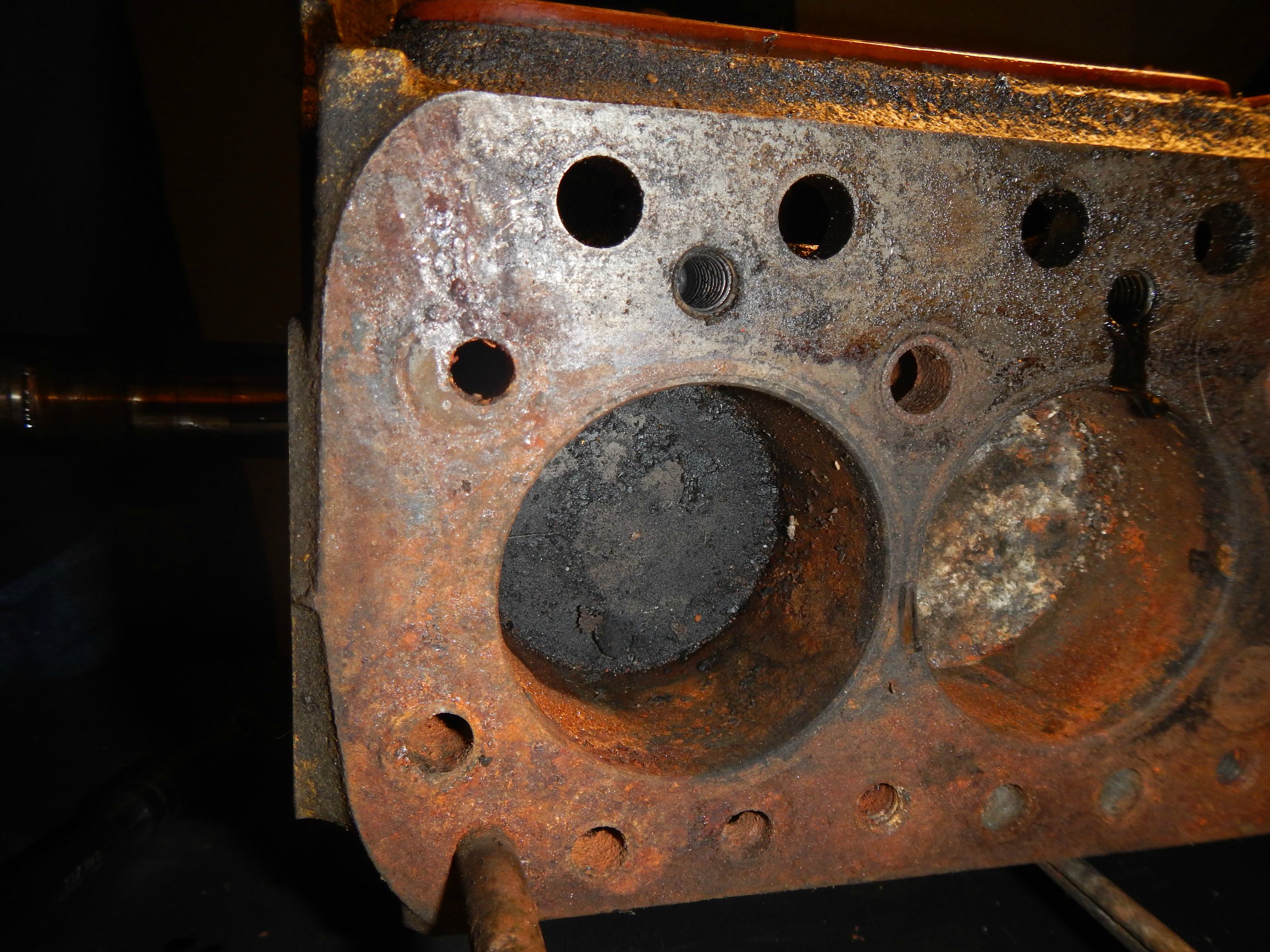

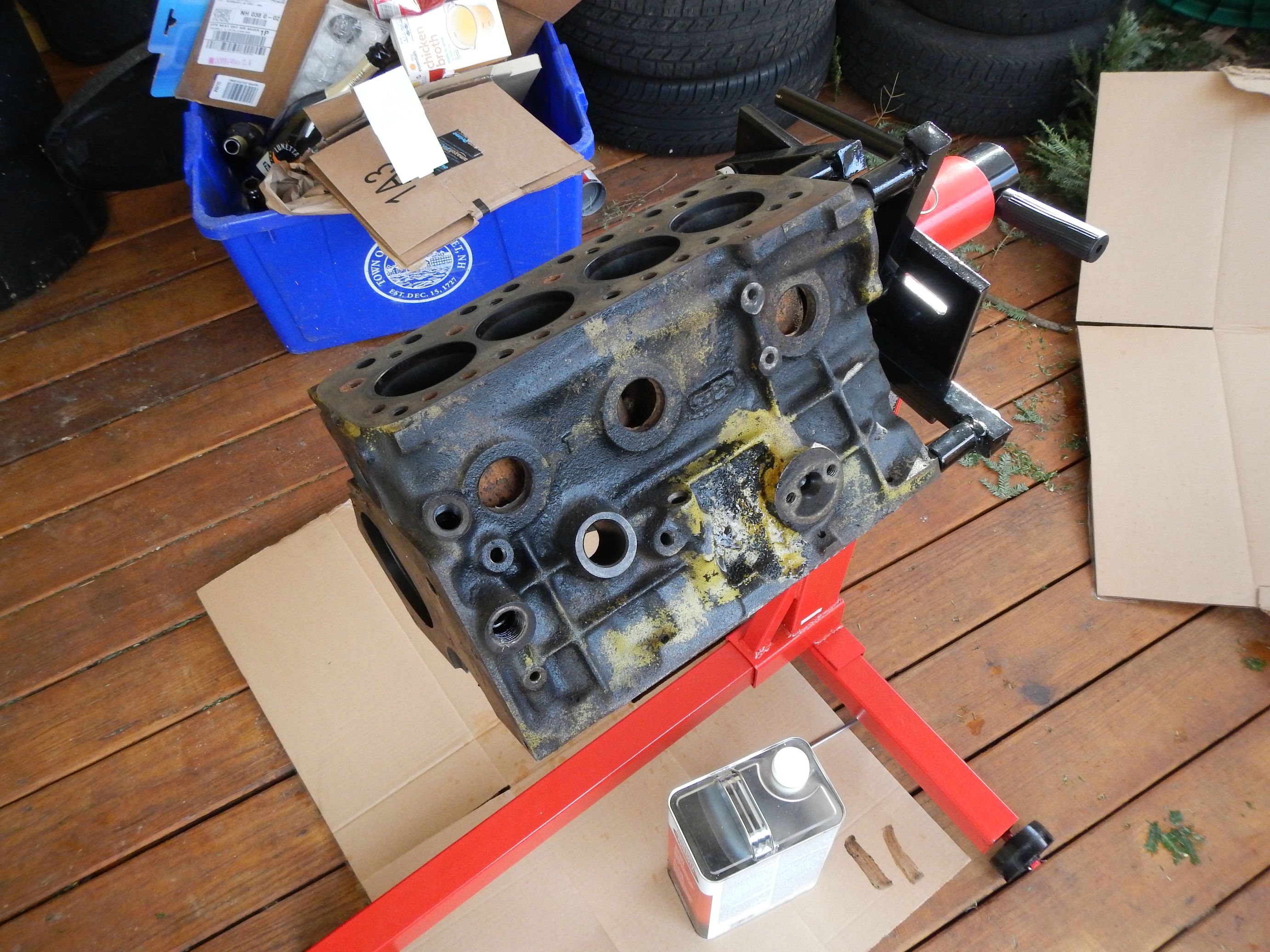

Stripping the block:
Scrap block for the crank, you think these bores are okay? :)

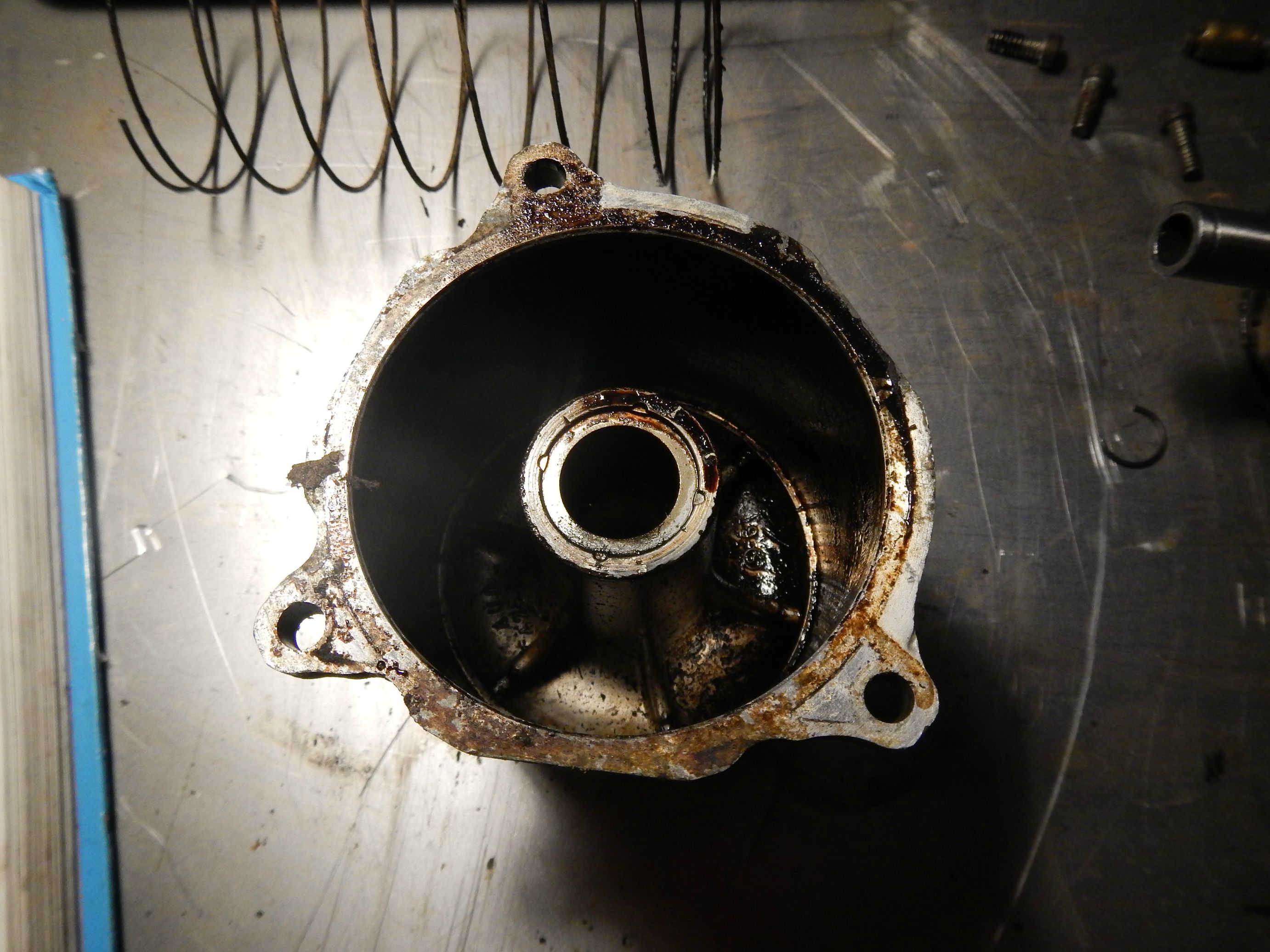

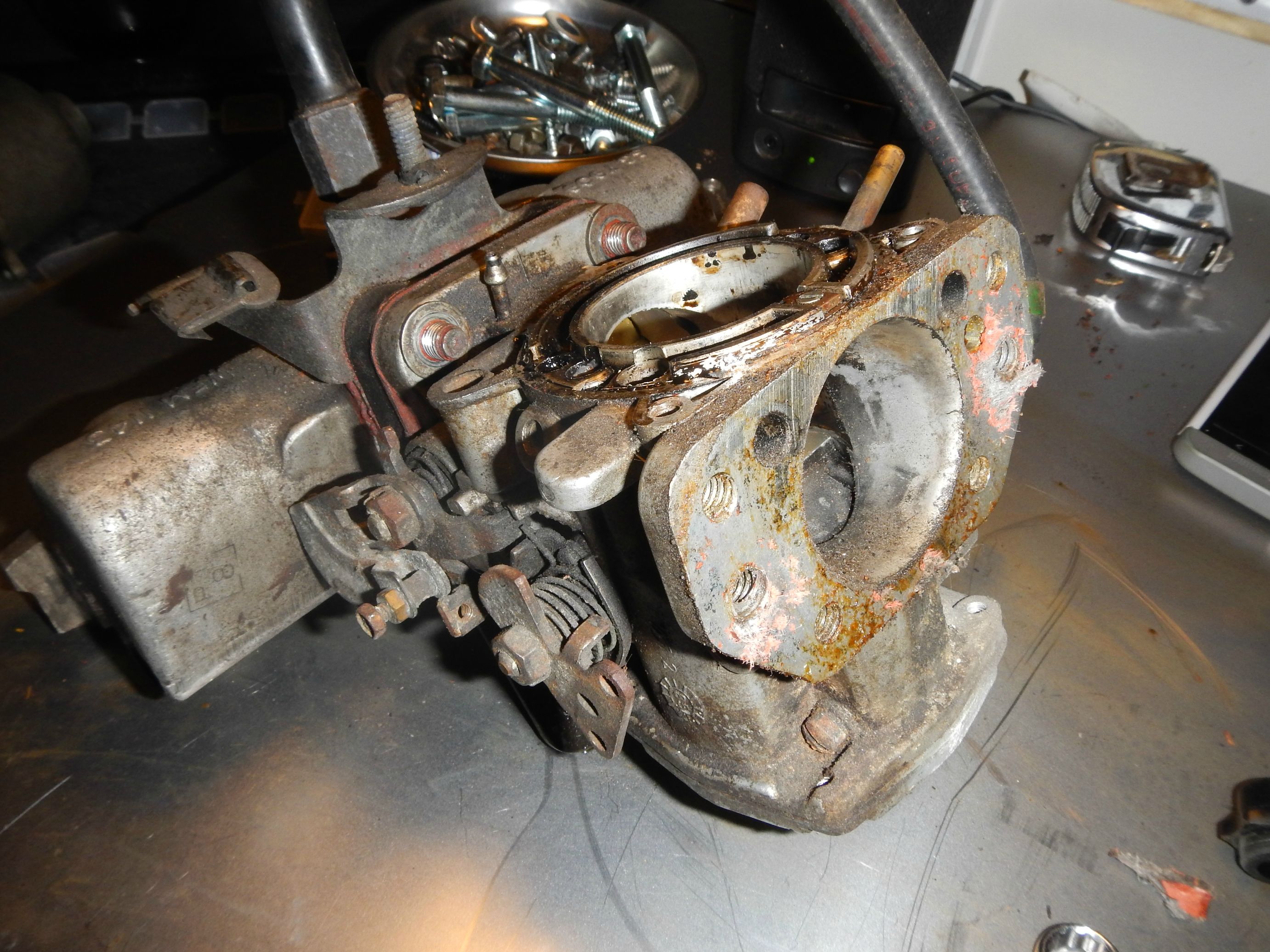

Carb, also needed some TLC

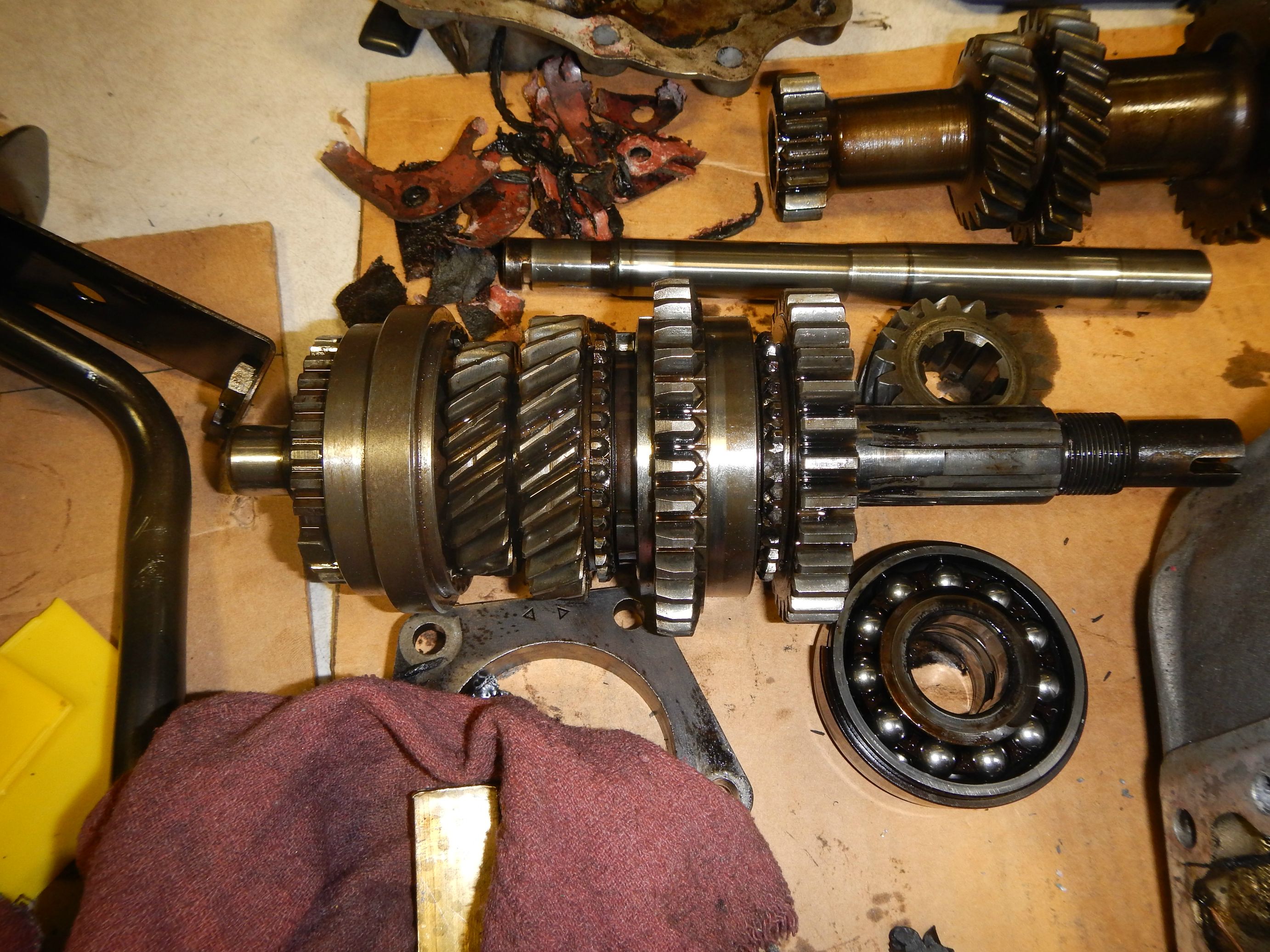

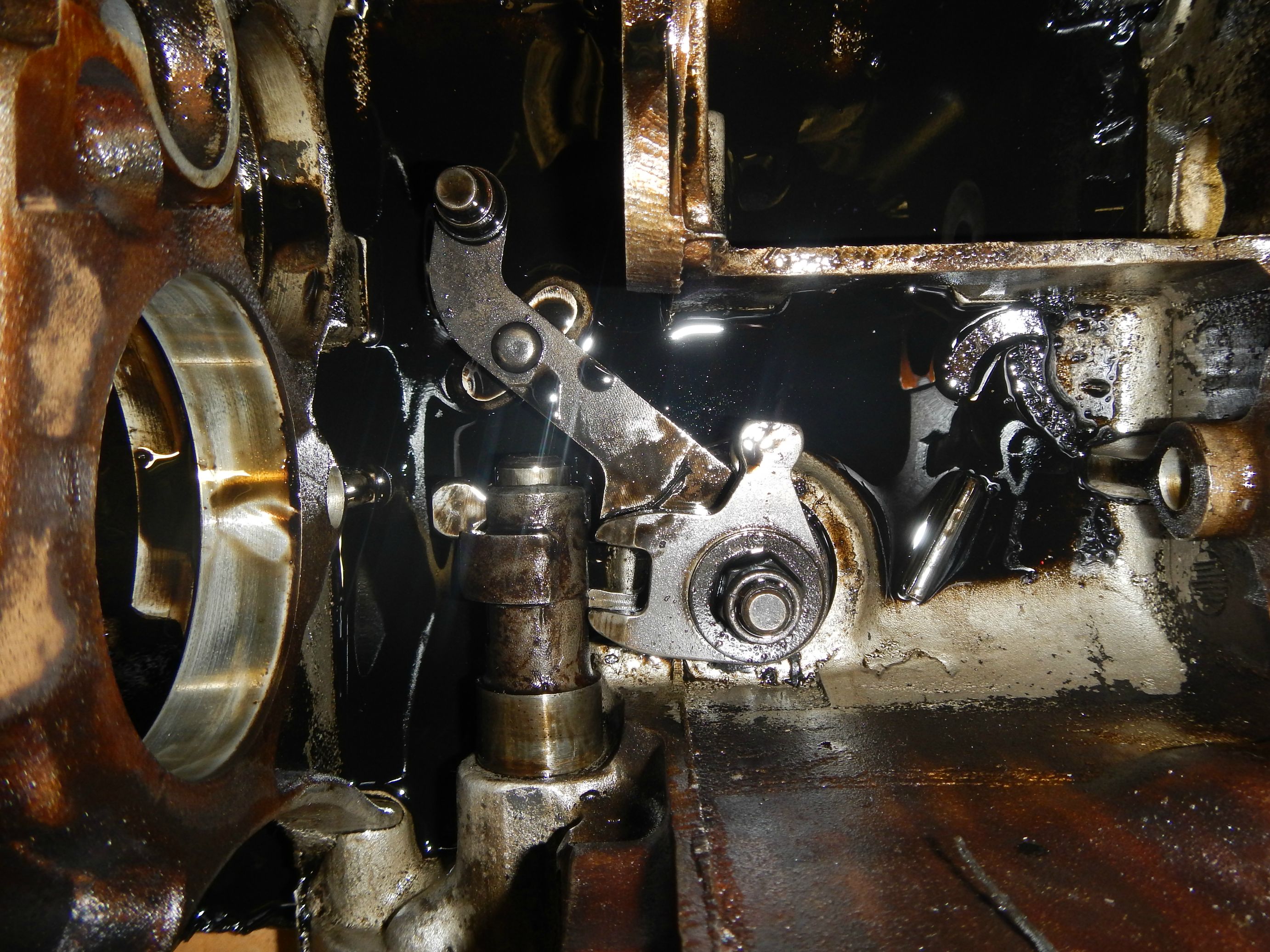

Mainshaft out
Gross gearbox sludge

Those 12G295 heads always amazed me as to how the factory could have a head casting with a great chamber profile, adequately sized valves, and good flowing ports like that, and then go ahead and use the restrictive pos on standard minis.
IIRC, the stock 998 is like 39hp, and the 998 coopers were 55hp. The 41% increase makes the 14% difference between the MG metro and stock 1275 seem very pale by comparison...

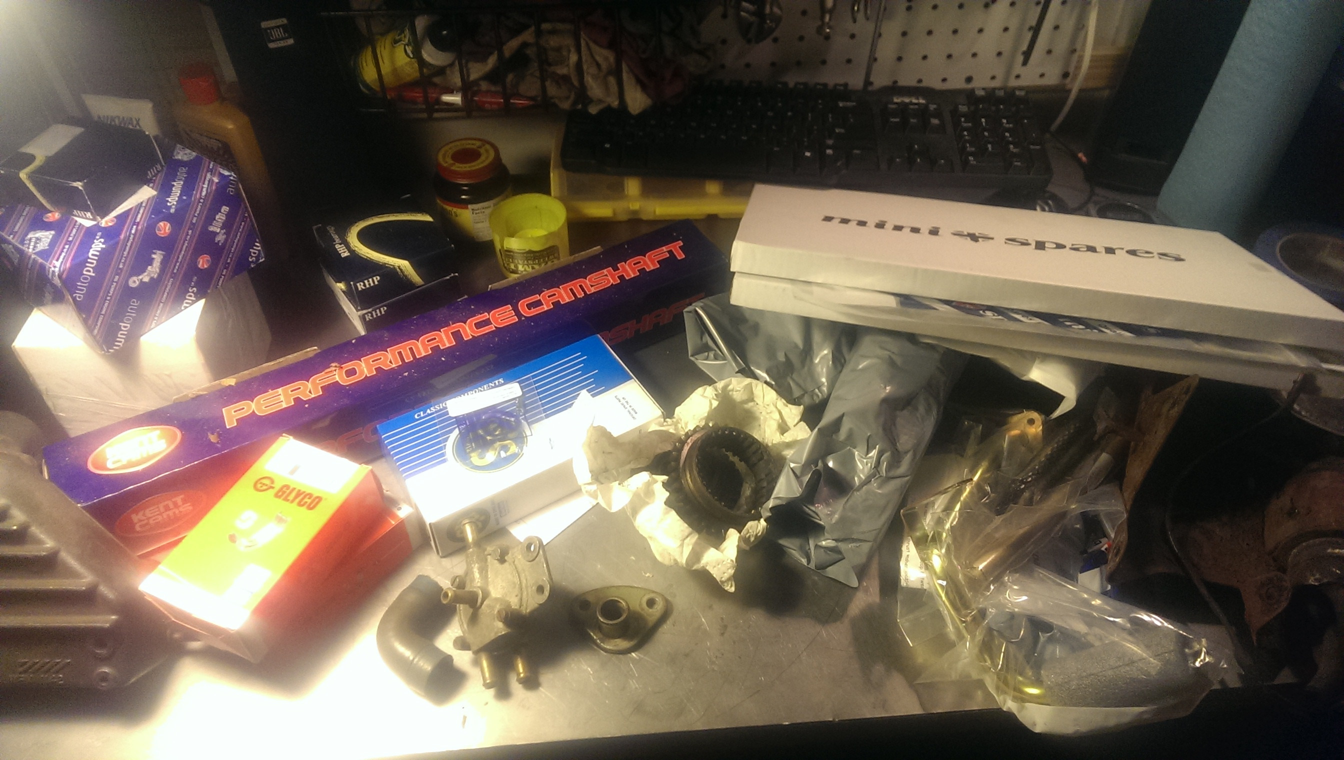

In Mini related news, I'm a bit slow in getting started after my trip but I've gotten some boxes of presents:
Dave helped me out with new (old) gears, fuel pump and other turbo bits.
Minispares helped me out with a x-pin diff, 274 cam, turbo oil pump, bearings, gearbox rebuild kit, gaskets and tons of bits and bobs.

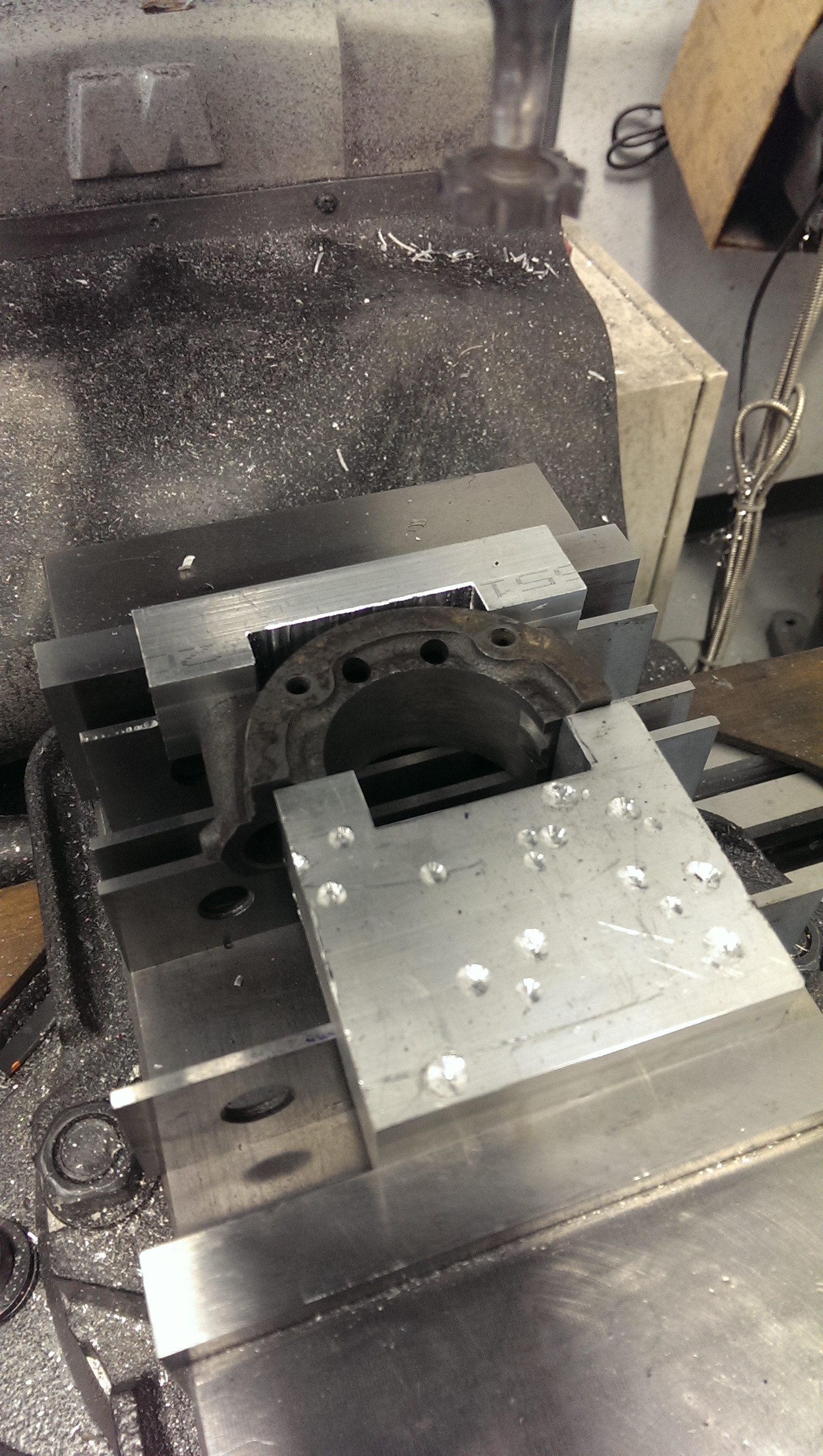

I still need to modify the end caps:
Paul: what size seat cutter did you use for modify the caps?
I used a Woodruf key cutter no. 610 in the mill
4310 Posts

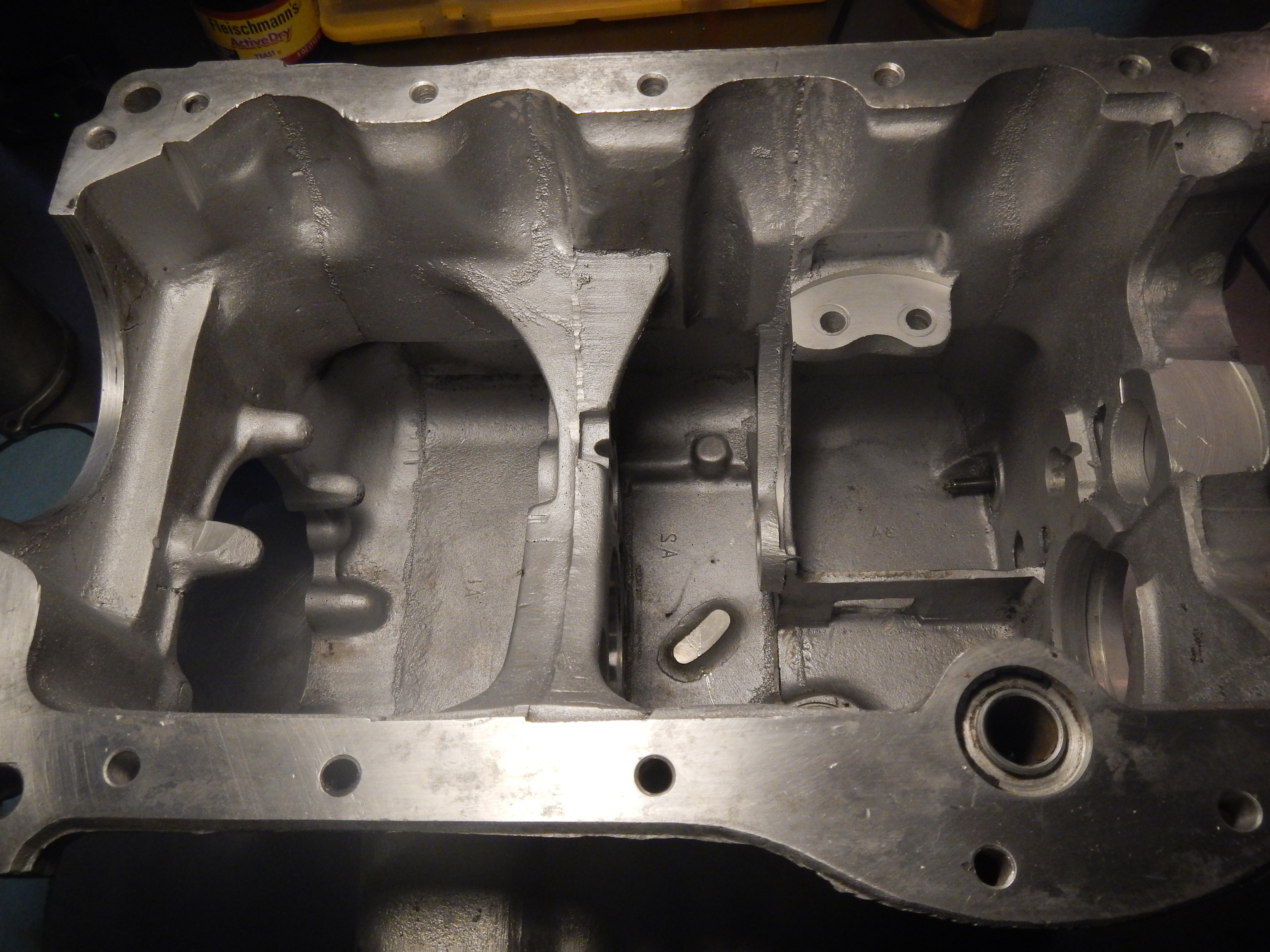

Just looking at the gearbox case it would be worth polishing out that casting imperfection above the centre web. I had one fail though there.

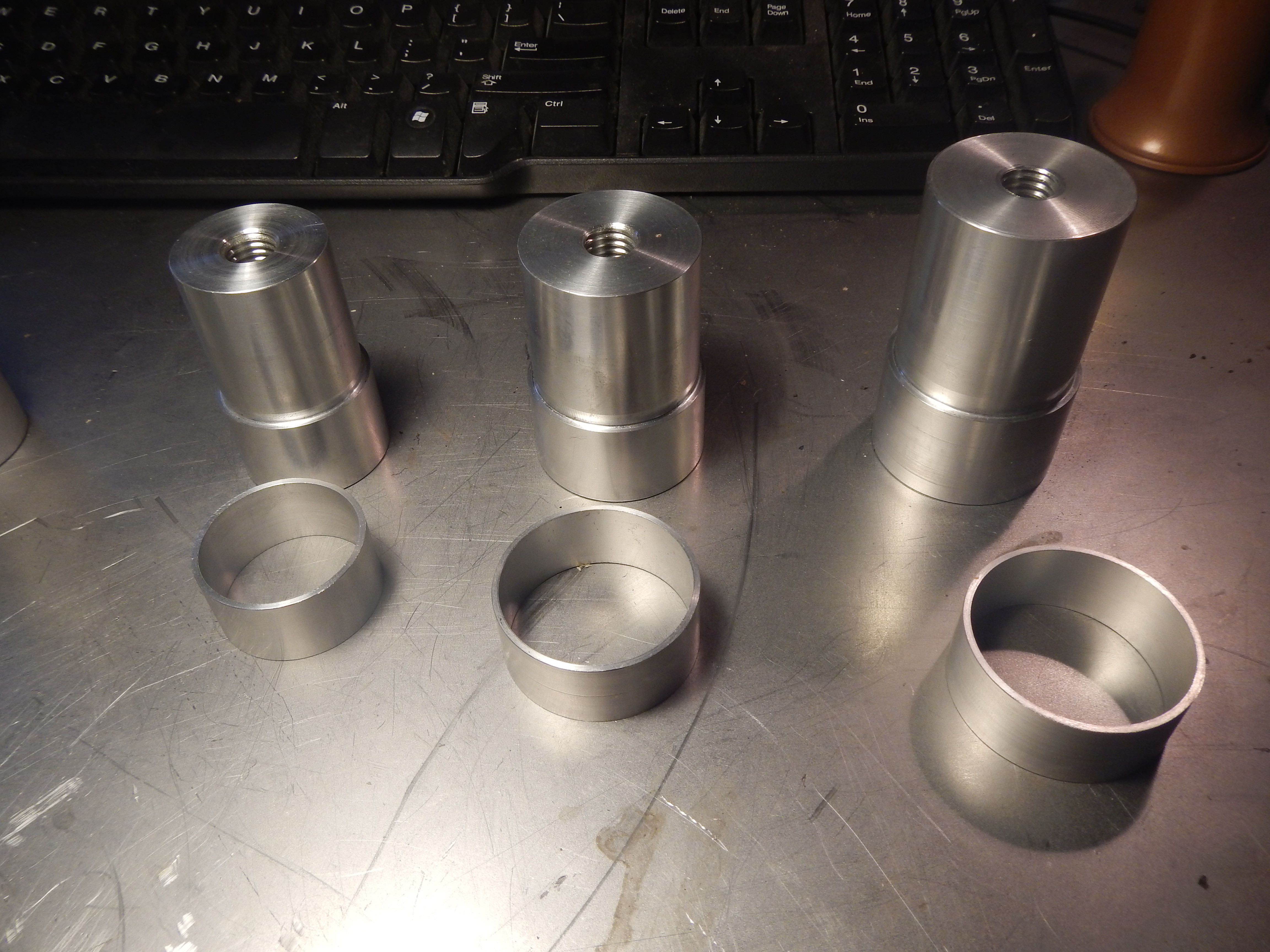

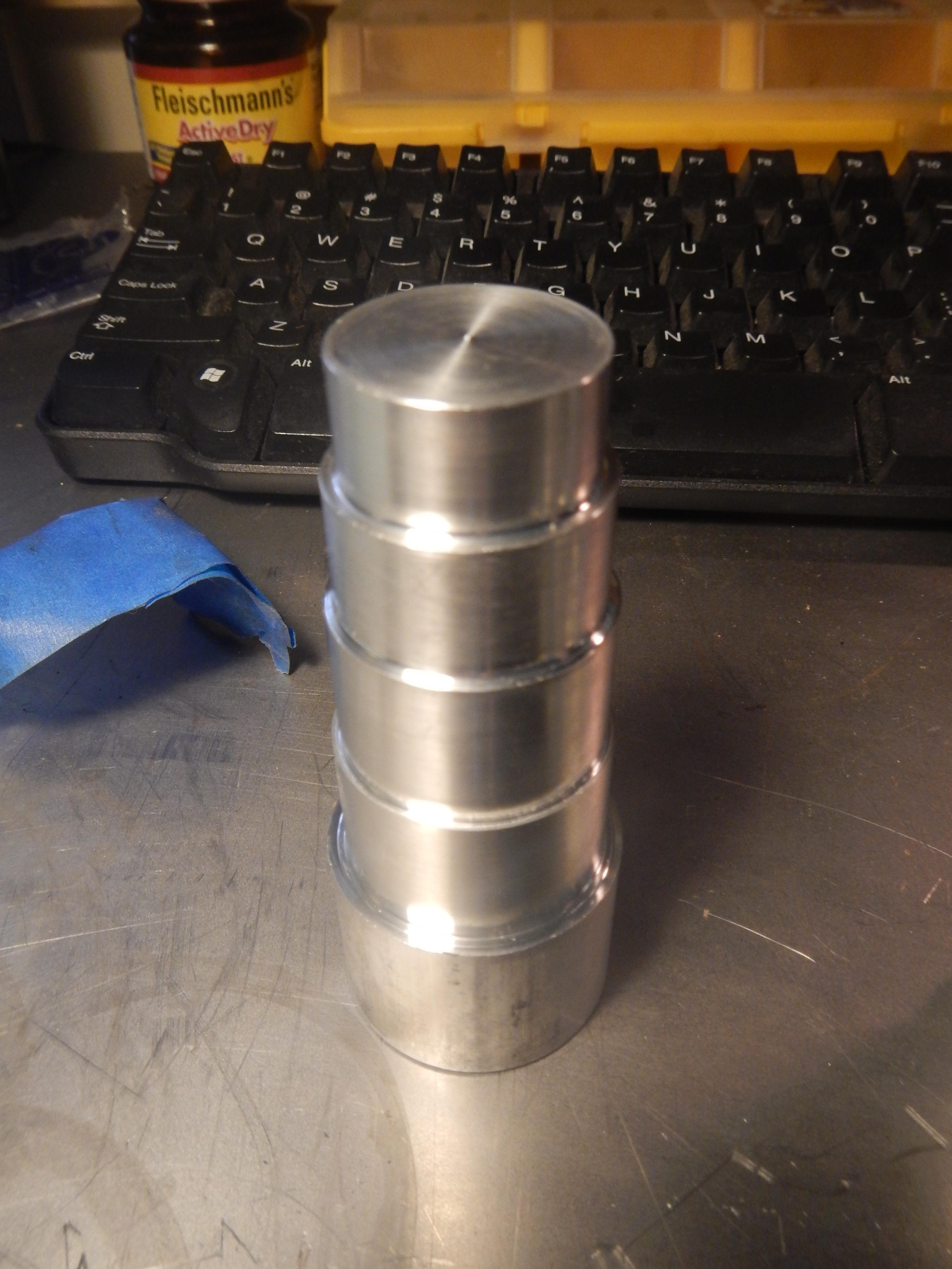

I've been spending a lot of time making drifts and tools to help things along as and effort to make sure I don't bodge anything:
Camshaft bearing presses from these plans:
http://www.3dcontentcentral.com/download-m...d=171&id=423572
Essentially a drift with a tapped hole up the middle with a sleeve for alignment. The plans called for threads all the way through which is pretty insano on a 3" piece. I shortened the thread and drilled clearance on the back.

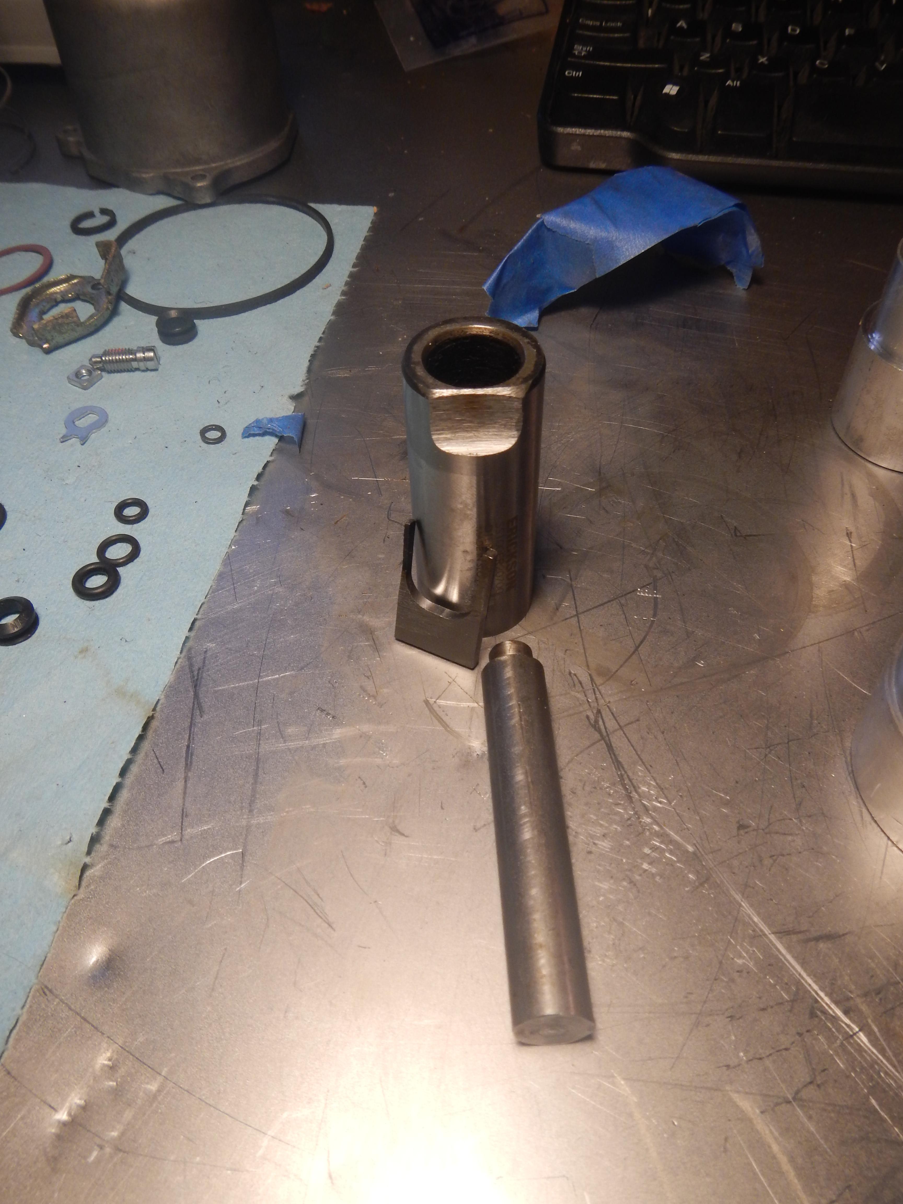

I put together this little setup for pressing out the wrist pins. The base is notched to fit into the piston, the flat stock is used to fill the gap so that the piston doesn't get crushed and the pin fits into the wrist pin. I think the press got up to 5 tons before it broke the fit.

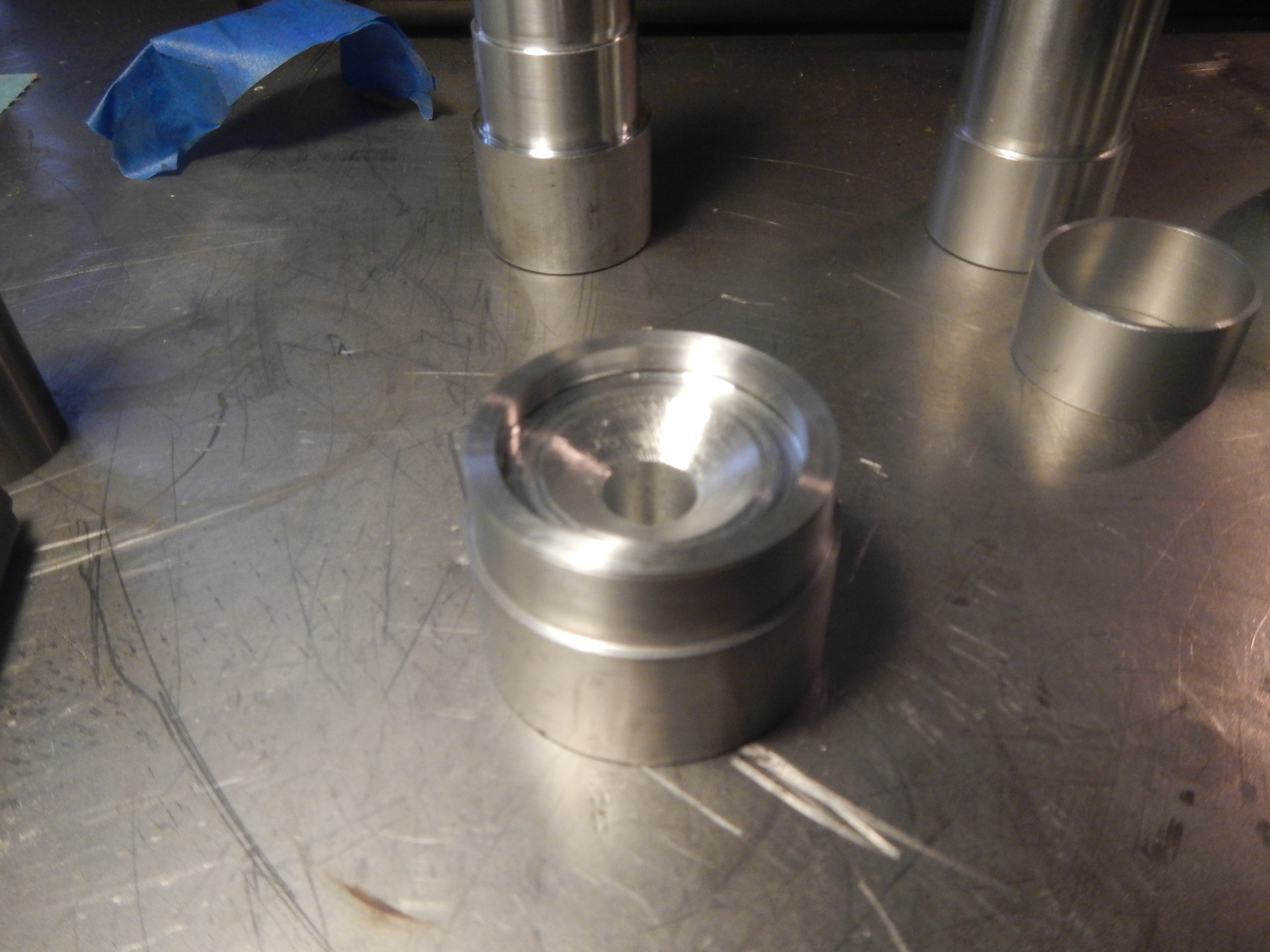

This is a press for the diff oil seals:
And this is a combo press for the diff and final drive gear bushings:

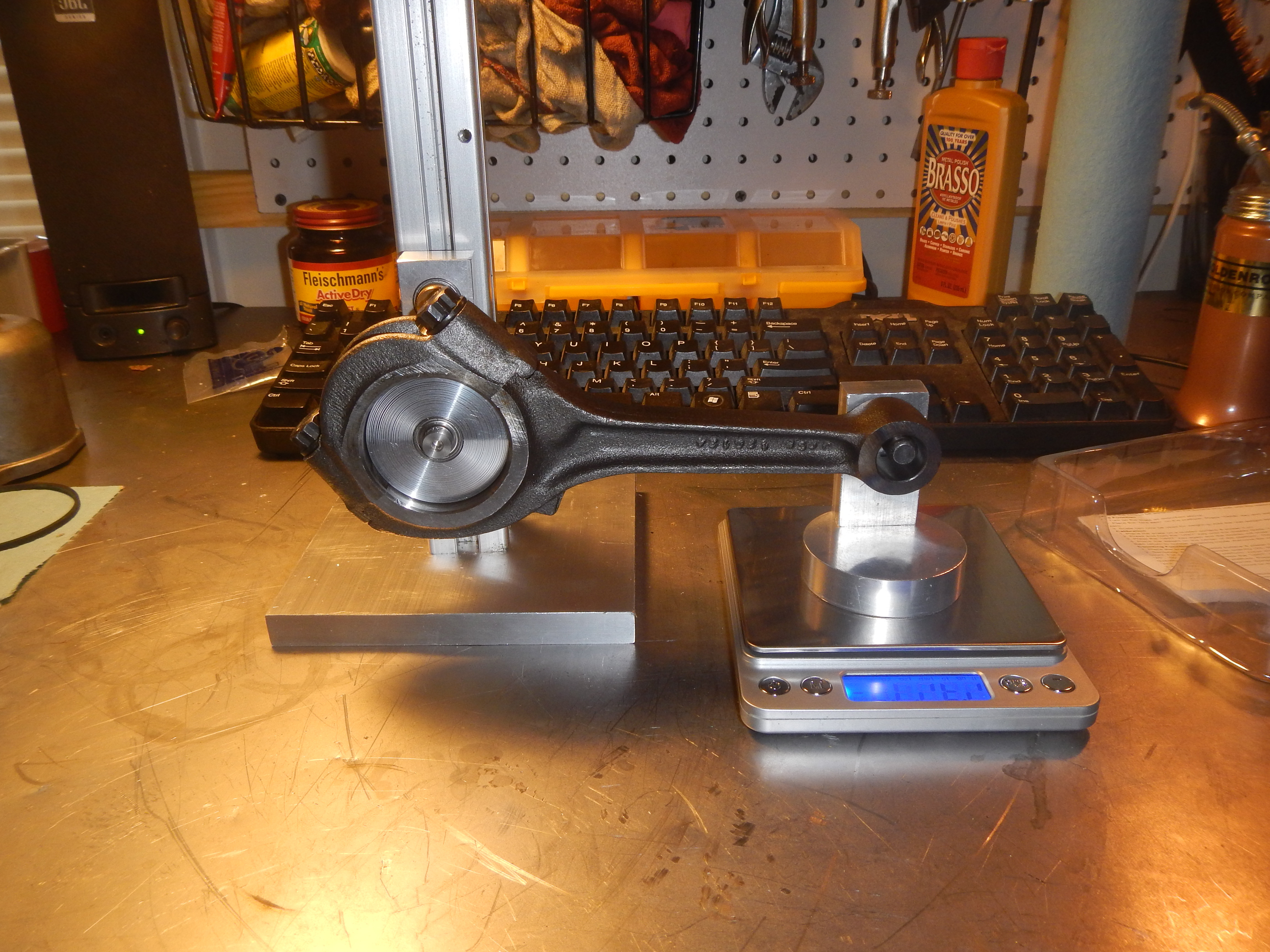

I also made a connecting rod balancing stand which you can read about here:
http://www.turbominis.co.uk/forums/index.php?p=vt&tid=556328

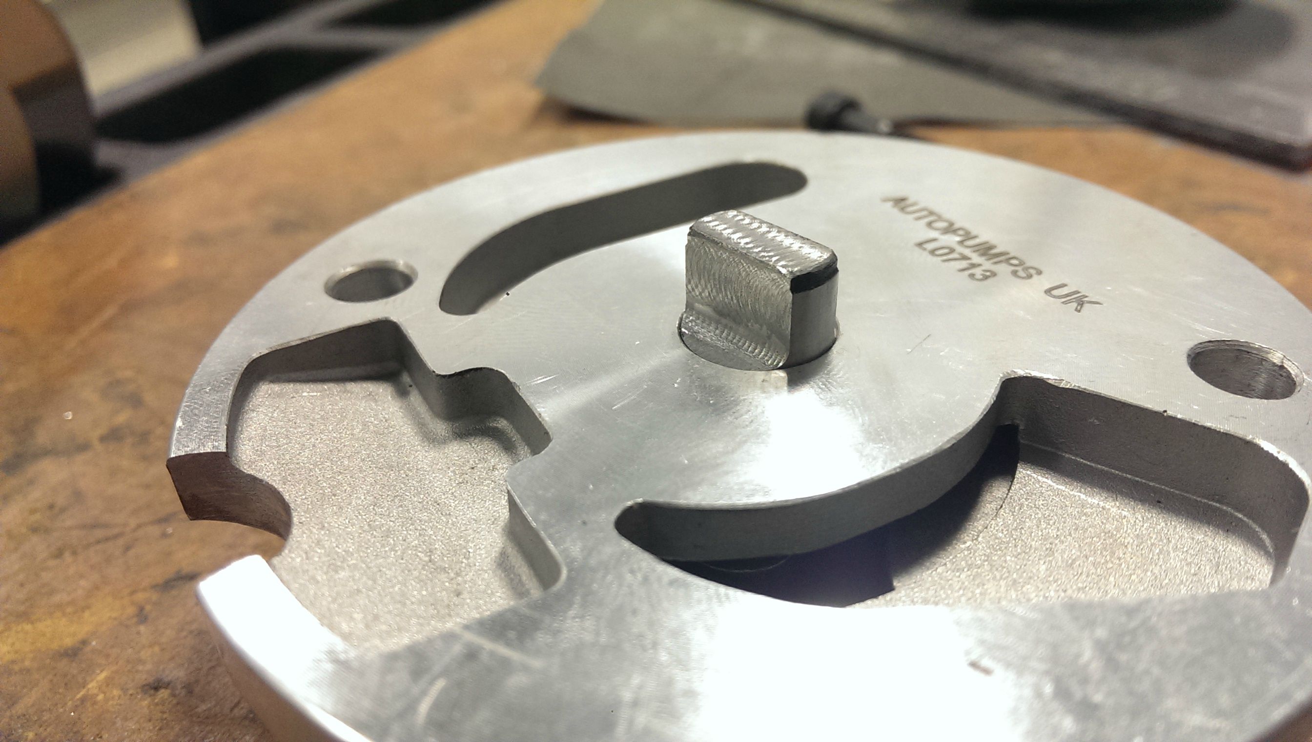

I also modified my oil pump shaft to fit the turbo pump in the 998 block. You can read about that here:
http://www.turbominis.co.uk/forums/index.php?p=vt&tid=556199

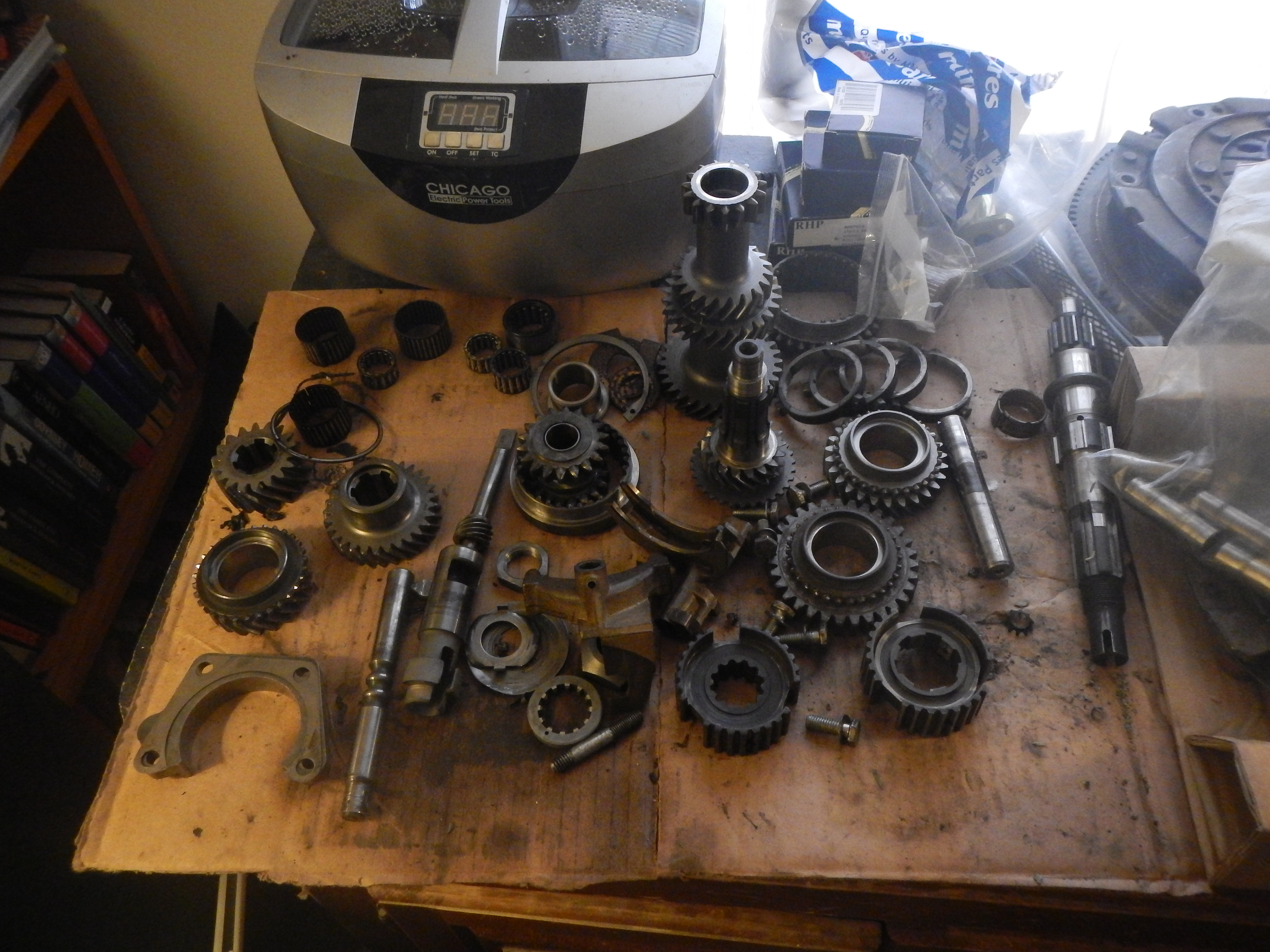

Besides time in the machine shop, I got my gearcase soda blasted and power washed and ready to assemble. I'm not quite sure where it is the stress relieving was recommended though:
Thanks to Guessworks and TurboDave for getting my gears replaced:
I'll be happy for this pile to go back together:

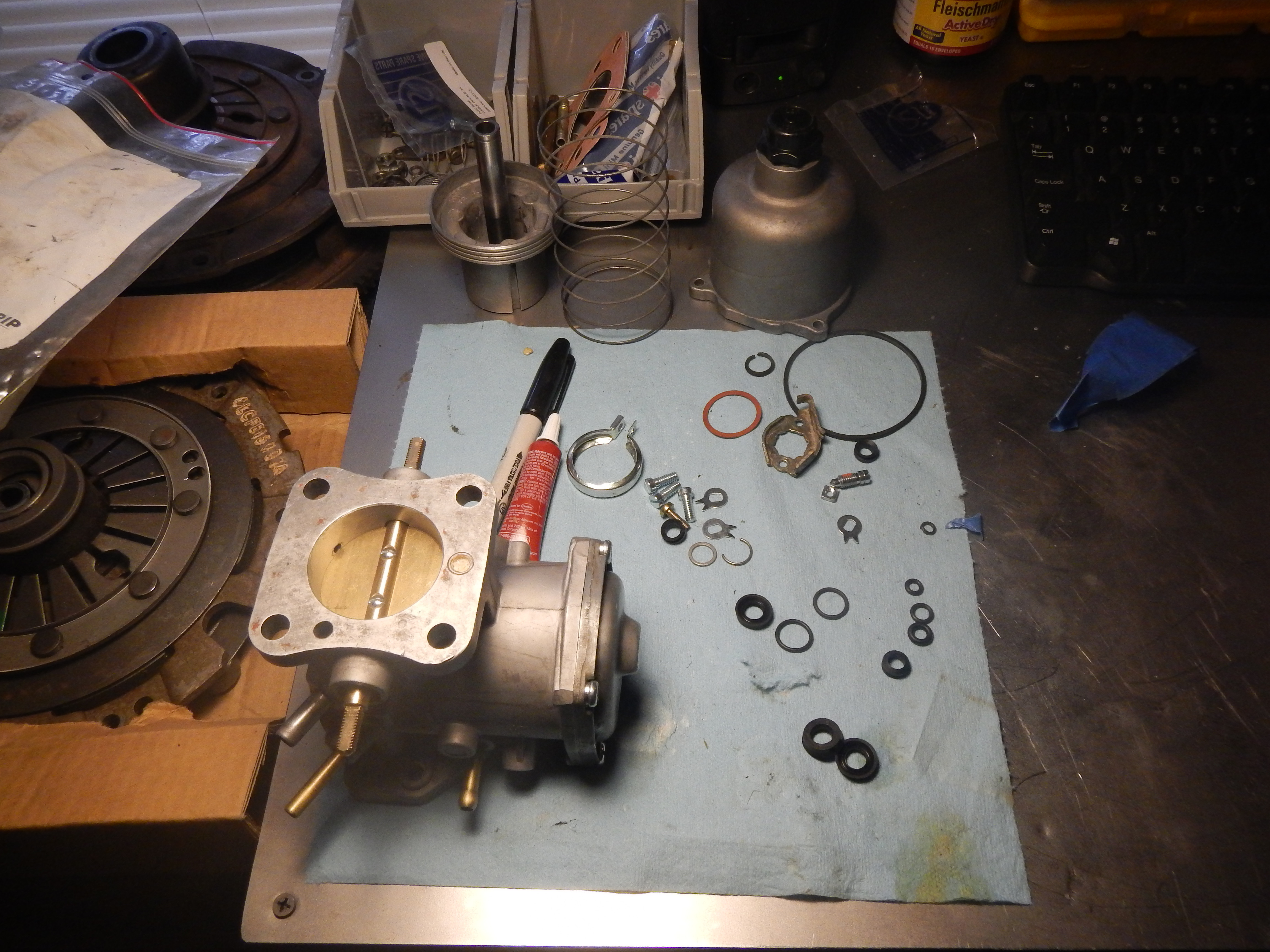

Making good progress on the carb rebuild but having issues with the white spacers and o-rings. That is here:
http://www.turbominis.co.uk/forums/index.php?p=vt&tid=556305
Thanks to all for the help. I'm really excited about the progress

I stress relieved mine everywhere. I think the most important area is above the 3rd motion shaft bearing.
Not that i have ever seen a cracked casing.

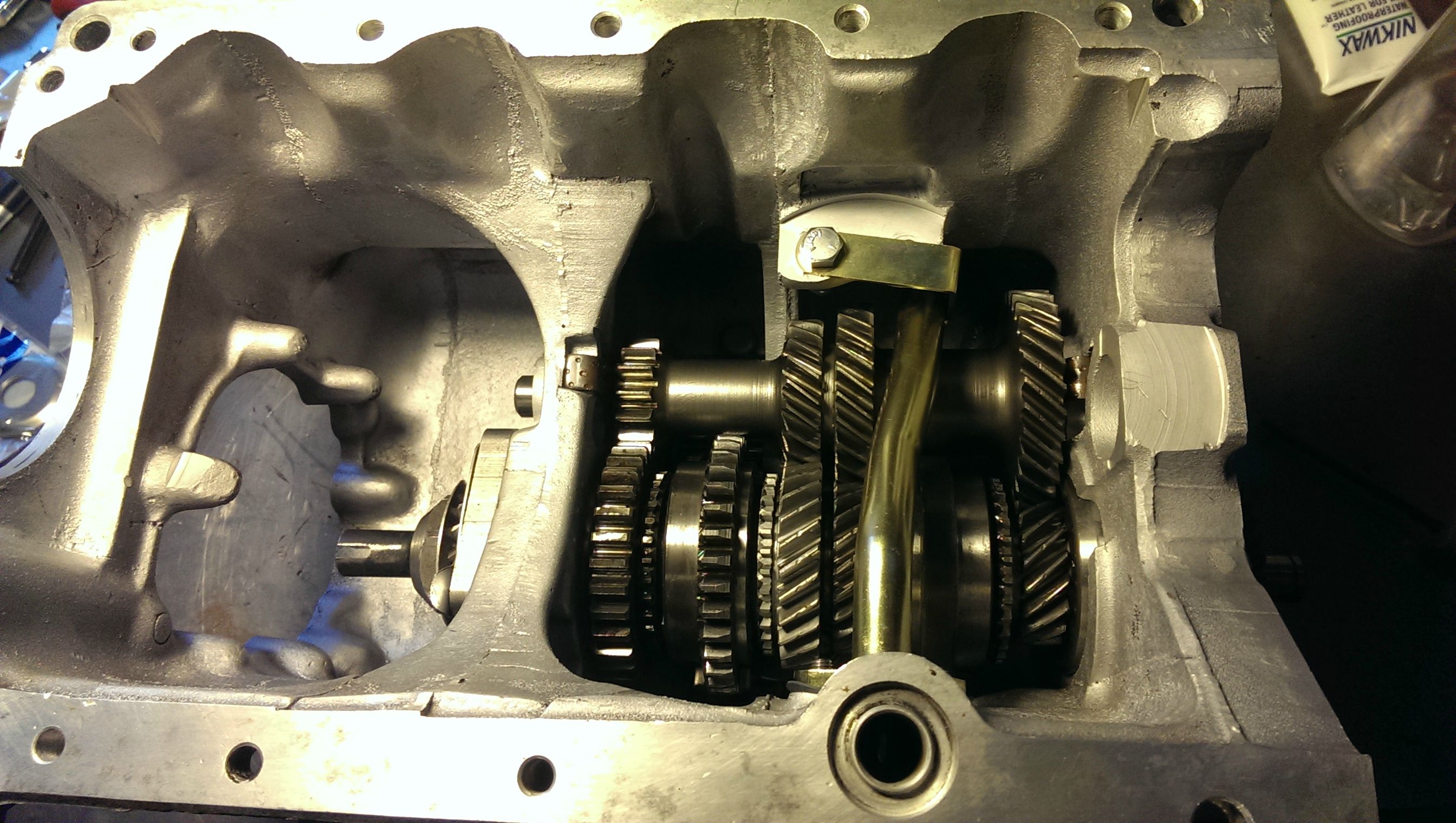

I've started putting the gearbox back together. Things are going well with this but I keep finding small bits which need replacing and that mostly just takes time.

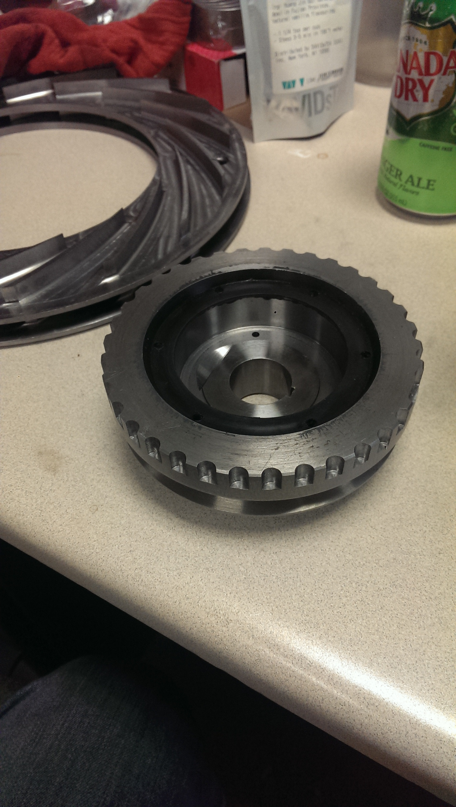

Machined the teeth into the trigger wheel. I also did this on the mill and just plunged an endmill for each slot. It was quite easy with a digital readout. Just indicated the center by the OD, locate the timing slot (I used a pin the drill spindle and jogged around until it freely slid between the part and the splindle). Take this XY and calculate the angle then use a bolt circle caclutor with this starting angle and 36 holes to get your "drill points."
Gearbox is built but still needing to sort a stripped diff case thread:

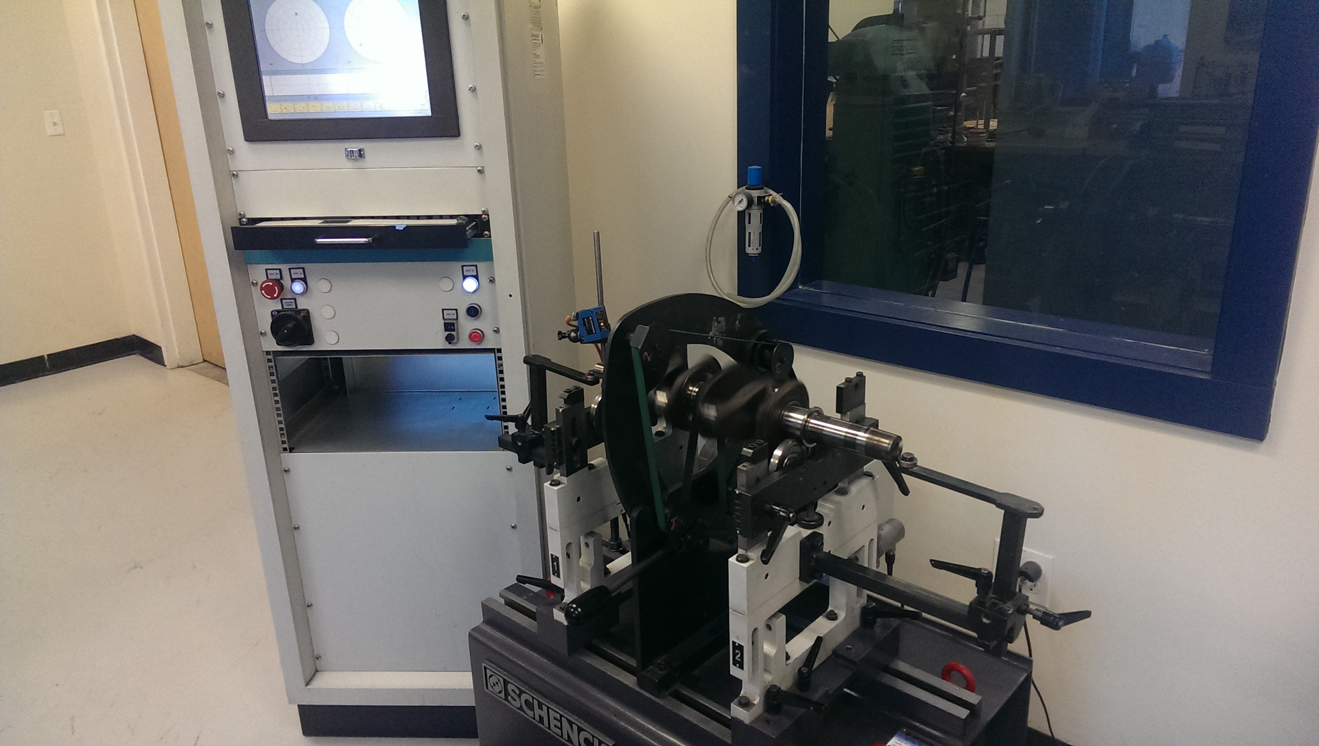

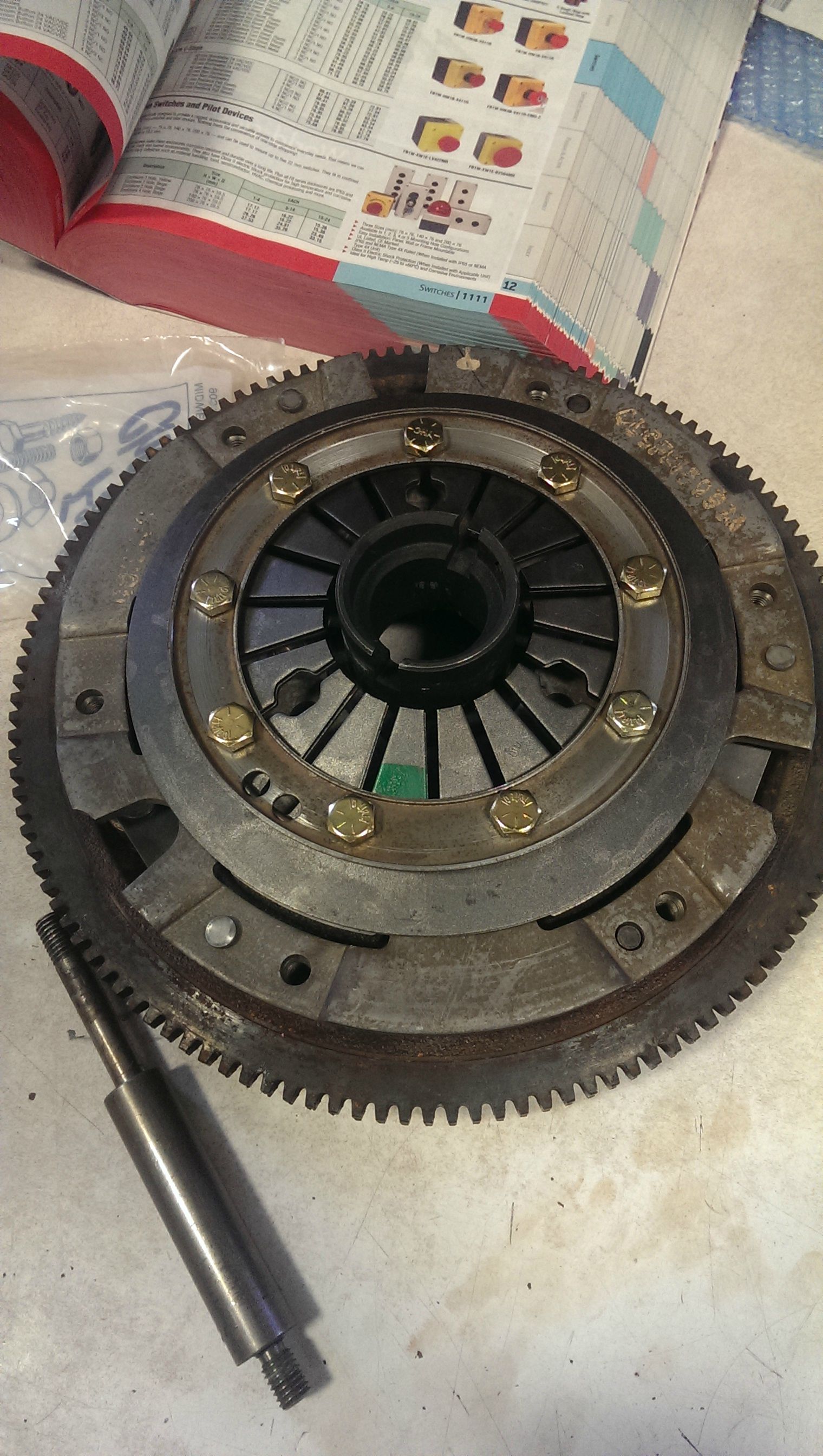

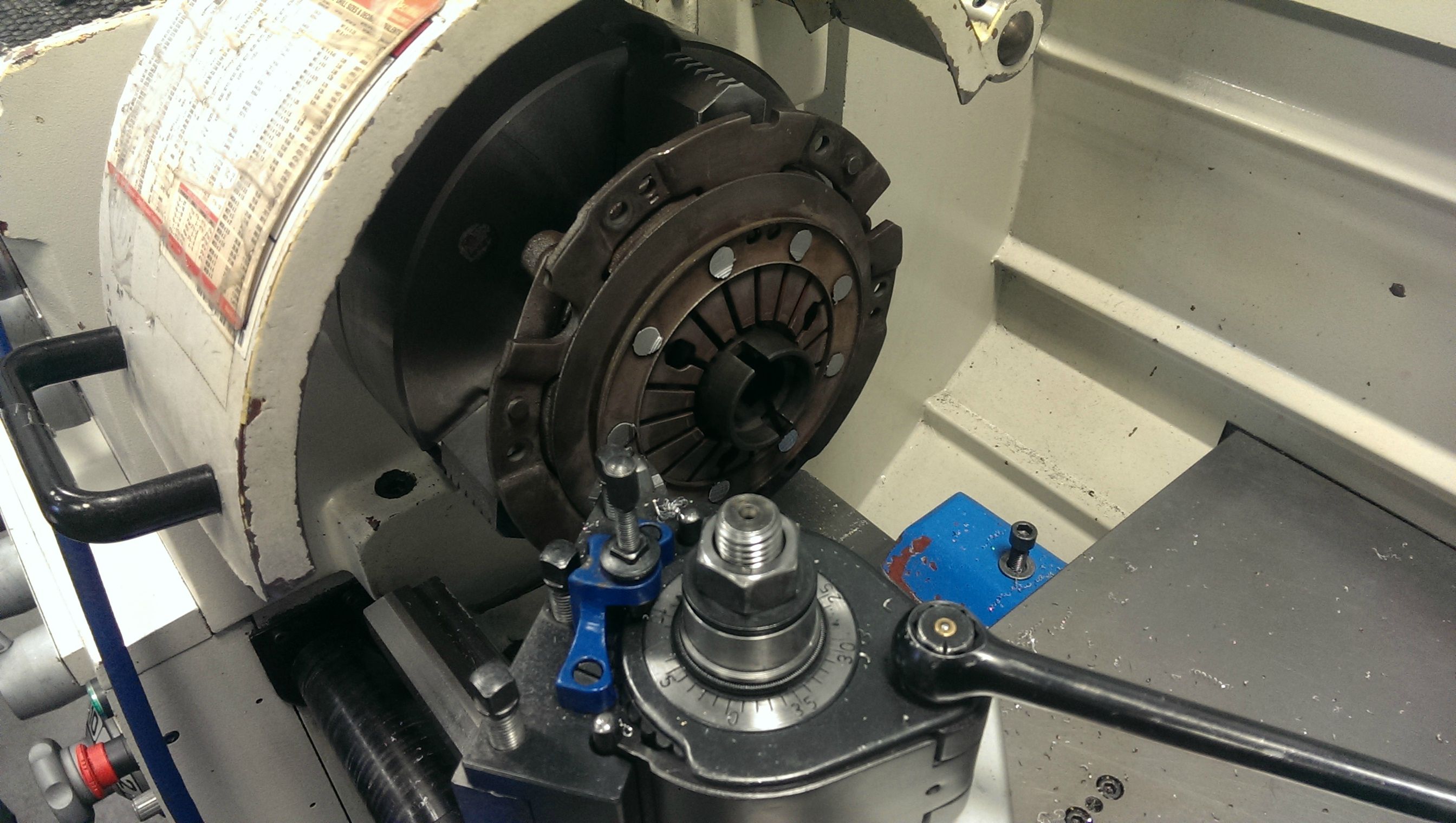

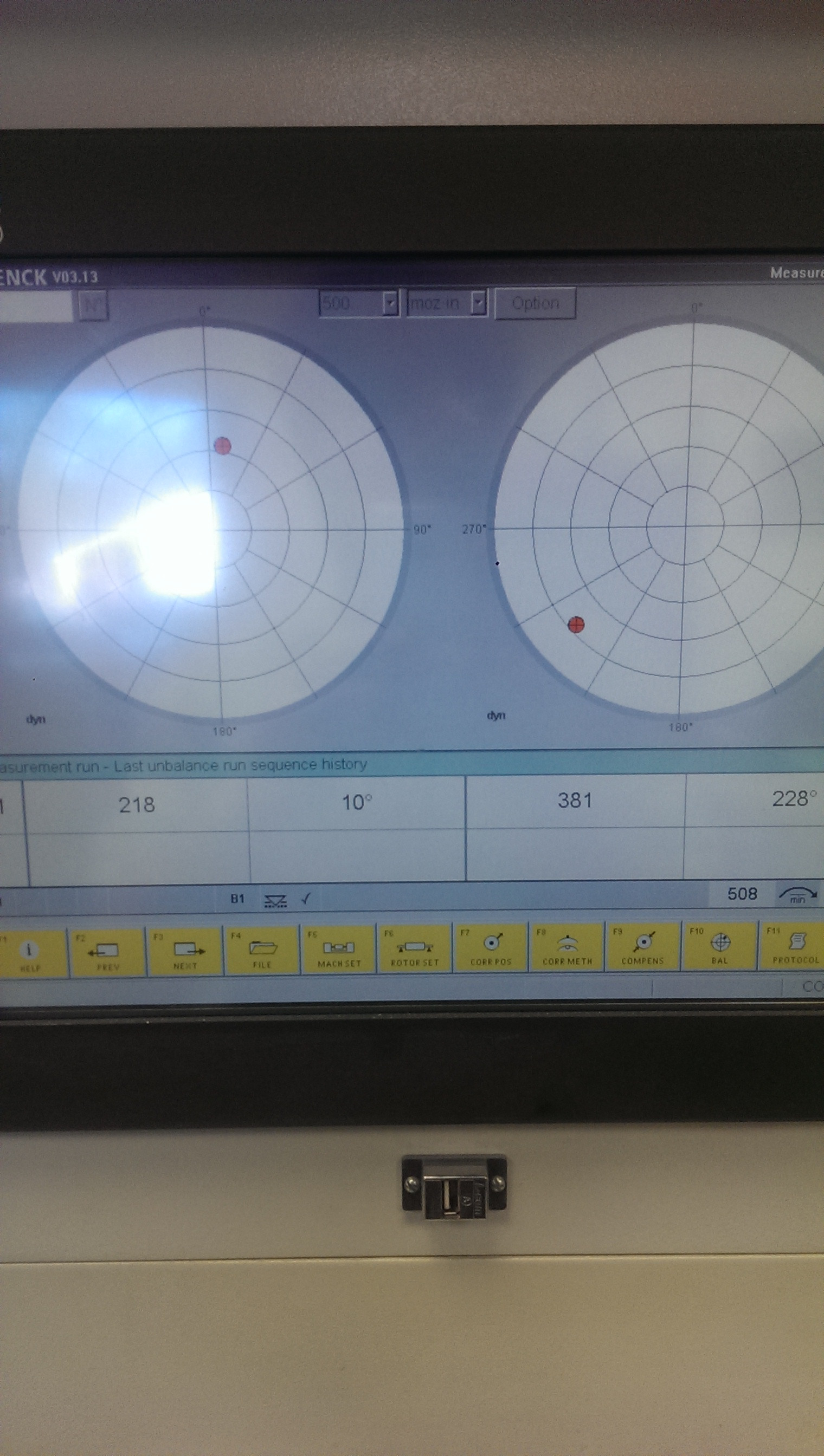

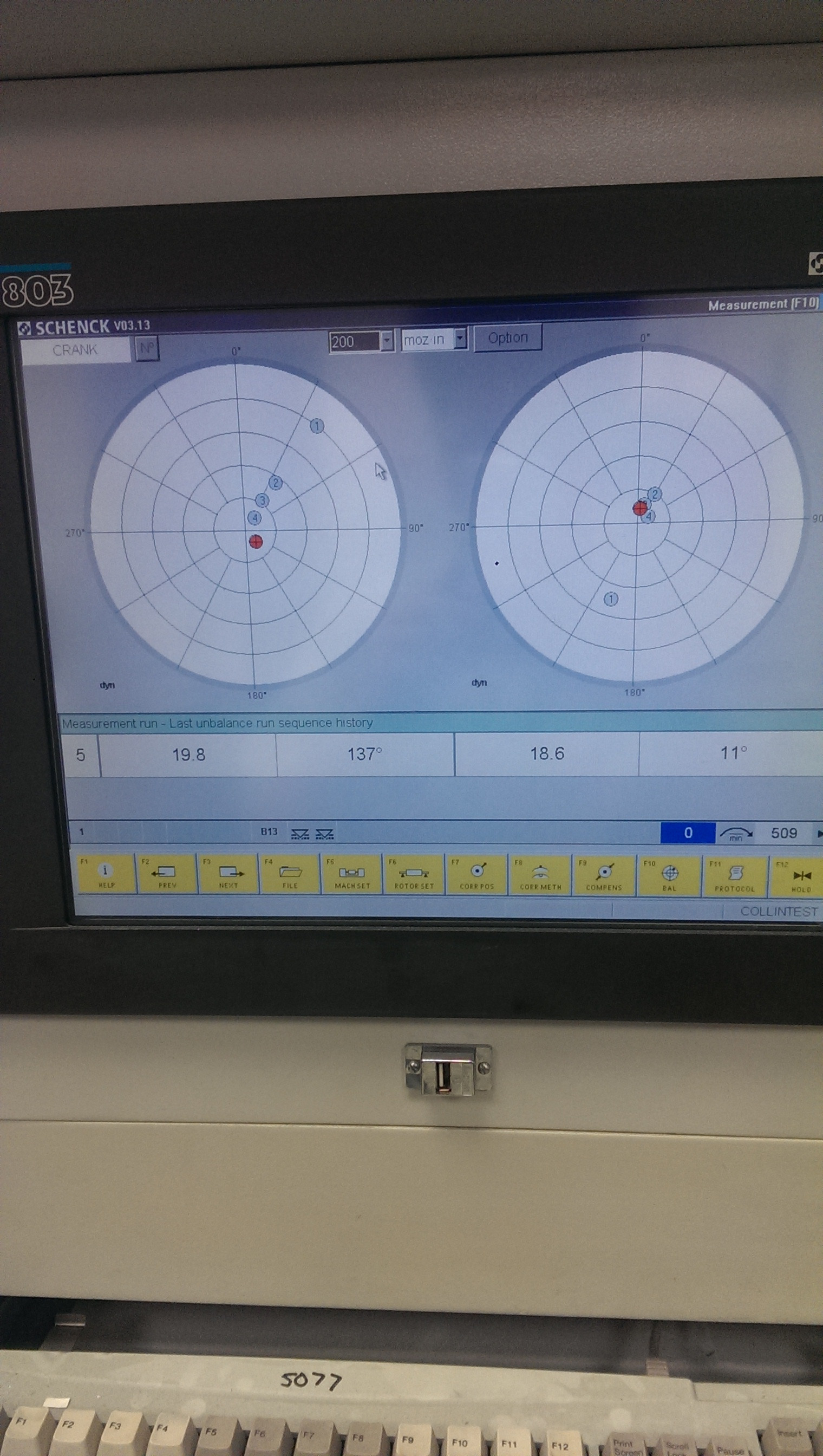

Balanced the crank last night. Was going to do the flywheel as well but I left the 30mm socket at home so I didn't have any way to get it on tight. Going to try and finish that off this week.
Here is the crank setup on the balancing machine:
Initial Unbalance in moz-in:
This ended up being about 3.2 and 5.9 grams of material to be removed from either plane.
I balanced to a tolerance of Grade 2.5 which was 20moz-in. This is the same tolerance we use for our impellers and it will definitely be fine for this. There is a certain point where you need to draw the line as far as time goes.

Thanks for the encouragement gents. I'm really fortunate to have a well equiped employer and the training to take advantage of it.

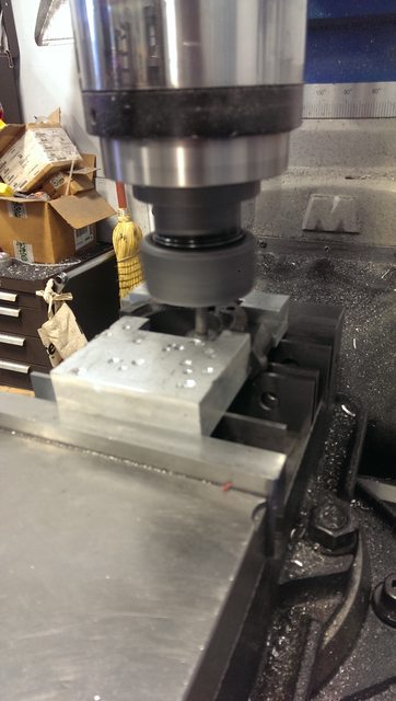

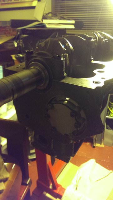

Modified the end caps last night. I ended up making some fixtures to a could use the vice as I was worried about the part moving with just a table clamp. Easiest way I found to set this up was to center the y axis at the edge of the cap and then touch off in X and go .080" deeper for the slot. Z can be setup based on the paralells.
Gearbox is rebuilt, diff shimed and happy.
Balance machine is open tonight I think so I'll get the flywheel and crank damper done up!

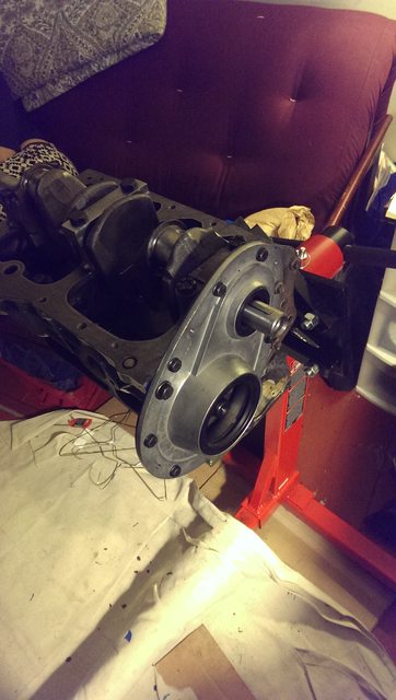

Oil pump, cam shaft and crank are all in:
I'm using a NOS trigger belt drive timing kit. It took some time to figure out the setup but I think I'm going to like it:
I did eventually get the timing cover on with the cam timed in using the DTI method but I don't have a pick at the moment. I got 3 out of 4 pistons in but I messed one up putting it on the rod. Getting the order from Mini Spares has been a nightmare but it finally showed up yesterday.

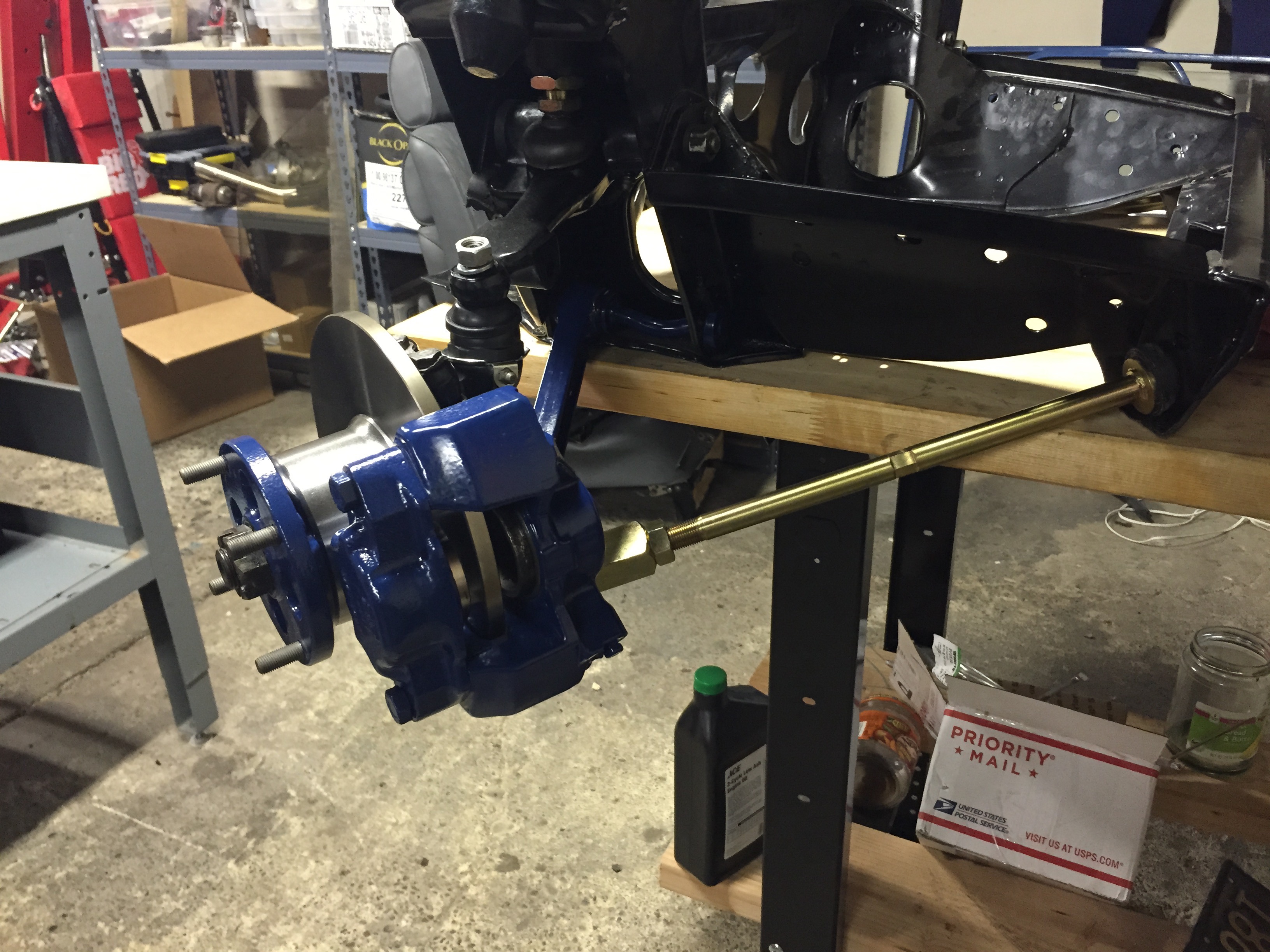

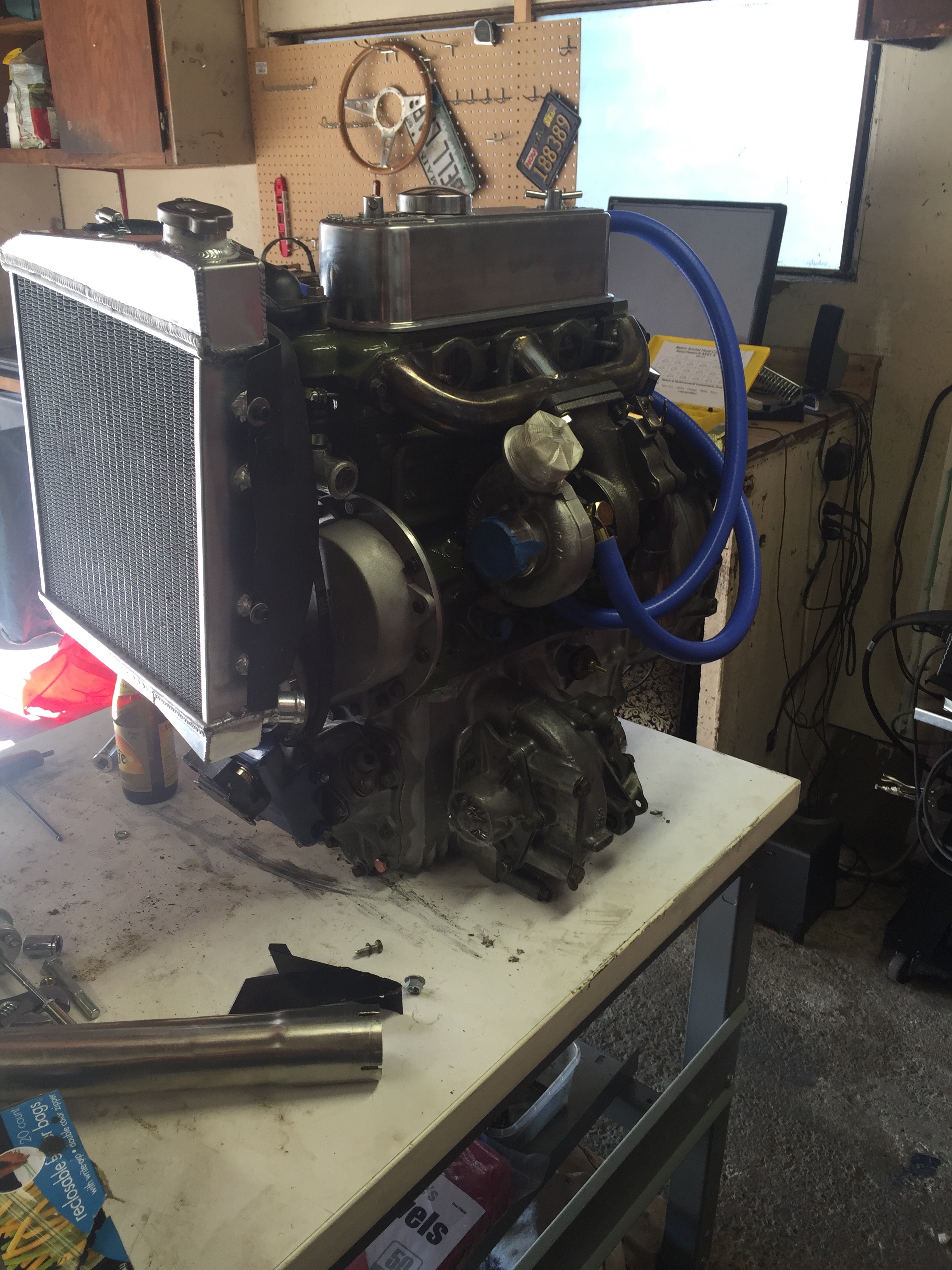

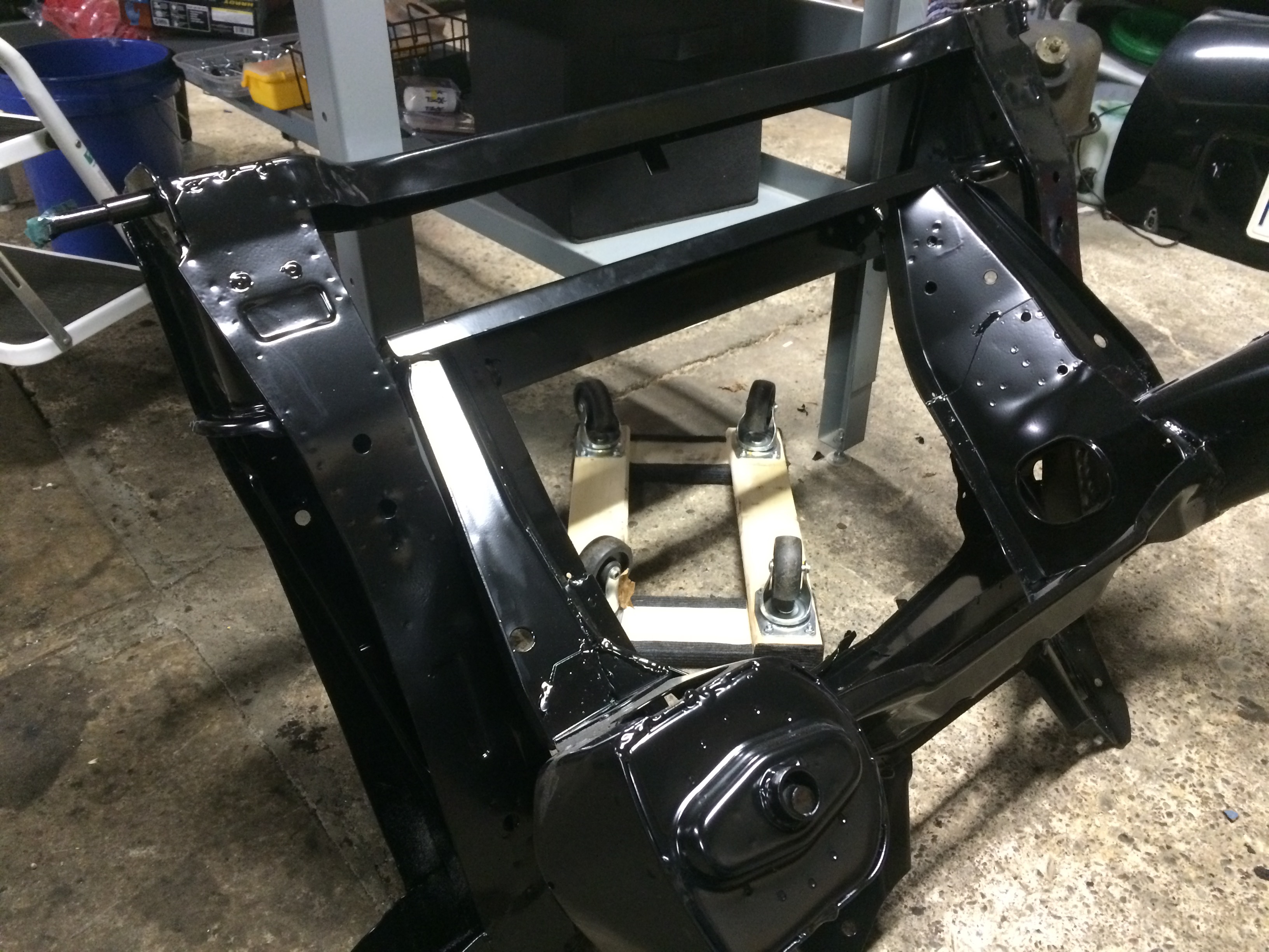

While the car has been gone to the body shop, I've been plugging away at the subframes and the engine. Lately I've been working hard on all of the little tasks that I'd been avoiding. These are the things that I assume will take a few minutes and end up taking a couple hours.
Engine is nearly together, and the front and rear subframes are built up. When the body shows up I'll be ready to bolt the frames up and have a roller. Then I'll figure out the interior.
My plan is to get the engine build up and running on the subframe before dropping the body over it. to make sure there aren't any crazy issues. Will I be able to drop the body over the front subframe with the plenum attached or will I need to take off some of the intake?
Some photo updates:

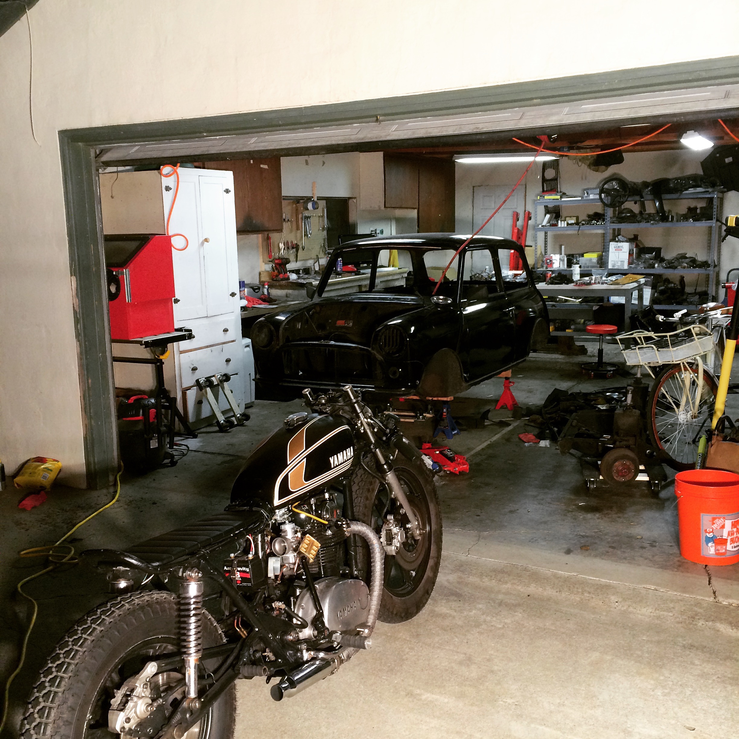

Black roller shell in the garage getting stripped for the body shop. Also, another one of my toys *happy*
Powder coating is a lot cheaper than I expected so I had a lot done!
Front subframe, built up
Engine built up

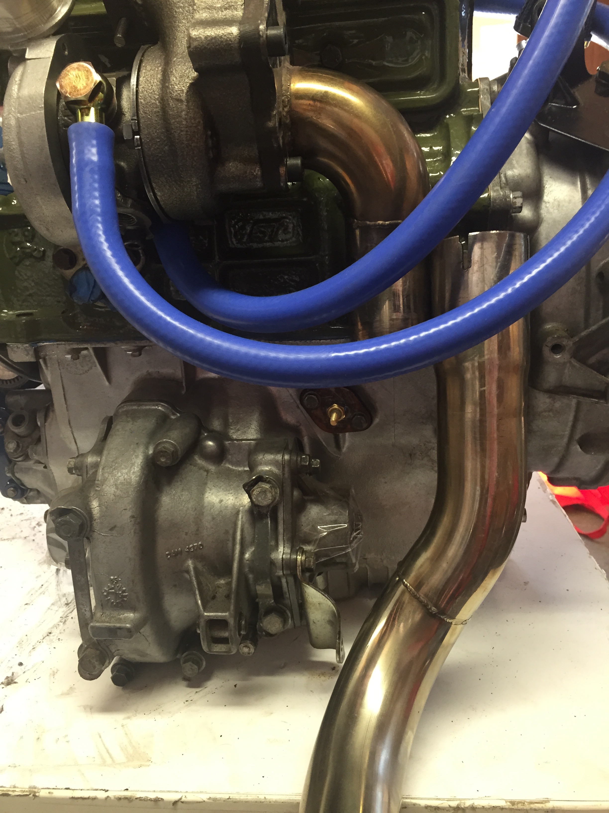

I can't get the exhaust to fit without hitting the gearbox steady mount. Is this normal? Should I run it without the mounts?
